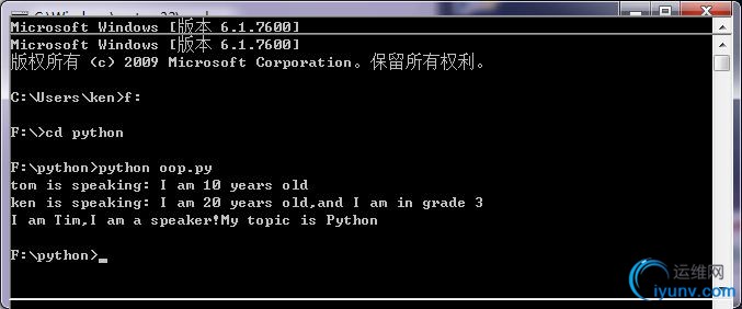

#类定义class people:#定义基本属性name = ''age = 0#定义私有属性,私有属性在类外部无法直接进行访问__weight = 0#定义构造方法def __init__(self,n,a,w):self.name = nself.age = aself.__weight = wdef speak(self):print("%s is speaking: I am %d years old" %(self.name,self.age))p = people('tom',10,30)p.speak()

#单继承示例class student(people):grade = ''def __init__(self,n,a,w,g):#调用父类的构函people.__init__(self,n,a,w)self.grade = g#覆写父类的方法def speak(self):print("%s is speaking: I am %d years old,and I am in grade %d"%(self.name,self.age,self.grade))s = student('ken',20,60,3)s.speak()

#另一个类,多重继承之前的准备class speaker():topic = ''name = ''def __init__(self,n,t):self.name = nself.topic = tdef speak(self):print("I am %s,I am a speaker!My topic is %s"%(self.name,self.topic))#多重继承class sample(speaker,student):a =''def __init__(self,n,a,w,g,t):student.__init__(self,n,a,w,g)speaker.__init__(self,n,t)test = sample("Tim",25,80,4,"Python")test.speak()#方法名同,默认调用的是在括号中排前地父类的方法

以上三段程序的执行结果:
