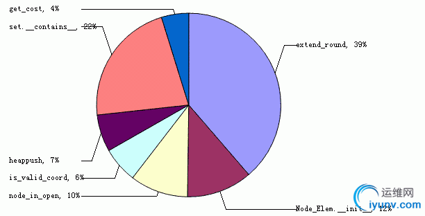

常恨春归无觅处
从“输出<chmetcnv w:st="on" unitname="”" sourcevalue="5" hasspace="False" negative="False" numbertype="1" tcsc="0"><span lang="EN-US"><font face="Times New Roman">5</font></span><span style="FONT-FAMILY: 宋体; mso-ascii-font-family: 'Times New Roman'; mso-hansi-font-family: 'Times New Roman'">”</span></chmetcnv>可以看出现在的热点是extend_round(),我们马上可以动手吗?不,extend_round比刚才优化掉的node_in_close()/get_best()之类的函数复杂太多了:循环中又分支,分支中还有分支,调用了近十个函数,而且从“输出<chmetcnv w:st="on" unitname="”" sourcevalue="5" hasspace="False" negative="False" numbertype="1" tcsc="0"><span lang="EN-US"><font face="Times New Roman">5</font></span><span style="FONT-FAMILY: 宋体; mso-ascii-font-family: 'Times New Roman'; mso-hansi-font-family: 'Times New Roman'">”</span></chmetcnv>可以得出extend_round()运行的时间大部分被它调用的外部函数占用了,真是错踪复杂。要想从一个这么复杂的函数中找出真正的热点,我们可以借助pstats.Stats.print_callees()函数输出extend_round()函数调用,在代码中增加:
p.print_callees("extend_round")
运行可以得到如下输出:
Ordered by: internal time
List reduced from 35 to 1 due to restriction <'extend_round'>
Function called...
astar.py:120(extend_round) astar.py:48(__init__)(5713) 0.053
astar.py:149(get_cost)(5713) 0.021
astar.py:157(node_in_open)(2933) 0.047
astar.py:163(is_valid_coord)(6224) 0.029
heapq.py:131(heappush)(846) 0.030
sets.py:292(__contains__)(5713) 0.101
输出6
这样看起来仍然不够明朗,我们可以借助MS Excel构造一个图表,如下:
<shapetype id="_x0000_t75" coordsize="21600,21600" o:spt="75" o:preferrelative="t" path="m@4@5l@4@11@9@11@9@5xe" filled="f" stroked="f"><stroke joinstyle="miter"></stroke><formulas><f eqn="if lineDrawn pixelLineWidth 0"></f><f eqn="sum @0 1 0"></f><f eqn="sum 0 0 @1"></f><f eqn="prod @2 1 2"></f><f eqn="prod @3 21600 pixelWidth"></f><f eqn="prod @3 21600 pixelHeight"></f><f eqn="sum @0 0 1"></f><f eqn="prod @6 1 2"></f><f eqn="prod @7 21600 pixelWidth"></f><f eqn="sum @8 21600 0"></f><f eqn="prod @7 21600 pixelHeight"></f><f eqn="sum @10 21600 0"></f></formulas><path o:extrusionok="f" gradientshapeok="t" o:connecttype="rect"></path><lock v:ext="edit" aspectratio="t"></lock></shapetype><shape id="_x0000_i1025" style="WIDTH: 414.75pt; HEIGHT: 213pt; mso-wrap-style: square; mso-position-horizontal-relative: page; mso-position-vertical-relative: page; mso-wrap-distance-left: 9.05pt; mso-wrap-distance-right: 9.05pt" type="#_x0000_t75" o:ole=""><fill o:detectmouseclick="t"></fill><imagedata src="file:///C:%5CDOCUME~1%5Cowner%5CLOCALS~1%5CTemp%5Cmsohtml1%5C03%5Cclip_image001.wmz" o:title=""></imagedata><lock v:ext="edit" aspectratio="f"></lock></shape>
图1
一图胜过千言,我们从图1可以看出extend_round调用的函数占总时间的三分之二左右,所以减少函数调用是我们的重点,但extend_round本身也占用了38%的运行时间,更合理地重新组织extend_round的代码是有必要的。下面我们就随着extend_round的源码来分析修正:
