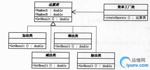

  一、简略工厂模式
  模式特色:工厂根据条件发生不同功能的类。
  序程实例:四则运算计算器,根据用户的输入发生响应的运算类,用这个运算类处置体具的运算。
  代码特色:C/C++中的switch...case...分支用使字典的方法取代。
  用使异常机制对除数为0的情况停止处置。
DSC0001.gif DSC0002.gif 简略工厂模式
class Operation:
def GetResult(self):
pass
class OperationAdd(Operation):
return self.op1+self.op2
class OperationSub(Operation):
return self.op1-self.op2
class OperationMul(Operation):
return self.op1*self.op2
class OperationDiv(Operation):
try:
result
= self.op1/self.op2
return result
except:
print "error:divided by zero."
return 0
class OperationUndef(Operation):
print "Undefine operation."
return 0
class OperationFactory:
operation
operation[
"+"] = OperationAdd();
operation[
"-"] = OperationSub();
operation[
"*"] = OperationMul();
operation[
"/"] = OperationDiv();
def createOperation(self,ch):
if ch in self.operation:
op
= self.operation[ch]
else:
op
= OperationUndef()
return op
if __name__ == "__main__":
op
= raw_input("operator: ")
opa
= input("a: ")
opb
= input("b: ")
factory
= OperationFactory()
cal
= factory.createOperation(op)
cal.op1
= opa
cal.op2
= opb
print cal.GetResult()

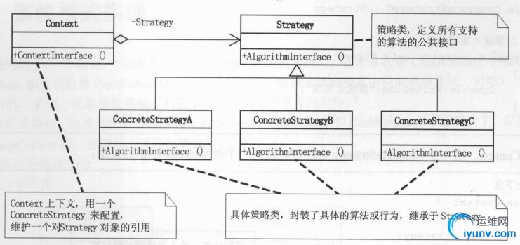

  二、策略模式
  模式特色:定义算法族家并且离分封装,它们之间可以互相换替而不影响客户端。
  序程实例:��收银件软,要需根据不同的销售策略方法停止收费
  代码特色:不同于同例1,这里用使字典是为了防止关键字不在字典致导bug的陷阱。
策略模式
class CashSuper:
def AcceptCash(self,money):
return 0
class CashNormal(CashSuper):
return money
class CashRebate(CashSuper):
discount
= 0
def __init__(self,ds):
self.discount
= ds
return money * self.discount
class CashReturn(CashSuper):
total
= 0;
ret
= 0;
def __init__(self,t,r):
self.total
= t
self.ret
= r
if (money>=self.total):
return money - self.ret
else:
return money
class CashContext:
def __init__(self,csuper):
self.cs
= csuper
def GetResult(self,money):
return self.cs.AcceptCash(money)
money
= input("money:")
strategy
strategy[
1] = CashContext(CashNormal())
strategy[
2] = CashContext(CashRebate(0.8))
strategy[
3] = CashContext(CashReturn(300,100))
ctype
= input("type:[1]for normal,[2]for 80% discount [3]for 300 -100.")
if ctype in strategy:
cc
= strategy[ctype]
else:
print "Undefine type.Use normal mode."
cc
= strategy[1]
print "you will pay:%d" %(cc.GetResult(money))

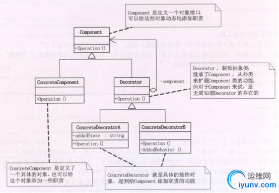

  三、装饰模式
  模式特色:动态地为对象加增额定的责职
  序程实例:示展一个人一件一件穿衣服的进程。
  代码特色:无
装饰模式
class Person:
def __init__(self,tname):
self.name
= tname
def Show(self):
print "dressed %s" %(self.name)
class Finery(Person):
componet
= None
def __init__(self):
pass
def Decorate(self,ct):
self.componet
= ct
def Show(self):
if(self.componet!=None):
self.componet.Show()
class TShirts(Finery):
def __init__(self):
pass
def Show(self):
print "Big T-shirt "
class BigTrouser(Finery):
def __init__(self):
pass
def Show(self):
print "Big Trouser "
p
= Person("somebody")
bt
= BigTrouser()
ts
= TShirts()
bt.Decorate(p)
ts.Decorate(bt)
ts.Show()

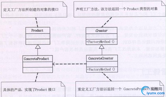

  五、工厂方法模式
  模式特色:定义一个于用创立对象的口接,让类子决议实例化个一哪类。这使得一个类的实例化迟延到其类子。
  序程实例:类基雷锋类,派生出生学类和志愿者类,由这两种类子成完“学雷锋”作工。类子的创立由雷锋工厂的对应的类子成完。
  代码特色:无
工厂方法模式
class LeiFeng:
def Sweep(self):
print "LeiFeng sweep"
class Student(LeiFeng):
def Sweep(self):
print "Student sweep"
class Volenter(LeiFeng):
def Sweep(self):
print "Volenter sweep"
class LeiFengFactory:
def CreateLeiFeng(self):
temp
= LeiFeng()
return temp
class StudentFactory(LeiFengFactory):
temp
= Student()
return temp
class VolenterFactory(LeiFengFactory):
temp
= Volenter()
return temp
sf
= StudentFactory()
s
=sf.CreateLeiFeng()
s.Sweep()
sdf
= VolenterFactory()
sd
=sdf.CreateLeiFeng()
sd.Sweep()

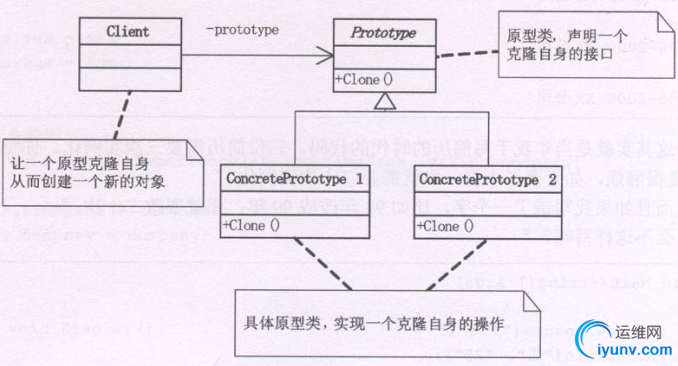

  六、原型模式
  模式特色:用原型实例指定创立对象的种类,并且通过拷贝这些原型创立新的对象。
  序程实例:从简历原型,成生新的简历
  代码特色:简历类Resume供提的Clone()方法其实是不并真正的Clone,只是为已存在对象加增了一次引用。
  Python为对象供提的copy模块中的copy方法和deepcopy方法经已现实了原型模式,但由于例子的层次较浅,两者看不出别区。
原型模式
import copy
class WorkExp:
place
year
=0
class Resume:
name
age
= 0
def __init__(self,n):
self.name
= n
def SetAge(self,a):
self.age
= a
def SetWorkExp(self,p,y):
self.place
= p
self.year
= y
def Display(self):
print self.age
print self.place
print self.year
def Clone(self):
#现实不是“克隆”,只是返回了自身
return self
a
= Resume("a")
b
= a.Clone()
c
= copy.copy(a)
d
= copy.deepcopy(a)
a.SetAge(
7)
b.SetAge(
12)
c.SetAge(
15)
d.SetAge(
18)
a.SetWorkExp(
"PrimarySchool",1996)
b.SetWorkExp(
"MidSchool",2001)
c.SetWorkExp(
"HighSchool",2004)
d.SetWorkExp(
"University",2007)
a.Display()
b.Display()
c.Display()
d.Display()

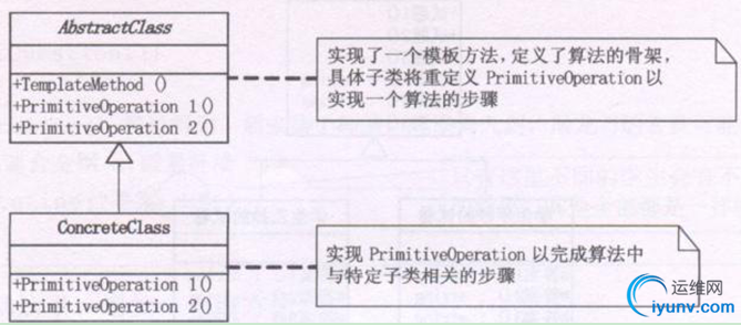

  七、模板方法模式
  模式特色:定义一个操纵中的算法骨架,将一些骤步迟延至类子中。
  序程实例:考试时用使同一种考卷(类父),不同生学上交自己填写的试卷(类子方法的现实)
  代码特色:无
模板方法模式
class TestPaper:
def TestQuestion1(self):
print "Test1:A. B. C. D."
print "(%s)" %self.Answer1()
def TestQuestion2(self):
print "(%s)" %self.Answer2()
def Answer1(self):
return ""
def Answer2(self):
return ""
class TestPaperA(TestPaper):
def Answer1(self):
return "B"
def Answer2(self):
return "C";
class TestPaperB(TestPaper):
def Answer1(self):
return "D"
def Answer2(self):
return "D";
s1
= TestPaperA()
s2
= TestPaperB()
print "student 1"
s1.TestQuestion1()
s1.TestQuestion2()
print "student 2"
s2.TestQuestion1()
s2.TestQuestion2()

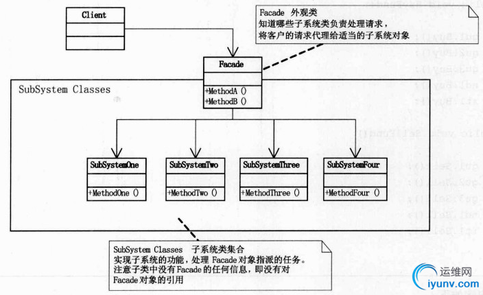

  八、外观模式
  模式特色:为一组调用供提致一的口接。
  序程实例:口接将几种调用离分合组成为两组,用户通过口接调用其中的一组。
  代码特色:无
外观模式
class SubSystemOne:
def MethodOne(self):
print "SubSysOne"
class SubSystemTwo:
def MethodTwo(self):
print "SubSysTwo"
class SubSystemThree:
def MethodThree(self):
print "SubSysThree"
class SubSystemFour:
def MethodFour(self):
print "SubSysFour"
class Facade:
def __init__(self):
self.one
= SubSystemOne()
self.two
= SubSystemTwo()
self.three
= SubSystemThree()
self.four
= SubSystemFour()
def MethodA(self):
print "MethodA"
self.one.MethodOne()
self.two.MethodTwo()
self.four.MethodFour()
def MethodB(self):
print "MethodB"
self.three.MethodThree()
facade
= Facade()
facade.MethodA()
facade.MethodB()

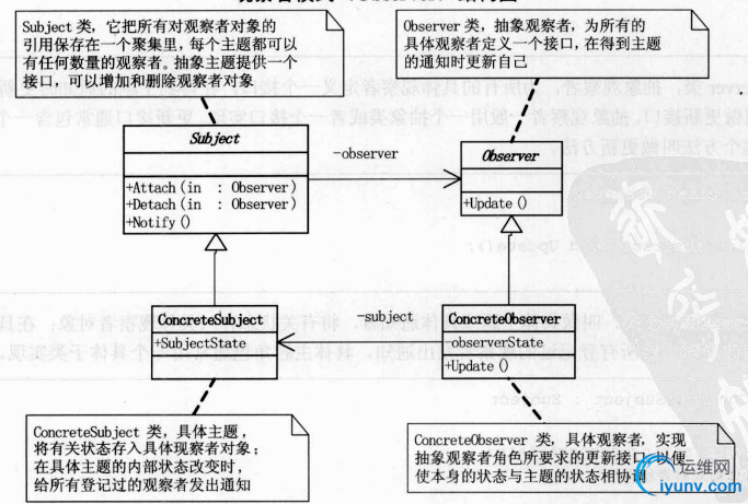

  十、察观者模式
  模式特色:定义了一种一对多的关系,让多个察观对象同时监听一个主题对象,当主题对象状态发生变化时会通知有所察观者。
  序程实例:公司里有两种下班时趁老板不在时偷懒的员工:看NBA的和看股票行情的,并且事先让老板秘书当老板出现时通知他们续继做手头上的作工。
  序程特色:无
察观者模式
class Observer:
def __init__(self,strname,strsub):
self.name
= strname
self.sub
= strsub
def Update(self):
pass
class StockObserver(Observer):
#no need to rewrite __init__()
def Update(self):
print "%s:%s,stop watching Stock and go on work!" %(self.name,self.sub.action)
class NBAObserver(Observer):
def Update(self):
print "%s:%s,stop watching NBA and go on work!" %(self.name,self.sub.action)
class SecretaryBase:
def __init__(self):
self.observers
def Attach(self,new_observer):
pass
def Notify(self):
pass
class Secretary(SecretaryBase):
self.observers.append(new_observer)
def Notify(self):
for p in self.observers:
p.Update()
p
= Secretary()
s1
= StockObserver("xh",p)
s2
= NBAObserver("wyt",p)
p.Attach(s1);
p.Attach(s2);
p.action
= "WARNING:BOSS ";
p.Notify()

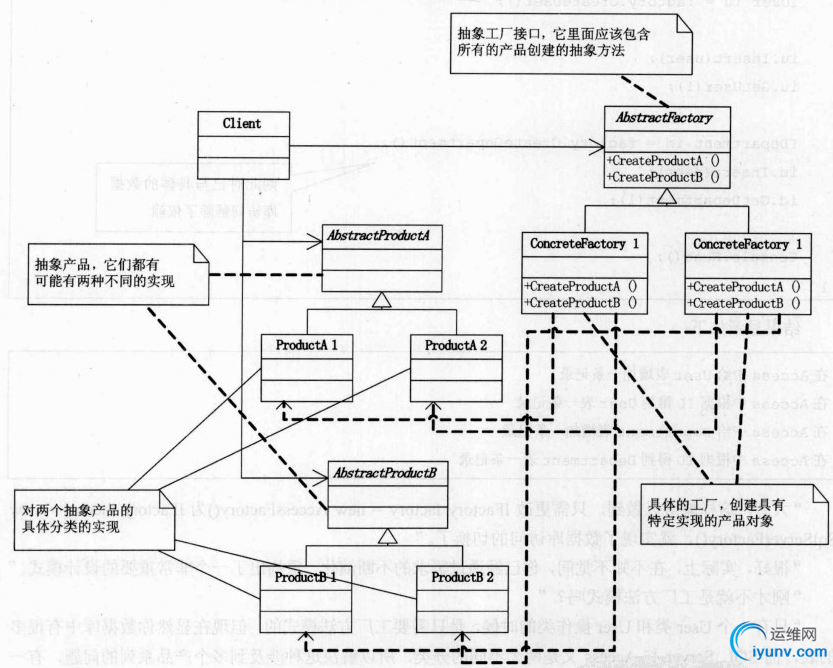

  十一、抽象工厂模式
  模式特色:供提一个创立一系列相关或互相依赖对象的口接,而无需指定它们的类。
  序程实例:供提对不同的数据库问访的支持。
  IUser和IDepartment是两种不同的抽象产品,它们都有Access和SQL Server这两种不同的现实;IFactory是发生IUser和IDepartment的抽象工厂,根据体具现实(AccessFactory和SqlFactory)发生对应的体具的对象(CAccessUser与CAccessDepartment,或者CSqlUser与CSqlDepartment)。
  代码特色:无
抽象工厂模式
class IUser:
def GetUser(self):
pass
def InsertUser(self):
pass
class IDepartment:
def GetDepartment(self):
pass
def InsertDepartment(self):
pass
class CAccessUser(IUser):
def GetUser(self):
print "Access GetUser"
print "Access InsertUser"
class CAccessDepartment(IDepartment):
print "Access GetDepartment"
print "Access InsertDepartment"
class CSqlUser(IUser):
def GetUser(self):
print "Sql GetUser"
print "Sql InsertUser"

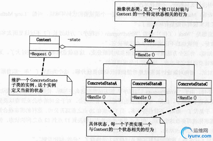

  十二、状态模式
  模式特色:当一个对象的内在状态改变时允许改变其行为,这个对象看起来像是改变了其类。
  序程实例:描述一个序程员的作工状态,当要需改变状态时发生改变,不同状态下的方法现实不同
  代码特色:无
状态模式
class State:
def WirteProgram(self):
pass
class Work:
def __init__(self):
self.hour
= 9
self.current
= ForenoonState()
def SetState(self,temp):
self.current
= temp
def WriteProgram(self):
self.current.WriteProgram(self)
class NoonState(State):
def WriteProgram(self,w):
print "noon working"
if (w.hour<13):
print "fun."
else:
print "need to rest."
class ForenoonState(State):
if (w.hour<12):
print "morning working"
print "energetic"
else:
w.SetState(NoonState())
w.WriteProgram()
mywork
= Work()
mywork.hour
= 9
mywork.WriteProgram()
mywork.hour
=14

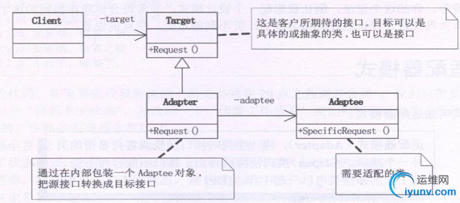

  十三、适配器模式
  模式特色:将一个类的口接转换成为客户希望的另外一个口接。
  序程实例:用户通过适配器用使一个类的方法。
  代码特色:无
    每日一道理
心的本色该是如此。成,如朗月照花,深潭微澜,不论顺逆,不论成败的超然,是扬鞭策马,登高临远的驿站;败,仍滴水穿石,汇流入海,有穷且益坚,不坠青云的傲岸,有“将相本无主,男儿当自强”的倔强。荣,江山依旧,风采犹然,恰沧海巫山,熟视岁月如流,浮华万千,不屑过眼烟云;辱,胯下韩信,雪底苍松,宛若羽化之仙,知退一步,海阔天空,不肯因噎废食。
适配器模式
class Target:
def Request():
print "common request."
class Adaptee(Target):
def SpecificRequest(self):
print "specific request."
class Adapter(Target):
def __init__(self,ada):
self.adaptee
= ada
def Request(self):
self.adaptee.SpecificRequest()
adaptee
= Adaptee()
adapter
= Adapter(adaptee)
adapter.Request()

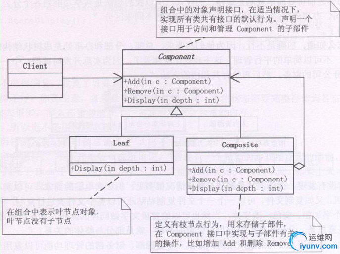

  十五、合组模式
  模式特色:将对象合组成成树形结构以示表“部份-整体”的层次结构
  序程实例:公司人员的组织结构
  代码特色:无
合组模式
class Component:
def __init__(self,strName):
self.m_strName
= strName
def Add(self,com):
pass
def Display(self,nDepth):
pass
class Leaf(Component):
def Add(self,com):
print "leaf can't add"
strtemp
for i in range(nDepth):
strtemp
=strtemp+"-"
strtemp
=strtemp+self.m_strName
print strtemp
class Composite(Component):
self.m_strName
= strName
self.c
def Add(self,com):
self.c.append(com)
strtemp
strtemp
=strtemp+"-"
strtemp
print strtemp
for com in self.c:
com.Display(nDepth
+2)
p
= Composite("Wong")
p.Add(Leaf(
"Lee"))
p.Add(Leaf(
"Zhao"))
p1
= Composite("Wu")
p1.Add(Leaf(
"San"))
p.Add(p1)
p.Display(
1);

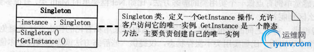

  十七、单例模式
  模式特色:保证类仅有一个实例,并供提一个问访它的全局问访点。
  说明:     为了现实单例模式费了不少工夫,后来查到一篇博文对此有很详细的介绍,而且现实方法也很丰富,通过对代码的学习可以解了更多Python的用法。以下的代码出自GhostFromHeaven的专栏,地址:http://blog.csdn.net/ghostfromheaven/article/details/7671853。不过正如其作者在Python单例模式终极版所说:
  我要问的是,Python真的要需单例模式吗?我指像其他编程语言中的单例模式。
  答案是:不要需!
  因为,Python有模块(module),最pythonic的单例典范。
  模块在在一个应用序程中只有一份,它本身就是单例的,将你所要需的属性和方法,直接暴露在模块中变成模块的全局变量和方法即可!
单例模式(四种方法)

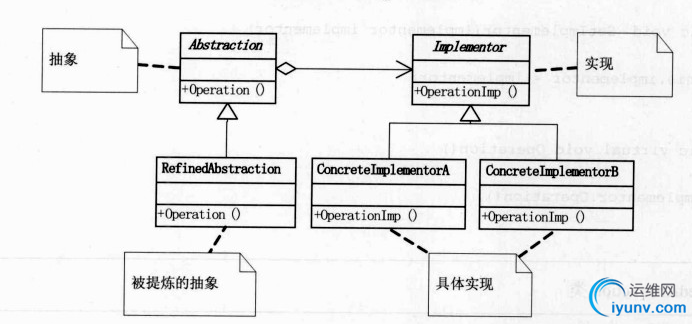

  十八、桥接模式
  模式特色:将抽象部份与它的现实部份离分,使它们都可以独立地变化。
  序程实例:两种品牌的手机,要求它们都可以运行游戏和通讯录两个件软,而不是为个每品牌的手机都独立编写不同的件软。
  代码特色:虽然用使了object的新型类,不过在这里不是必须的,是对在Python2.2之后“尽量用使新型类”的建议的遵从示范。
桥接模式
class HandsetSoft(object):
def Run(self):
pass
class HandsetGame(HandsetSoft):
def Run(self):
print "Game"
class HandsetAddressList(HandsetSoft):
def Run(self):
print "Address List"
class HandsetBrand(object):
def __init__(self):
self.m_soft
= None
def SetHandsetSoft(self,temp):
self.m_soft
= temp
def Run(self):
pass
class HandsetBrandM(HandsetBrand):
def Run(self):
if not (self.m_soft == None):
print "BrandM"
self.m_soft.Run()
class HandsetBrandN(HandsetBrand):
def Run(self):
print "BrandN"
self.m_soft.Run()
brand
= HandsetBrandM()
brand.SetHandsetSoft(HandsetGame())
brand.Run()
brand.SetHandsetSoft(HandsetAddressList())
brand.Run()

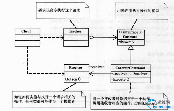

  十九、命令模式
  模式特色:将请求封装成对象,从而使可用不同的请求对客户停止参数化;对请求排队或记录请求日志,以及支持可撤消的操纵。
  序程实例:烧烤店有两种食物,羊肉串和鸡翅。客户向服务员点单,服务员将点好的单告诉大厨,由大厨停止烹饪。
  代码特色:注意在遍历列表时不要用注释的方法删除,否则会出现bug。bug示例序程附在后面,我认为这是因为remove打乱了for迭代查询列表的顺序致导的。
命令模式
class Barbucer:
def MakeMutton(self):
print "Mutton"
def MakeChickenWing(self):
print "Chicken Wing"
class Command:
def __init__(self,temp):
self.receiver
=temp
def ExecuteCmd(self):
pass
class BakeMuttonCmd(Command):
self.receiver.MakeMutton()
class ChickenWingCmd(Command):
self.receiver.MakeChickenWing()
class Waiter:
def __init__(self):
self.order
def SetCmd(self,command):
self.order.append(command)
print "Add Order"
def Notify(self):
for cmd in self.order:
#self.order.remove(cmd)
#lead to a bug
            cmd.ExecuteCmd()
barbucer
=Barbucer()
cmd
=BakeMuttonCmd(barbucer)
cmd2
=ChickenWingCmd(barbucer)
girl
=Waiter()
girl.SetCmd(cmd)
girl.SetCmd(cmd2)
girl.Notify()
  在for中remove会致导bug的示展代码:
bug
c=[0,1,2,3]
for i in c:
print i
c.remove(i)
#output:
0

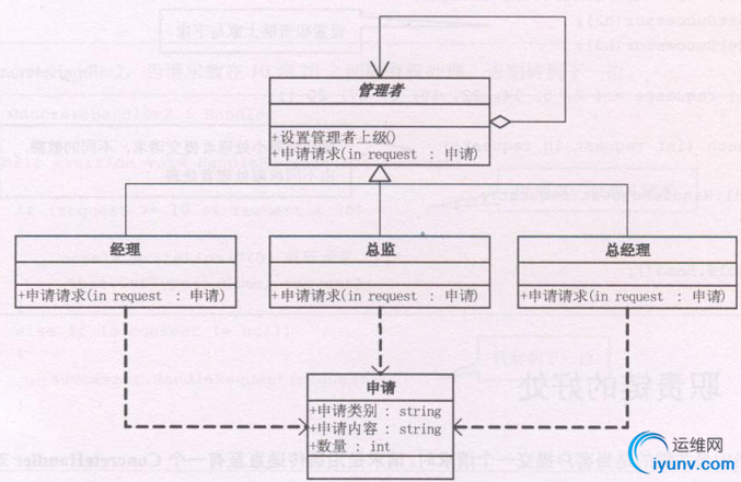

  二十、责职链模式
  模式特色:使多个对象都有机会处置请求,从而防止发送者和接收者的耦合关系。将对象连成链并沿着这条链传递请求直到被处置。
  序程实例:请假和加薪等请求发给上级,如果上级无权决议,那么递交给上级的上级。
  代码特色:无
责职链模式
class Request:
def __init__(self,tcontent,tnum):
self.content
= tcontent
self.num
= tnum
class Manager:
self.name
= temp
def SetSuccessor(self,temp):
self.manager
= temp
def GetRequest(self,req):
pass
class CommonManager(Manager):
if(req.num>=0 and req.num<10):
print "%s handled %d request." %(self.name,req.num)
else:
self.manager.GetRequest(req)
class MajorDomo(Manager):
if(req.num>=10):
common
= CommonManager("Zhang")
major
= MajorDomo("Lee")
common.SetSuccessor(major)
req
= Request("rest",33)
common.GetRequest(req)
req2
= Request("salary",3)
common.GetRequest(req2)

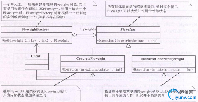

  二十二、享元模式
  模式特色:运用共享技巧有效地支持大量细粒度的对象。
  序程实例:一个网站工厂,根据用户请求的类别返回响应类别的网站。如果这种类别的网站经已在服务器上,那么返回这种网站并加上不同用户的独特的数据;如果没有,那么成生一个。
  代码特色:为了示展每种网站的由用户请求的次数,这里为它们建立了一个引用次数的字典。
  之所以不用Python的sys模块中的sys.getrefcount()方法统计引用计数是因为有的对象可能在别处被隐式的引用,从而加增了引用计数。
享元模式
import sys
class WebSite:
def Use(self):
pass
class ConcreteWebSite(WebSite):
self.name
= strName
def Use(self,user):
print "Website type:%s,user:%s" %(self.name,user)
class UnShareWebSite(WebSite):
self.name
= strName
def Use(self,user):
print "UnShare Website type:%s,user:%s" %(self.name, user)
class WebFactory:
def __init__(self):
test
= ConcreteWebSite("test")
self.webtype
={"test":test}
self.count
= {"test":0}
def GetWeb(self,webtype):
if webtype not in self.webtype:
temp
= ConcreteWebSite(webtype)
self.webtype[webtype]
= temp
self.count[webtype]
=1
else:
temp
= self.webtype[webtype]
self.count[webtype]
= self.count[webtype]+1
return temp
def GetCount(self):
for key in self.webtype:
#print "type: %s, count:%d" %(key,sys.getrefcount(self.webtype[key]))
print "type: %s, count:%d " %(key,self.count[key])
f
= WebFactory()
ws
=f.GetWeb("blog")
ws.Use(
"Lee")
ws2
=f.GetWeb("show")
ws2.Use(
"Jack")
ws3
=f.GetWeb("blog")
ws3.Use(
"Chen")
ws4
=UnShareWebSite("TEST")
ws4.Use(
"Mr.Q")
print f.webtype
f.GetCount()

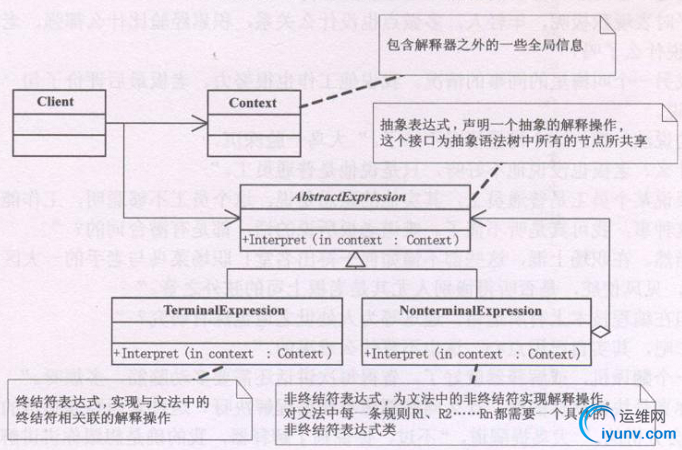

  二十三、解释器模式
  模式特色:给定一个语言,定义它的文法的一种示表,并定义一个解释器,这个解释器用使该示表来解释语言中的句子。
  序程实例:(只是模式特色的最简略示范)
  代码特色:无
解释器模式
class Context:
def __init__(self):
self.input
self.output
class AbstractExpression:
def Interpret(self,context):
pass
class Expression(AbstractExpression):
print "terminal interpret"
class NonterminalExpression(AbstractExpression):
