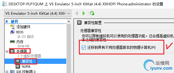

  步骤如下:
  • If the emulator is open, close it down
  • Start Microsoft Hyper-V Manager
  • Select the Virtual Emulator you are trying to work with
  • In the Actions Menu select settings
  • Expand processor under Hardware options
  • Select Compatibility
  • Make sure the checkbox is selected on “Migrate to a physical computer with a different processor version”
  • Click “Ok” and close down Hyper-V Manager
  • Try to debug again, you should be successful

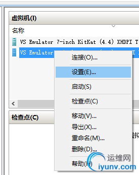

  开启Hyper-V管理器,在Win10上我不知道哪里找, 可以Ctrl+R  运行输入:【%windir%\System32\mmc.exe "%windir%\System32\virtmgmt.msc"】运行设置,也可以直接用创建此命令的快捷方式,以后直接打开就行了。
  如果虚拟机正在打开,请先关闭虚拟机
  其他步骤如下:
  设置后再重新打开模拟器,现在可以真正调试了!
