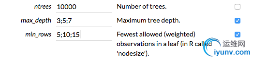

Selecting Hyperparameters Manually and With Cartesian Grid
  The traditional method of selecting the values for your hyperparameters has been to individually train a number of models with different combinations of values, and then to compare the model performance to choose the best model. For example, for a tree-based model you might choose ntrees of (50, 100 and 200) and max_depth of (5, 10, 15 and 20) for a total of 3 x 4 = 12 models. This process of trying out hyperparameter sets by hand is called manual search. By looking at the models’ predictive performance, as measured by test-set, cross-validation or validation metrics, you select the best hyperparameter settings for your data and needs.
  As the number of hyperparameters and the lists of desired values increase this obviously becomes quite tedious and difficult to manage.

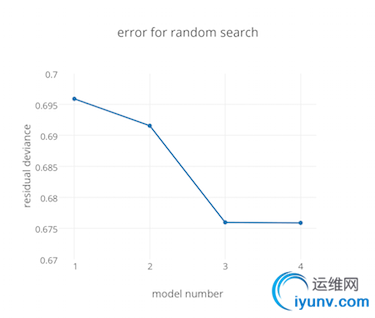

Searching Large Hyperparameter Spaces
  As the number of hyperparameters being tuned increases, and the values that you would like to explore for those hyperparameters increases, you obviously get a combinatorial explosion in the number of models required for an exhaustive search. Since we always have time constraints on the model tuning process the obvious thing to do is to narrow down our choices by doing a coarser search of the space. Given a fixed amount of time, making random choices of hyperparameter values generally gives results that are better than the best results of an Cartesian (exhaustive) search.
  Bergstra and Bengio write on p. 281:
  Compared with neural networks configured by a pure grid search,
we find that random search over the same domain is able to find models that are as good or better within a small fraction of the computation time.
Granting random search the same computational budget, random search finds better models by effectively searching a larger, less promising configuration
space.
  [F]or most data sets only a few of the hyper-parameters really matter,
but … different hyper-parameters are important on different data sets. This phenomenon makes grid search a poor choice for configuring algorithms for new data sets.
  We propose random search as a substitute and baseline that is both reasonably efficient (roughly equivalent to or better than combinining manual search and grid search, in our experiments) and keeping the advantages of implementation simplicity and reproducibility of pure grid search.
  [R]andom search … trades a small reduction in efficiency in low-dimensional spaces for a large improvement in efficiency in high-dimensional search spaces.
  After doing a random search, if desired you can then iterate by “zooming in” on the regions of the hyperparameter space which look promising. You can do this by running additional, more targeted, random or Cartesian hyperparameter searches or manual searches. For example, if you started with alpha values of [0.0, 0.25, 0.5, 0.75, 1.0] and the middle values look promising, you can follow up with a finer grid of [0.3, 0.4, 0.5, 0.6, 0.7].

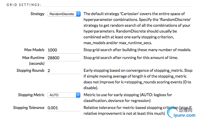

Random Hyperparameter Search in H2O
  H2O has supported random hyperparameter search since version 3.8.1.1. To use it, specify a grid search as you would with a Cartesian search, but add search criteria parameters to control the type and extent of the search. You can specify a max runtime for the grid, a max number of models to build, or metric-based automatic early stopping. If you choose several of these then H2O will stop when the first of the criteria are met. As an example, you might specify “stop when MSE has improved over the moving average of the best 5 models by less than 0.0001, but take no more than 12 hours”.
  H2O will choose a random set of hyperparameter values from the ones that you specify, without repeats, and build the models sequentially. You can look at the incremental results while the models are being built by fetching the grid with the h2o.getGrid (R) or h2o.get_grid(Python) functions. There’s also a getGrids command in Flow that will allow you to click on any of the grids you’ve built. H2O’s Flow UI will soon plot the error metric as the grid is being built to make the progress easy to visualize, something like this:
Choosing Search Criteria
  In general, metric-based early stopping optionally combined with max runtime is the best choice. The number of models it will take to converge toward a global best can vary a lot (see below), and metric-based early stopping accounts for this automatically by stopping the search process when the error curve (learning curve[3]) flattens out.
  The number of models required for convergence depends on a number of things, but mostly on the “shape” of the error function in the hyperparameter space [Bergstra and Bengio p. 291]. While most algorithms perform well in a fairly large region of the hyperparameter space on most datasets, some combinations of dataset and algorithm are very sensitive: they have a very “peaked” error functions. In tuning neural networks with a large numbers of hyperparameters and various datasets Bergstra and Bengio find convergence within 2-64 trials (models built), depending largely on which hyperparameters they choose to tune. In some classes of search they reach convergence in 4-8 trials, even with a very large search space:
  Random experiment efficiency curves of a single-layer neural network for eight of the data sets used in Larochelle et al. (2007) … (7 hyper-parameters to optimize). … Random searches of 8 trials match or outperform grid searches of (on average) 100 trials.
  Simpler algorithms such as GBM and GLM should require few trials to get close to a global minimum.
