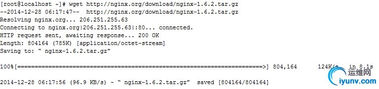

            wget http://nginx.org/download/nginx-1.6.2.tar.gz                     wKioL1SgwLmwPVbxAAGgnCTUqWo101.jpg

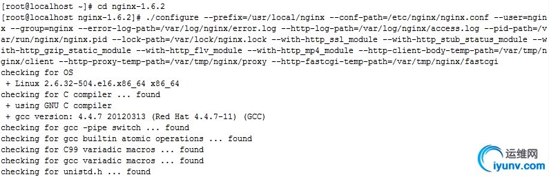

./configure --prefix=/usr/local/nginx --conf-path=/etc/nginx/nginx.conf --user=nginx --group=nginx --error-log-path=/var/log/nginx/error.log --http-log-path=/var/log/nginx/access.log --pid-path=/var/run/nginx/nginx.pid --lock-path=/var/lock/nginx.lock --with-http_ssl_module --with-http_stub_status_module --with-http_gzip_static_module --with-http_flv_module --with-http_mp4_module --http-client-body-temp-path=/var/tmp/nginx/client --http-proxy-temp-path=/var/tmp/nginx/proxy --http-fastcgi-temp-path=/var/tmp/nginx/fastcgi wKiom1SgwAryM2dDAALlHeDjPcs961.jpg

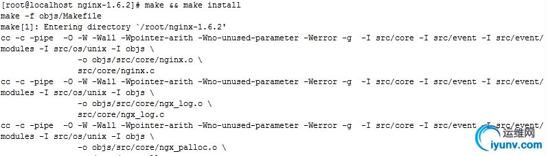

    3.安装 make && make install

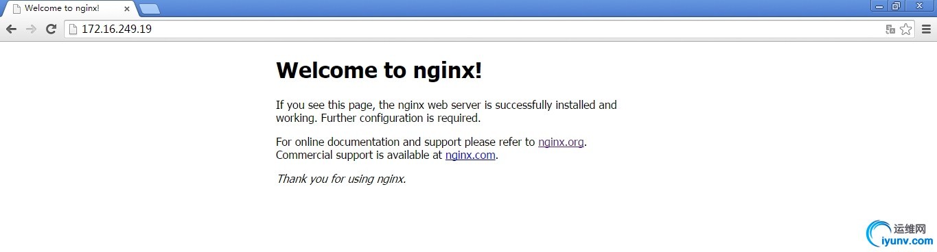

    6.测试访问

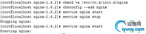

  3.添加执行权限并使用服务脚本启动服务
        chmod +x /etc/rc.d/init.d/nginx
        chkconfig --add nginx
        service nginx start
