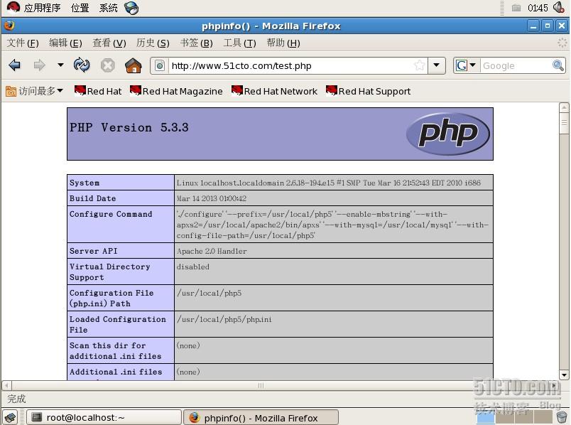

5、安装完成 测试PHP与Apache的协同工作
[iyunv@localhost php-5.3.3]# vim /usr/local/apache2/htdocs/test.php
<?php
phpinfo();

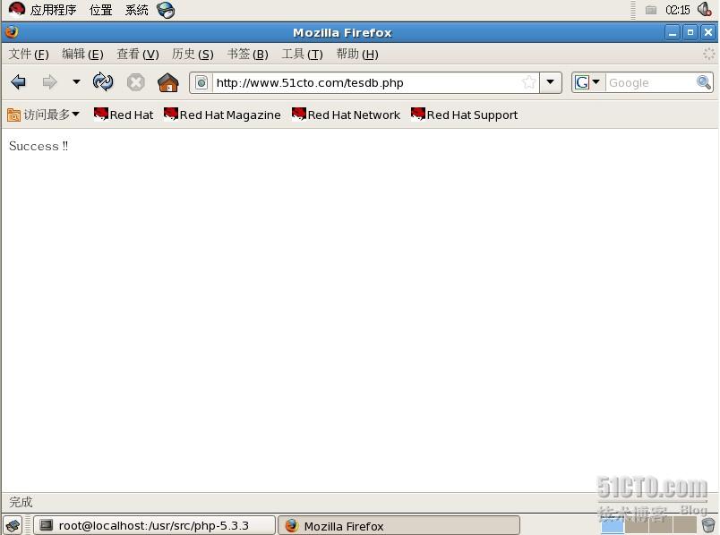

[iyunv@localhost php-5.3.3]# vim /usr/local/apache2/htdocs/tesdb.php
<?php
$link=mysql_connect("localhost","test","");
if(!$link) echo "Fail !!";
else echo "Success !!";
mysql=close();
