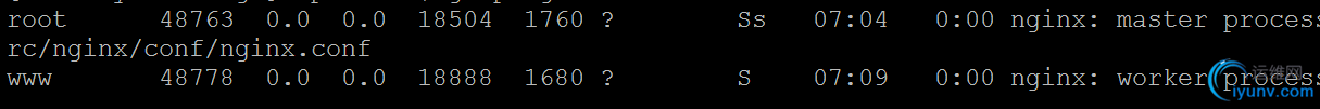

  启动nginx
/usr/local/src/nginx/sbin/nginx
  如果出现 nginx: [error] open() "/usr/local/src/nginx/logs/nginx.pid" failed (2: No such file or directory) 这个错误
/usr/local/src/nginx/sbin/nginx -c /usr/local/src/nginx/conf/nginx.conf
  这时已经启动成功
ps aux | grep nginx
  可以看到master 和 worker 进程开启
