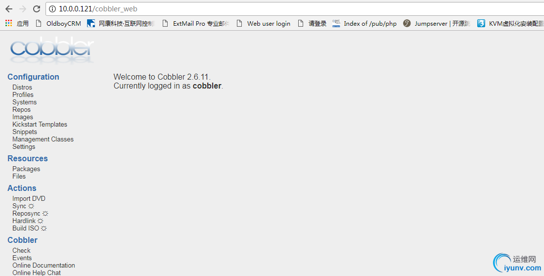

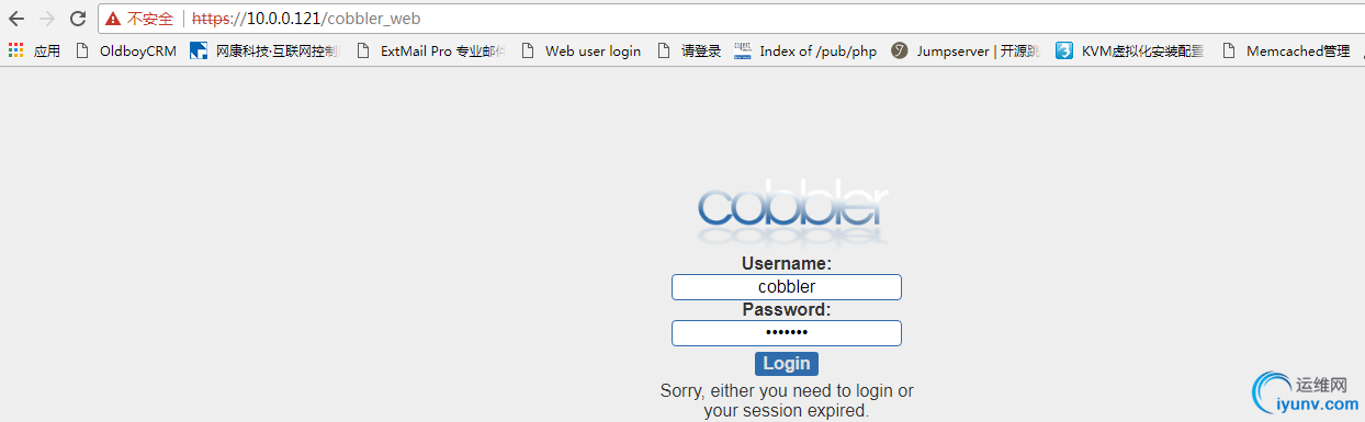

  8、此时打开浏览器输入

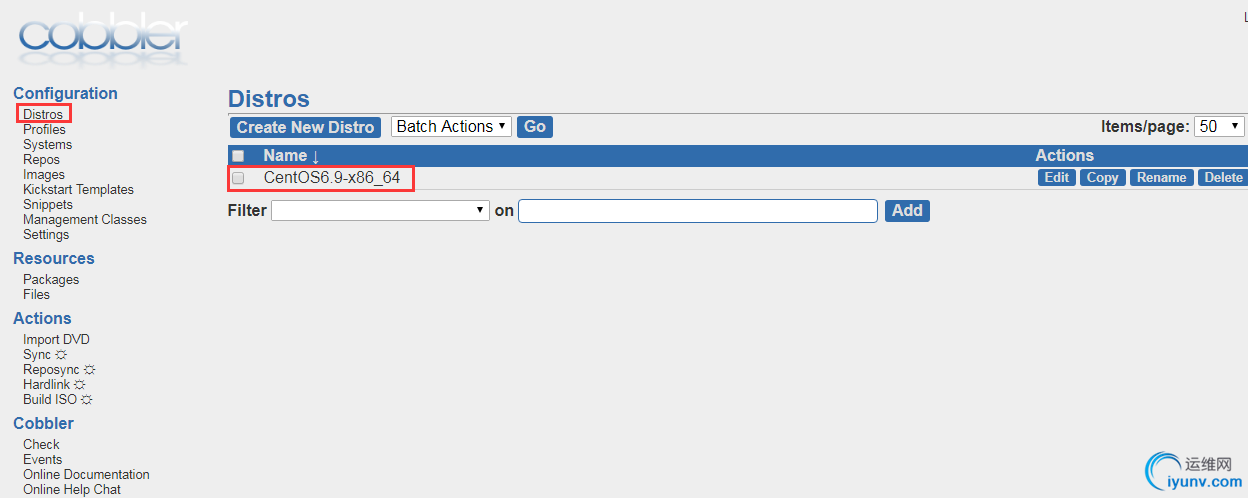

  三、使用Cobbler的web页面实现自动化安装系统

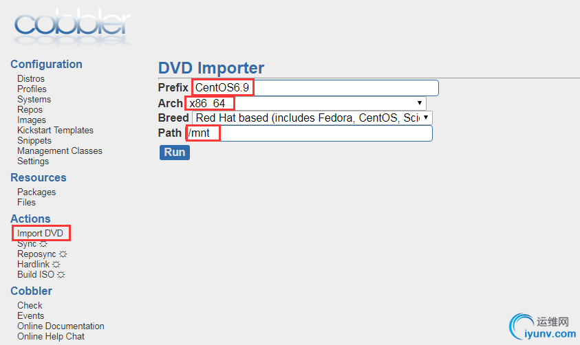

  1、导入镜像
[iyunv@cobbler ~]# mount /dev/cdrom /mnt/
mount: block device /dev/sr0 is write-protected, mounting read-only
[iyunv@cobbler ~]# df -h
Filesystem      Size  Used Avail Use% Mounted on
/dev/sda2        19G  1.6G   16G   9% /
tmpfs           931M     0  931M   0% /dev/shm
/dev/sda1       190M   35M  146M  19% /boot
/dev/sr0        3.7G  3.7G     0 100% /mnt
  通过rsync导入镜像
[iyunv@cobbler ~]# ps -ef|grep rsync
root       2087   1599 18 16:57 ?        00:00:05 rsync -a /mnt/ /var/www/cobbler/ks_mirror/CentOS6.9-x86_64 --progress
root       2088   2087  0 16:57 ?        00:00:00 rsync -a /mnt/ /var/www/cobbler/ks_mirror/CentOS6.9-x86_64 --progress
root       2089   2088 13 16:57 ?        00:00:03 rsync -a /mnt/ /var/www/cobbler/ks_mirror/CentOS6.9-x86_64 --progress
root       2106   1256  0 16:58 pts/1    00:00:00 grep rsync

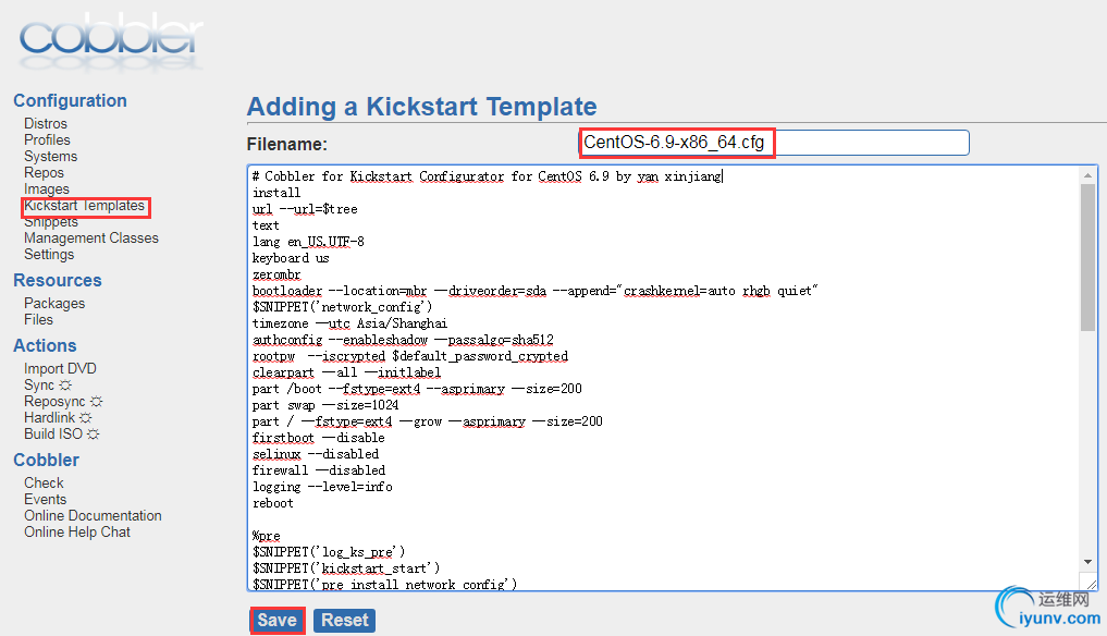

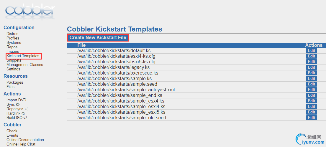

  2、创建ks文件

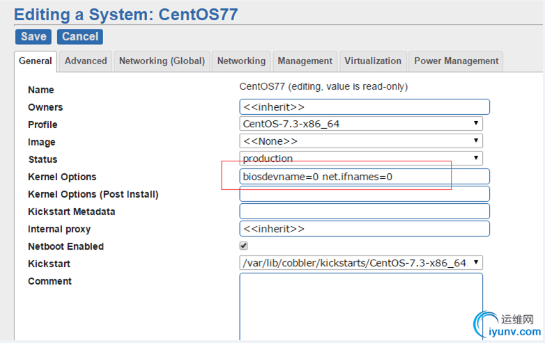

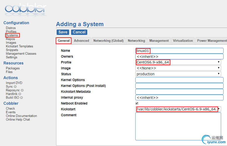

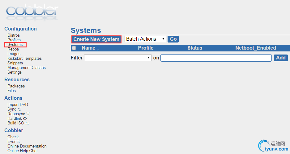

  3、定制系统

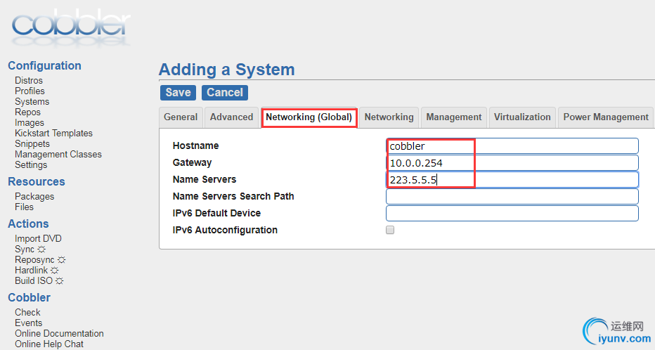

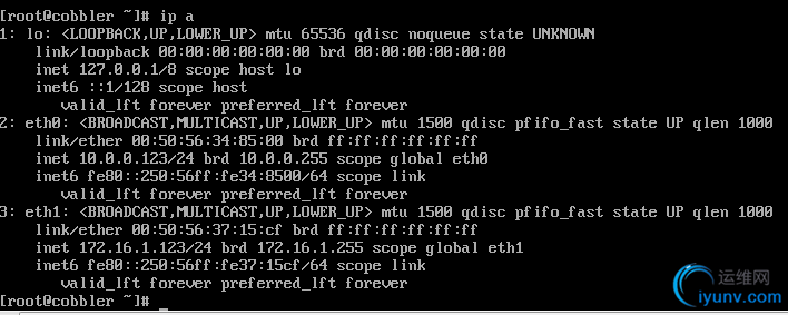

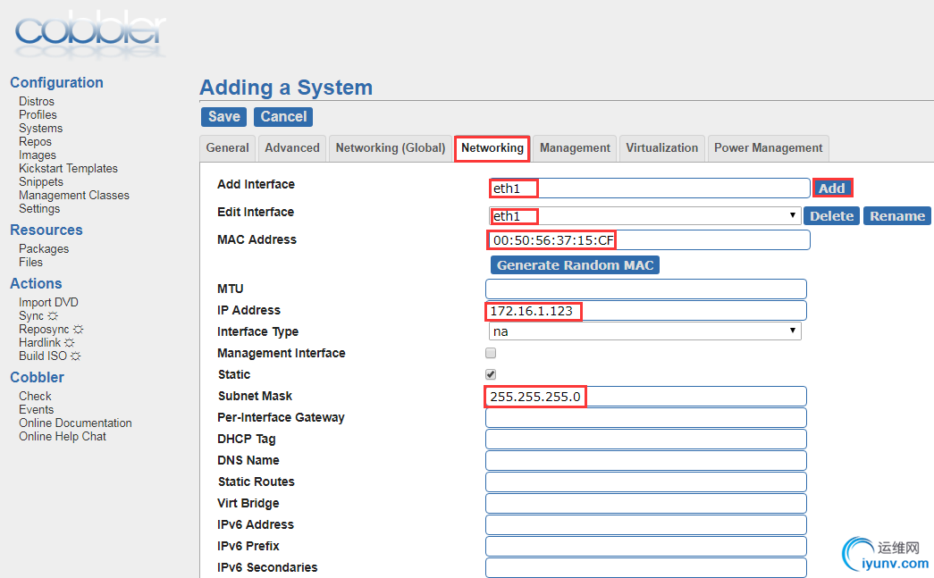

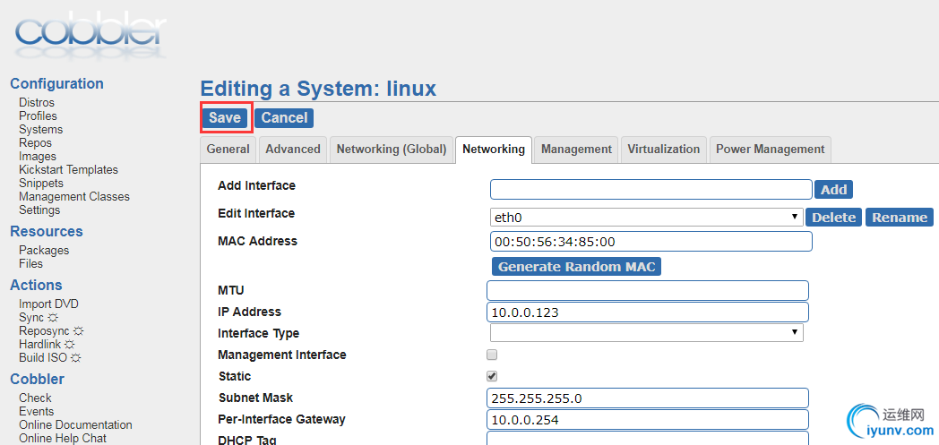

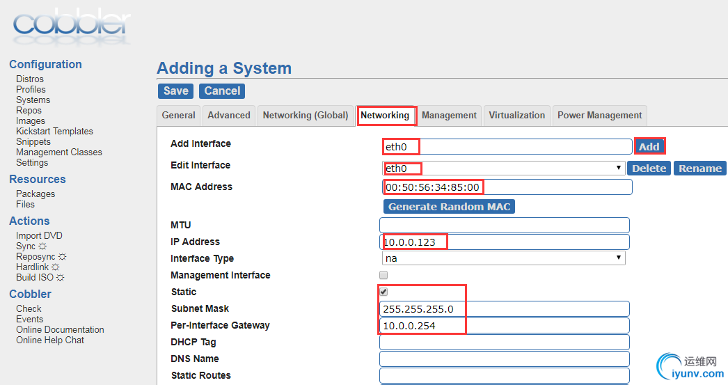

  根据机器的mac地址固定ip地址
  eth1
  eth0
  CentOS7,修改网卡名
  保存

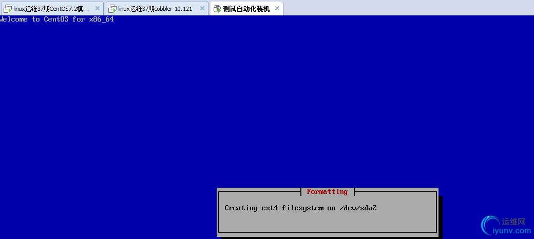

  4、新建空白虚拟机测试
  休息片刻,一会儿回来查看结果
  4、CentOS6与CentOS7的ks.cfg文件
  CentOS6.9
# Cobbler for Kickstart Configurator for CentOS 6.9 by yan xinjiang
install
url --url=$tree
text
lang en_US.UTF-8
keyboard us
zerombr
bootloader --location=mbr --driveorder=sda --append="crashkernel=auto rhgb quiet"
$SNIPPET('network_config')
timezone --utc Asia/Shanghai
authconfig --enableshadow --passalgo=sha512
rootpw  --iscrypted $default_password_crypted
clearpart --all --initlabel
part /boot --fstype=ext4 --asprimary --size=200
part swap --size=1024
part / --fstype=ext4 --grow --asprimary --size=200
firstboot --disable
selinux --disabled
firewall --disabled
logging --level=info
reboot
%pre
$SNIPPET('log_ks_pre')
$SNIPPET('kickstart_start')
$SNIPPET('pre_install_network_config')
# Enable installation monitoring
$SNIPPET('pre_anamon')
%end
%packages
@base
@compat-libraries
@debugging
@development
tree
nmap
sysstat
lrzsz
dos2unix
telnet
%end
%post --nochroot
$SNIPPET('log_ks_post_nochroot')
%end
%post
$SNIPPET('log_ks_post')
# Start yum configuration
$yum_config_stanza
# End yum configuration
$SNIPPET('post_install_kernel_options')
$SNIPPET('post_install_network_config')
$SNIPPET('func_register_if_enabled')
$SNIPPET('download_config_files')
$SNIPPET('koan_environment')
$SNIPPET('redhat_register')
$SNIPPET('cobbler_register')
# Enable post-install boot notification
$SNIPPET('post_anamon')
# Start final steps
$SNIPPET('kickstart_done')
# End final steps
%end
  CentOS7.2
# Cobbler for Kickstart Configurator for CentOS 7.2 by yan xinjiang
install
url --url=$tree
text
lang en_US.UTF-8
keyboard us
zerombr
# Network information
part /boot --fstype xfs --size 1024
part swap --size 1024
part / --fstype xfs --size 1 --grow
firstboot --disable
selinux --disabled
firewall --disabled
reboot
%pre
%end
%packages
@base
@compat-libraries
@debugging
@development
tree
nmap
sysstat
lrzsz
dos2unix
telnet
htop
wget
vim
bash-completion
net-tools
iptraf
ncurses-devel
openssl-devel
zlib-devel
OpenIPMI-tools
screen
%end
%post
systemctl disable postfix.service
curl -o /etc/yum.repos.d/CentOS-Base.repo http://mirrors.aliyun.com/repo/Centos-7.repo
curl -o  /etc/yum.repos.d/epel.repo http://mirrors.aliyun.com/repo/epel-7.repo
%end
