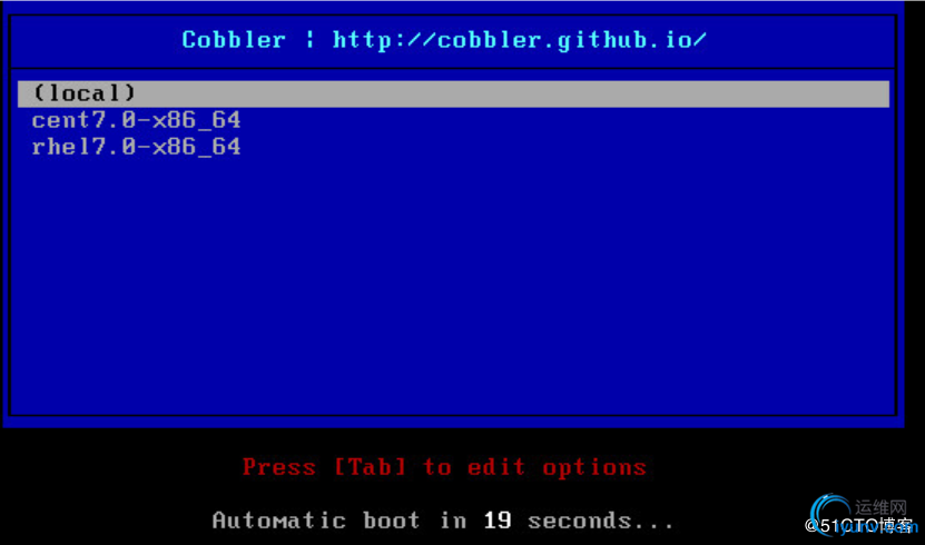

  8、重启所有服务
  9、安装成功,客户端启动:

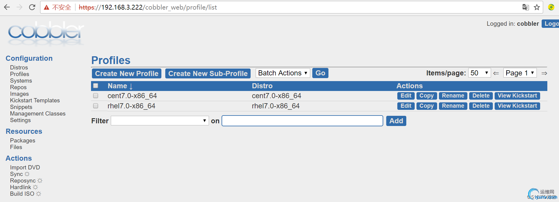

  11、打开cobber web

  解决方法:
[iyunv@cobbler ~]# vim /etc/cobbler/modules.conf
[authentication]
module = authn_configfile  重启cobber服务
  systemctl restart cobblerd
  效验报错:
[iyunv@cobbler ~]# cobbler check
  httpd does not appear to be running and proxying cobbler, or SELinux is in the way. Original traceback:
  Traceback (most recent call last):
  File "/usr/lib/python2.7/site-packages/cobbler/cli.py", line 251, in check_setup
  s.ping()
  File "/usr/lib64/python2.7/xmlrpclib.py", line 1233, in call
  return self.send(self.name, args)
  File "/usr/lib64/python2.7/xmlrpclib.py", line 1587, in request
  verbose=self.verbose
  File "/usr/lib64/python2.7/xmlrpclib.py", line 1273, in request
  return self.single_request(host, handler, request_body, verbose)
  File "/usr/lib64/python2.7/xmlrpclib.py", line 1321, in single_request
  response.msg,
  ProtocolError: <ProtocolError for 127.0.0.1:80/cobbler_api: 503 Service Unavailable>
  解决方法:
  关闭selinux:
[iyunv@cobbler ~]# vim /etc/selinux/config
SELINUX=disabled  重启服务器
