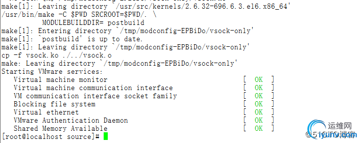

    [root@localhost source]# /usr/lib/vmware/bin/vmware-modconfig --console --install-all
  •   编辑完成之后删除临时的解包文件,进行命令行安装模块
    [root@localhost source]# vmware-modconfig --console --install-all
    Stopping VMware services:
    VMware Authentication Daemon[  OK  ]
    VM communication interface socket family[  OK  ]
    Virtual machine communication interface [  OK  ]
    Virtual machine monitor [  OK  ]
    Blocking file system[  OK  ]

    CC [M]  /tmp/modconfig-EPBiDo/vmci-only/common/vmciDoorbell.o
    CC [M]  /tmp/modconfig-EPBiDo/vmci-only/common/vmciDriver.o
    CC [M]  /tmp/modconfig-EPBiDo/vmci-only/common/vmciEvent.o
    CC [M]  /tmp/modconfig-EPBiDo/vmci-only/common/vmciHashtable.o
    CC [M]  /tmp/modconfig-EPBiDo/vmci-only/common/vmciQPair.o
    CC [M]  /tmp/modconfig-EPBiDo/vmci-only/common/vmciQueuePair.o
    CC [M]  /tmp/modconfig-EPBiDo/vmci-only/common/vmciResource.o
    CC [M]  /tmp/modconfig-EPBiDo/vmci-only/common/vmciRoute.o
    CC [M]  /tmp/modconfig-EPBiDo/vmci-only/driverLog.o
    LD [M]  /tmp/modconfig-EPBiDo/vmci-only/vmci.o
    Building modules, stage 2.
    MODPOST 1 modules
    CC  /tmp/modconfig-EPBiDo/vmci-only/vmci.mod.o
    LD [M]  /tmp/modconfig-EPBiDo/vmci-only/vmci.ko.unsigned
    NO SIGN [M] /tmp/modconfig-EPBiDo/vmci-only/vmci.ko
    make[1]: Leaving directory `/usr/src/kernels/2.6.32-696.6.3.el6.x86_64'
    /usr/bin/make -C $PWD SRCROOT=$PWD/. \
    MODULEBUILDDIR= postbuild
    make[1]: Entering directory `/tmp/modconfig-EPBiDo/vmci-only'
    make[1]: `postbuild' is up to date.
    make[1]: Leaving directory `/tmp/modconfig-EPBiDo/vmci-only'
    cp -f vmci.ko ./../vmci.o
    make: Leaving directory `/tmp/modconfig-EPBiDo/vmci-only'
    Using kernel build system.
    make: Entering directory `/tmp/modconfig-EPBiDo/vsock-only'
    /usr/bin/make -C /lib/modules/2.6.32-696.6.3.el6.x86_64/build/include/.. SUBDIRS=$PWD SRCROOT=$PWD/. \
    MODULEBUILDDIR= modules
    make[1]: Entering directory `/usr/src/kernels/2.6.32-696.6.3.el6.x86_64'
    CC [M]  /tmp/modconfig-EPBiDo/vsock-only/linux/af_vsock.o
    CC [M]  /tmp/modconfig-EPBiDo/vsock-only/linux/notify.o
    CC [M]  /tmp/modconfig-EPBiDo/vsock-only/linux/notifyQState.o
    CC [M]  /tmp/modconfig-EPBiDo/vsock-only/linux/stats.o
    CC [M]  /tmp/modconfig-EPBiDo/vsock-only/linux/util.o
    CC [M]  /tmp/modconfig-EPBiDo/vsock-only/linux/vsockAddr.o
    CC [M]  /tmp/modconfig-EPBiDo/vsock-only/driverLog.o
    LD [M]  /tmp/modconfig-EPBiDo/vsock-only/vsock.o
    MODPOST 1 modules
    CC  /tmp/modconfig-EPBiDo/vsock-only/vsock.mod.o
    LD [M]  /tmp/modconfig-EPBiDo/vsock-only/vsock.ko.unsigned
    NO SIGN [M] /tmp/modconfig-EPBiDo/vsock-only/vsock.ko
    make[1]: Entering directory `/tmp/modconfig-EPBiDo/vsock-only'
    make[1]: Leaving directory `/tmp/modconfig-EPBiDo/vsock-only'
    cp -f vsock.ko ./../vsock.o
    make: Leaving directory `/tmp/modconfig-EPBiDo/vsock-only'
    Starting VMware services:
    Virtual ethernet[  OK  ]
    Shared Memory Available [  OK  ]
  •   安装过程中没有发现报错- 进行查看一下模块状态
    [root@localhost vmware]# vmware-modconfig --console --install-status
    vmmon: installed
    vmnet: installed
    vmblock: installed
    vmci: installed
    vsock: installed
    [root@localhost vmware]# /etc/init.d/vmware  start
    VM communication interface socket family                [  OK  ]
    Blocking file system                                    [  OK  ]
    Virtual ethernet                                        [  OK  ]
    VMware Authentication Daemon                            [  OK  ]
成功!@^^@! 不容易啊.让我折腾小半天
