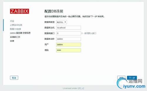

  1.5、创建Zabbix数据库
  mysql -uroot -pkingdee
  mysql> create database zabbix character set utf8 collate utf8_bin;
  Query OK, 1 row affected (0.04 sec)
  mysql> grant all privileges on zabbix.* to zabbix@localhost identified by 'zabbix';
  Query OK, 0 rows affected (0.01 sec)
  mysql> FLUSH PRIVILEGES;
  mysql> quit
  Bye

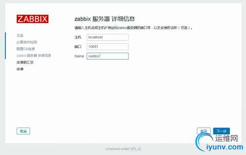

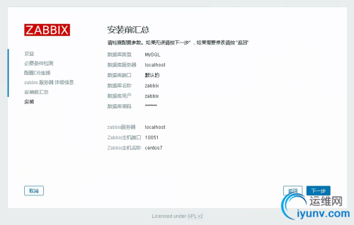

  5、安装zabbix server
  wget https://nchc.dl.sourceforge.net/project/zabbix/ZABBIX%20Latest%20Stable/3.2.6/zabbix-3.2.6.tar.gz
  tar -zxvf zabbix-3.2.0.tar.gz
  groupadd zabbix
  useradd -g zabbix zabbix
  yum install mysql-devel
  yum install net-snmp-devel
  ./configure --prefix=/usr/local/zabbix-3.2/ --enable-server --enable-agent --with-mysql --with-net-snmp --with-libcurl --with-libxml2
  结果如下:
Configuration:
  Detected OS:           linux-gnu
  Install path:          /usr/local
  Compilation arch:      linux
  Compiler:              gcc
  Compiler flags:         -g -O2
  Library-specific flags:
    database:               -I/usr/include/mysql -g  -m64 -fPIC  -g -fabi-version=2 -fno-omit-frame-pointer -fno-strict-aliasing
    libXML2:               -I/usr/include/libxml2
    Net-SNMP:               -I/usr/local/include -I/usr/lib64/perl5/CORE -I. -I/usr/include
  Enable server:         yes
  Server details:
    With database:         MySQL
    WEB Monitoring:        cURL
    Native Jabber:         no
    SNMP:                  yes
    IPMI:                  no
    SSH:                   no
    TLS:                   no
    ODBC:                  no
    Linker flags:             -L/usr/lib64/mysql        -L/usr/lib64      -rdynamic
    Libraries:               -lmysqlclient      -lxml2    -lnetsnmp      -lcurl -lm -ldl  -lresolv
  Enable proxy:          no
  Enable agent:          yes
  Agent details:
    TLS:                   no
    Linker flags:              -rdynamic
    Libraries:                 -lcurl -lm -ldl  -lresolv
  Enable Java gateway:   no
  LDAP support:          no
  IPv6 support:          no
*            Now run 'make install'                       *
*            Thank you for using Zabbix!                  *
*              <http://www.zabbix.com>                    *
  make
  make install
  导入表:
  mysql -uzabbix -pzabbix zabbix < database/mysql/schema.sql
  mysql -uzabbix -pzabbix zabbix < database/mysql/images.sql
  mysql -uzabbix -pzabbix zabbix < database/mysql/data.sql
  上述导库请务必注意顺序,否则会出现错误:
  ERROR 1146 (42S02) at line 2: Table 'zabbix.hosts' doesn't exist
  配置 zabbix_server 配置文件:vim  /usr/local/zabbix-3.2/etc/zabbix_server.conf
  DBHost=localhost
  DBName=zabbix
  DBUser=zabbix
  DBPassword=zabbix

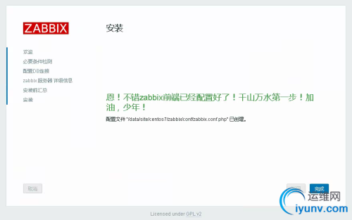

  5.1 拷贝前端文件
  mkdir /data/site/centos7/zabbix
  cp -rp frontends/php/* /data/site/centos7/zabbix
  启动 zabbix server
  /usr/local/zabbix-3.2/sbin/zabbix_server
  启动 nginx
  /usr/local/nginx/sbin/nginx
  启动 PHP
  /usr/local/php-5.5.38/sbin/php-fpm

  PHP连接MySQL报错"No such file or directory"的解决办法
  http://www.linuxidc.com/Linux/2012-12/76150.htm

  很多时间权限会导致一些问题(比如NGINX安装向导要向网站中写入配置文件 /data/site/centos7/zabbix/conf/zabbix.conf.php),需要对CONF目录授权:
  chmod -R 777 /data/site/centos7/zabbix/conf
  安装后设置服务器:
