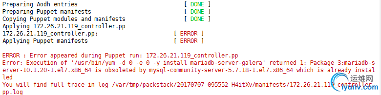

  报错一、
解决方法:修改hosts文件,同步主机名
  vim /etc/hosts
  127.0.0.1 openstack
  报错二、
ERROR : Error appeared during Puppet run: 192.168.1.201_mariadb.ppError: Execution of '/usr/bin/yum -d 0 -e 0 -y install mariadb' returned 1: Error: Package: 1:mariadb-5.5.44-2.el7.centos.x86_64 (dvd)
You will find full trace in log /var/tmp/packstack/20160704-142958-_jXSqZ/manifests/192.168.1.201_mariadb.pp.log
怀疑应该是软件问题
[root@h1 ~]# yum -d 0 -e 0 -y install mariadb-5.5.44-2.el7.centos.x86_64错误:软件包:1:mariadb-5.5.44-2.el7.centos.x86_64 (dvd)
          需要:mariadb-libs(x86-64) = 1:5.5.44-2.el7.centos
          已安装: 1:mariadb-libs-5.5.47-1.el7_2.x86_64 (@updates)
              mariadb-libs(x86-64) = 1:5.5.47-1.el7_2
          可用: 1:mariadb-libs-5.5.44-2.el7.centos.x86_64 (dvd)
您可以尝试添加 --skip-broken 选项来解决该问题
您可以尝试执行:rpm -Va --nofiles --nodigest
一个是5.5.44  一个是5.5.47
[root@h1 Packages]# rpm -e --nodeps mariadb-libs-5.5.47-1.el7_2.x86_64[root@h1 Packages]# rpm -qa mariadb-libs                              [root@h1 Packages]# rpm -ivh mariadb-libs-5.5.44-2.el7.centos.x86_64.rpm准备中...                          ################################# [100%]
正在升级/安装...
   1:mariadb-libs-1:5.5.44-2.el7.cento################################# [100%]
[root@h1 Packages]# rpm -qa mariadb-libs                              mariadb-libs-5.5.44-2.el7.centos.x86_64
  正常测试

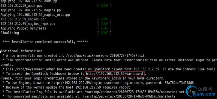

总结:方法3个,1是在127.0.0.1 添加主机名,,2 重新设置一遍 root 在msyql 的权限%     3 卸载掉数据库,重新测试。
打算一会测试  用内网ip,  然后在路由器上做  80映射,这样应该会好一点。不知道行不行。简直是作死,在云上搭建openstack。。。。测试完。
**** Installation completed successfully ******
Additional information:
* Time synchronization installation was skipped. Please note that unsynchronized time on server instances might be problem for some OpenStack components.
* File /root/keystonerc_admin has been created on OpenStack client host x.x.x.x . To use the command line tools you need to source the file.
* To access the OpenStack Dashboard browse to http://x.x.x.x /dashboard .
Please, find your login credentials stored in the keystonerc_admin in your home directory.
* Because of the kernel update the host   x.x.x.x  requires reboot.
* Because of the kernel update the host 127.0.0.1 requires reboot.
* The installation log file is available at: /var/tmp/packstack/20160801-224547-mTb9CN/openstack-setup.log
* The generated manifests are available at: /var/tmp/packstack/20160801-224547-mTb9CN/manifests

报错 四、
安装Mitaka
执行下列命令安装RDO库
yum install https://rdoproject.org/repos/rdo-release.rpm
安装CentOS openstack RPM repository
yum install centos-release-openstack-mitaka
更新系统包
yum update
安装packstack工具
yum install openstack-packstack
安装openstack Mitaka
packstack --allinone
执行这一步之后会花费一些时间
看到下面类似的信息,说明openstak mitaka已经安装完成了,同时可以看到dashboard的入口
从/root/keystonerc_admin文件里可以找到dashboard登陆信息
