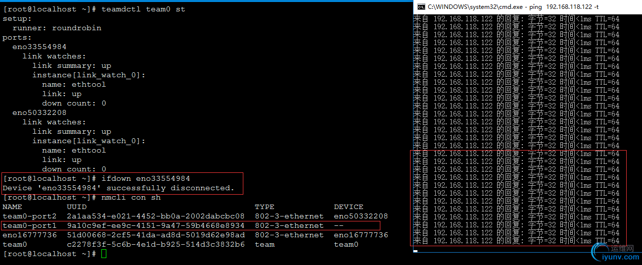

  两张网卡同时在线,现在down掉其中一张网卡,
[root@localhost ~]# nmcli con del team0-port1
Connection 'team0-port1' (0331ea43-95c0-4106-b388-8484d4c3940d) successfully deleted.
[root@localhost ~]# nmcli con shNAME         UUID                                  TYPE            DEVICE
eno16777736  51d00668-2cf5-41da-ad8d-5019d62e98ad  802-3-ethernet  eno16777736
team0        9dc48bd6-54b9-48db-b7dd-ecf34ae9196f  team            team0
team0-port2  880f2146-fe93-42dd-8d28-7d0dd50b4011  802-3-ethernet  eno50332208
[root@localhost ~]# teamdctl team0 st
setup:
  runner: roundrobin
ports:
  eno50332208
    link watches:
      link summary: up
      instance[link_watch_0]:
        link: up
        down count: 0
  这样就发现eno33554984网卡已经down掉了。

  虚拟机环境就这样测试了吧,至于生产环境就直接拔网线,ping测试。

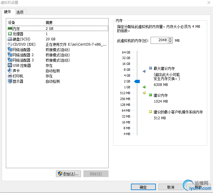

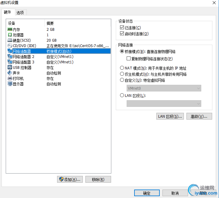

  资料有说linux下roundrobin具有容错的效果,为了测试是否有容错的效果,虚拟机做了下更改来验证:
  这一次网卡全部改成桥接模式,为了更好的测试是否具有容错性。
  roundrobin已经配置完毕。接下来我们down掉一张网卡检查是否具有容错性。
  通过虚拟机测试,容错性是存在的。

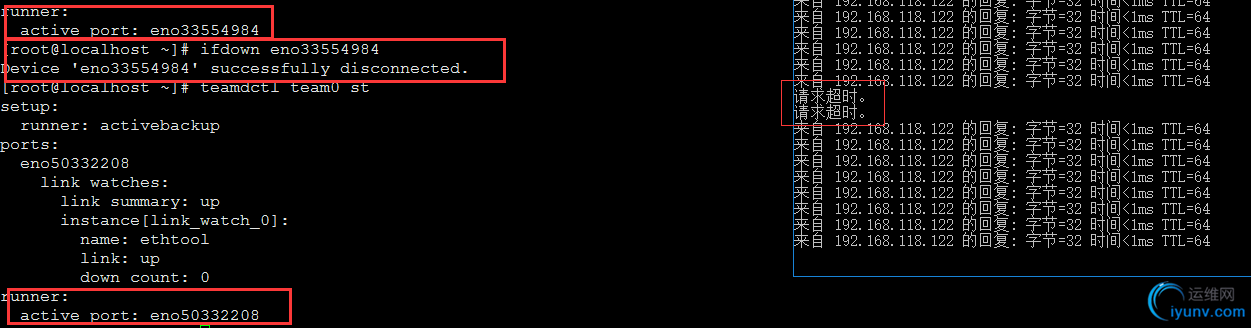

  5. 双网卡绑定activebackup的实现
[root@localhost ~]# nmcli con sh NAME         UUID                                  TYPE            DEVICE
team0-port2  2a1aa534-e021-4452-bb0a-2002dabcbc08  802-3-ethernet  eno50332208
team0-port1  9a10c9ef-ee9c-4151-9a47-59b4668e8934  802-3-ethernet  --          eno16777736  51d00668-2cf5-41da-ad8d-5019d62e98ad  802-3-ethernet  eno16777736
team0        c2278f3f-5c6b-4e1d-b925-514d3c3832b6  team            team0
[root@localhost ~]# nmcli con del team0 team0-port1 team0-port2
Connection 'team0' (c2278f3f-5c6b-4e1d-b925-514d3c3832b6) successfully deleted.
Connection 'team0-port1' (9a10c9ef-ee9c-4151-9a47-59b4668e8934) successfully deleted.
Connection 'team0-port2' (2a1aa534-e021-4452-bb0a-2002dabcbc08) successfully deleted.
# 以上操作就删除了roundrobin模式,恢复到初始状态。

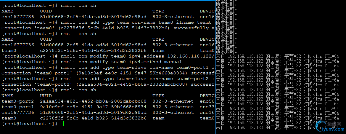

# 添加逻辑网卡team0,并启用activebackup模式
[root@localhost ~]# nmcli con add type team con-name team0 ifname team0 config '{"runner":{"name":"activebackup"}}'Connection 'team0' (f0794e59-419d-4c2a-96b9-464610b6321a) successfully added.
# 绑定ip
[root@localhost ~]# nmcli con modify team0  ipv4.address 192.168.118.122/24 ipv4.gateway 192.168.118.1[root@localhost ~]# nmcli con modify team0 ipv4.method manual
# 添加物理网卡到activebackup模式
[root@localhost ~]# nmcli con add type team-slave con-name team0-port1 ifname eno33554984 master team0
Connection 'team0-port1' (52656904-6e85-4a04-98b4-2b19773fa290) successfully added.
[root@localhost ~]# nmcli con add type team-slave con-name team0-port2 ifname eno50332208 master team0
Connection 'team0-port2' (44d96e3a-014a-481f-9122-4ca2d3be9f7a) successfully added.
setup:
  runner: activebackup
ports:
  eno33554984
    link watches:
      link summary: up
        link: up
        down count: 0
  eno50332208
    link watches:
      link summary: up
        link: up
        down count: 0runner:
  active port: eno33554984
  成功,处于活动中的网卡为 eno33554984
  5.1 测试
  通过down掉活动网卡测试网络是否仍然处于连通状态
  测试成功。
  注意: 在做网卡绑定的时候,如果发现物理网卡总是无法绑定到team0,请检查该物理网卡是否处于up状态。
