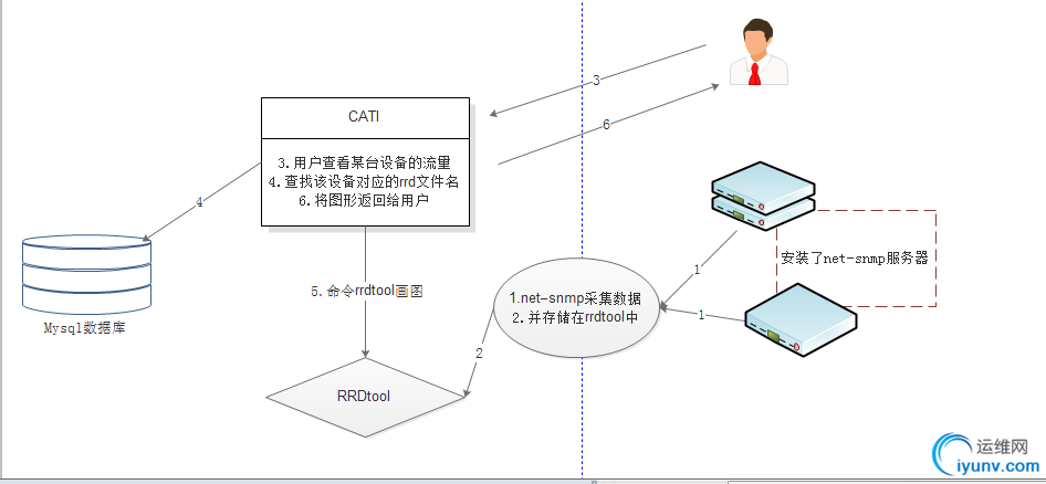

工作原理:
snmp关系着数据的收集,rrdtool关系数据存储和图表的生成,snmp抓取的数据不是存储在数据库中,而是存储在rrdtool生成的rrd文件中,简单原理图如下:

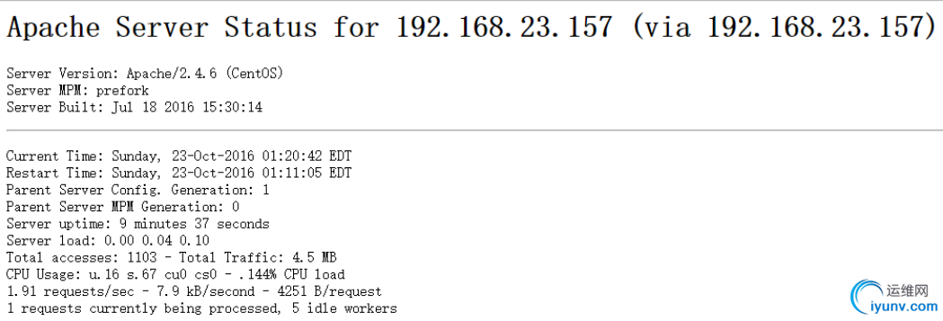

(3)访问http://192.168.23.157/server-status查看模块的详细信息

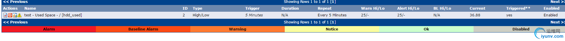

(4)告警被触发,查看邮件
[root@cacti-server ~]# cat  /var/spool/mail/root
To: root@192.168.23.156
Subject: ALERT: test - Used Space - / [hdd_used] [hdd_used] went above threshold of 25 with 36.8871
From: Cacti <Cacti@localhost.localdomain>
Date: Mon, 24 Oct 2016 14:00:03 +0800
An alert has been issued that requires your attention.
Host: test (192.168.23.157)
URL: http://192.168.23.156/cacti//graph.php?local_graph_id=103&rra_id=1
Message: ALERT: test - Used Space - / [hdd_used] [hdd_used] went above threshold of 25 with 36.8871
