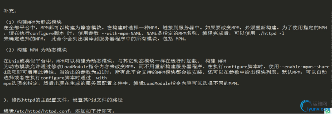

#./configure --prefix=/usr/local/apache --sysconfdir=/etc/httpd24 --enable-so --enable-ssl --enable-cgi --enable-rewrite --with-zlib --with-pcre --with-apr=/usr/local/apr --with-apr-util=/usr/local/apr-util --enable-modules=most --enable-mpms-shared=all --with-mpm=event
注意--sysconfdir=/etc/httpd24默认配置文件目录
--prefix=/usr/local/apache默认安装目录
#make && make install

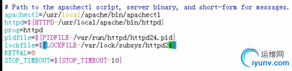

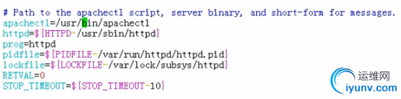

#cp httpd httpd24
#vim httpd24
将上如中的参数修改如下

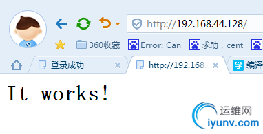

service httpd start
httpd -M 查看装载的模块

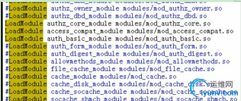

cd /etc/httpd24目录
vim httpd.conf下启用或禁用某一模块

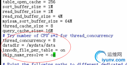

#mkdir /etc/mysql
#cp support-files/my-large.cnf /etc/mysql/my.cnf
#vim /etc/mysql/my.cnf

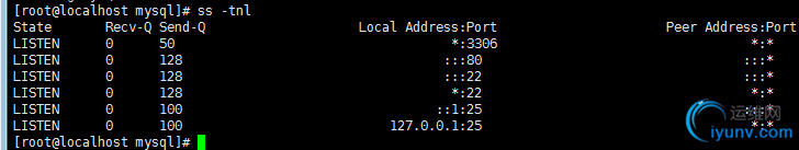

#service mysqld start
#ss -tnl
#/usr/local/mysql/bin/mysql

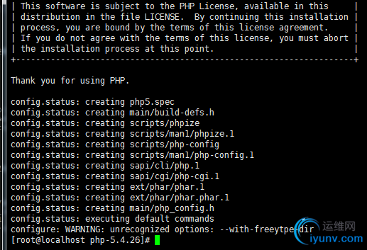

./configure --prefix=/usr/local/php --with-mysql=/usr/local/mysql --with-openssl --with-mysql=/usr/local/mysql/bin/mysql_config --enable-mbstring --with-freeytpe-dir --with-jpeg-dir --with-png-dir --with-zlib --with-libxml-dir=/usr --enable-xml --enable-sockets --with-apxs2=/usr/local/apache/bin/apxs --with-mcrypt --with-config-file-path=/etc --with-config-file-scan-dir=/etc/php.d --with-bz2 --enable-maintainer-zts
报错
configure: error: xml2-config not found. Please check your libxml2 installation.
解决办法yum install libxml2-devel -y
configure: error: mcrypt.h not found. Please reinstall libmcrypt.
解决办法yum install libmcrypt libmcrypt-devel mcrypt mhash -y
configure: error: Cannot find MySQL header files under /usr/local/mysql/bin/mysql_config
Note that the MySQL client library is not bundled anymore!
解决办法
--with-mysql=/usr/local/mysql/bin/mysql_config改为--with-mysql

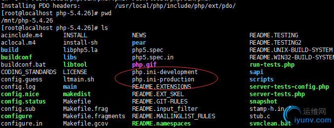

为php提供配置文件
cp php.ini-production /etc/php.ini

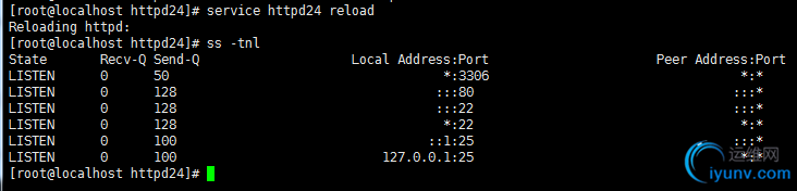

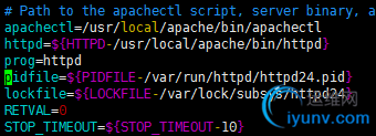

问题service httpd24 reload
Reloadinghttpd:             [FAILED]
解决办法
修改httpd.pid的位置
vim /etc/rc.d/init.d/httpd24
改为

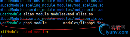

3.编辑apache配置文件httpd.conf,apache支持php
cd /etc/httpd24
cp httpd.conf{,.bak}
vim httpd.conf.bak
首先确保
其次添加如下两行
AddType application/x-httpd-php.php
AddType application/x-httpd-php-spurce.phps
定位至DirectoryIndex index.html
修改为:
DirectoryIndexindex.phpindex.html

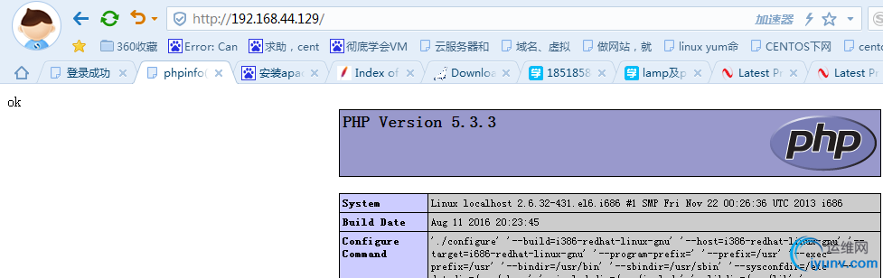

而后重新启动httpd或让其重新载入配置文件即可测试php是否已经可以正常使用。
cd /usr/local/apache/
cd htdocs/
mv index.html index.php
vim index.php
测试页面index.php示例如下
<?php
        $conn = mysql_connect('127.0.0.1','root','beijing');
        if($conn)
                echo "ok";
        else
                echo "Failure";
        mysql_close();
        phpinfo();
