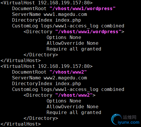

  (2)创建两个虚拟主机www1.magedu.com和www2.mage.com
  ~]#mkdir -pv /vhost/www{1,2}
  ~]#vim /etc/httpd24/extra/httpd-vhosts.conf

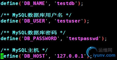

  (3)下载worepress并解压至/vhost/www1/目录下,修改配置文件:
  ~]#mv wp-config-sample.php wp-config.php
  ~]#vim wp-config.php

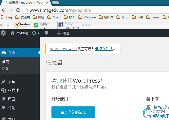

  (4)测试www1.magedu.com域名
