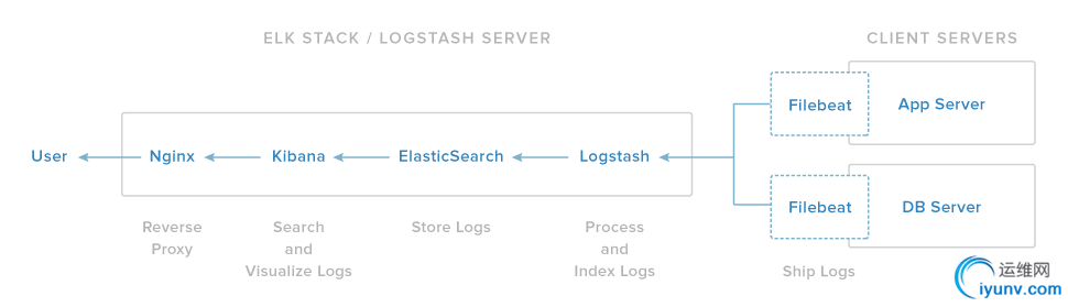

  Our ELK stack setup has four main components:
  •   Logstash: The server component of Logstash that processes incoming logs
  •   Elasticsearch: Stores all of the logs
  •   Kibana: Web interface for searching and visualizing logs, which will be proxied through Nginx
  •   Filebeat: Installed on client servers that will send their logs to Logstash, Filebeat serves as a log shipping agent that utilizes the lumberjack networking protocol to communicate with Logstash
  We will install the first three components on a single server, which we will refer to as our ELK Server. Filebeat will be installed on all of the client servers that we want to gather logs for, which we will refer to collectively as our Client Servers.

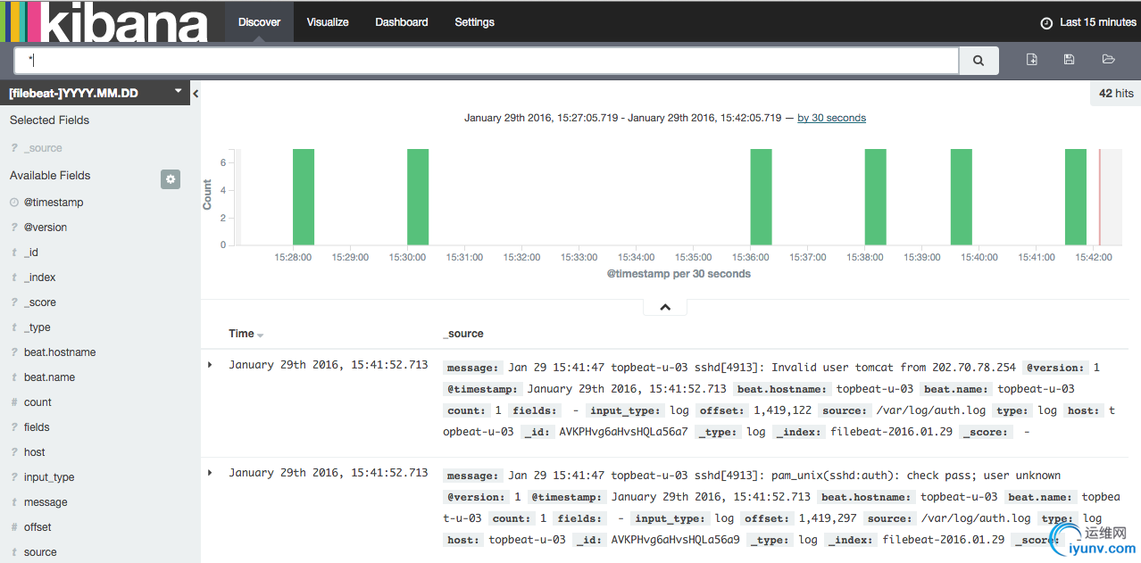

  Kibana is now accessible via your FQDN or the public IP address of your ELK Server i.e. http://elk_server_public_ip/. If you go there in a web browser, after entering the "kibanaadmin" credentials, you should see a Kibana welcome page which will ask you to configure an index pattern. Let's get back to that later, after we install all of the other components.

  When we start using Kibana, we will select the Filebeat index pattern as our default.

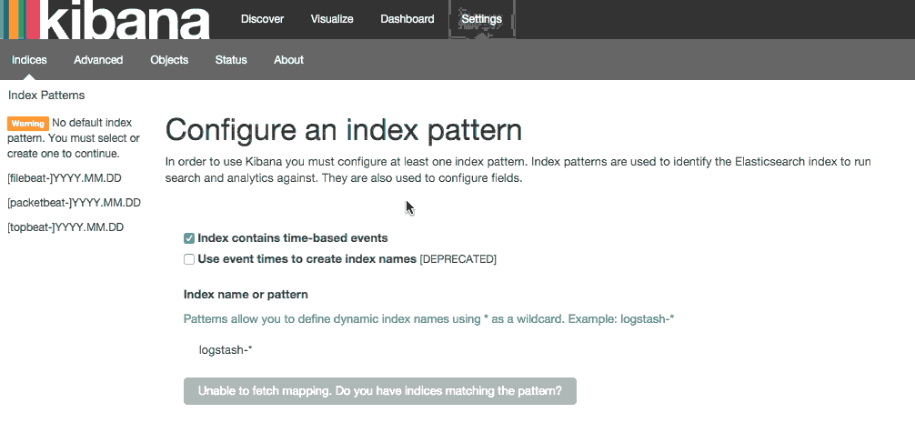

  In a web browser, go to the FQDN or public IP address of your ELK Server. After entering the "kibanaadmin" credentials, you should see a page prompting you to configure a default index pattern:
  Go ahead and select [filebeat]-YYY.MM.DD from the Index Patterns menu (left side), then click the Star (Set as default index) button to set the Filebeat index as the default.
  Now click the Discover link in the top navigation bar. By default, this will show you all of the log data over the last 15 minutes. You should see a histogram with log events, with log messages below:
  Right now, there won't be much in there because you are only gathering syslogs from your client servers. Here, you can search and browse through your logs. You can also customize your dashboard.
  Try the following things:
  •   Search for "root" to see if anyone is trying to log into your servers as root
  •   Search for a particular hostname (search for host: "hostname")
  •   Change the time frame by selecting an area on the histogram or from the menu above
  •   Click on messages below the histogram to see how the data is being filtered
  Kibana has many other features, such as graphing and filtering, so feel free to poke around!
