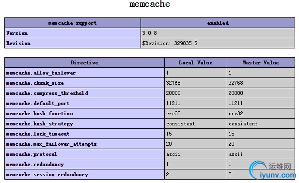

  7、通过phpinfo()可以查看memcached信息

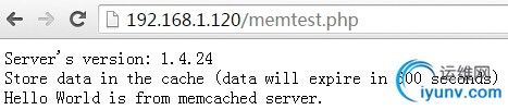

  附php的memcache测试代码:
  <?php
  $mem = new Memcache;
  $mem->connect("192.168.1.120", 11211)  or die("Could not connect");
  $version = $mem->getVersion();
  echo "Server's version: ".$version."<br/>\n";
  $mem->set('hellokey', 'Hello World', 0, 600) or die("Failed to save data at the memcached server");
  echo "Store data in the cache (data will expire in 600 seconds)<br/>\n";
  $get_result = $mem->get('hellokey');
  echo "$get_result is from memcached server.";

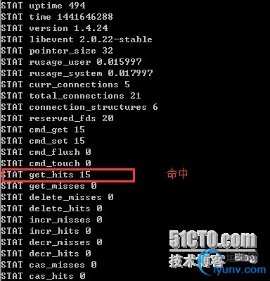

  查看命中结果
  telnet 192.168.1.120 11211
  输入命令:status
