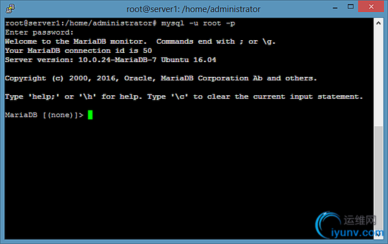

  Test the login to MariaDB with the "mysql command"
  mysql -u root -p
  and enter the MariaDB root password that you've set above. The result should be similar to the screenshot below:
  To leave the MariaDB shell, enter the command "quit" and press enter.

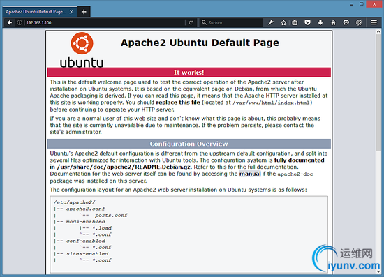

  Now direct your browser to http://192.168.1.100, and you should see the Apache2 default page (It works!):
  The document root of the apache default vhost is /var/www/html on Ubuntu and the main configuration file is /etc/apache2/apache2.conf. The configuration system is fully documented in /usr/share/doc/apache2/README.Debian.gz.

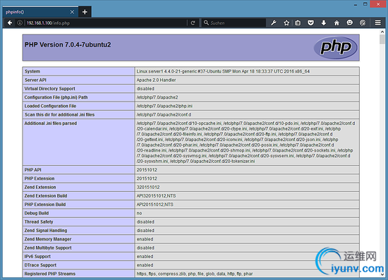

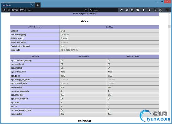

  Now we call that file in a browser (e.g. http://192.168.1.100/info.php):
  As you see, PHP 7.0 is working, and it's working through the Apache 2.0 Handler, as shown in the Server API line. If you scroll further down, you will see all modules that are already enabled in PHP5. MySQL is not listed there which means we don't have MySQL / MariaDB support in PHP yet.

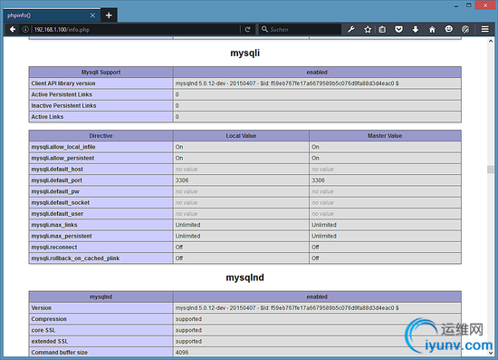

  To get MySQL support in PHP, we can install the php7.0-mysql package. It's a good>  apt-cache search php7.0
  Pick the ones you need and install them like this:
  apt-get -y install php7.0-mysql php7.0-curl php7.0-gd php7.0-intl php-pear php-imagick php7.0-imap php7.0-mcrypt php-memcache  php7.0-pspell php7.0-recode php7.0-sqlite3 php7.0-tidy php7.0-xmlrpc php7.0-xsl php7.0-mbstring php-gettext
  Now restart Apache2:
  systemctl restart apache2
  PHP 7 has now MySQL / MariaDB support as shown in phpinfo() above.

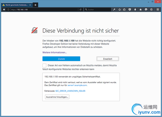

  Now test the SSL connection by opening https://192.168.1.100 in a web browser.
  You will receive an SSL warning as the SSL certificate of the server is a "self-signed" SSL certificate, this means that the browser does not trust this certificate by default and you have to accept the security warning first. After accepting the warning, you will see the apache default page.
  The closed "Green Lock" in front of the URL in the browser shows that the connection is encrypted.
  There are two ways to get rid of the SSL warning, either replace the self-signed SSL certificate /etc/ssl/certs/ssl-cert-snakeoil.pem with an officially signed SSL certificate that you buy from an SSL Authority or you get a free SSL certificate from Let's encrypt, which I will describe in chapter 8.

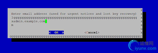

  Replace example.com with your domain name here again. The command will start a wizard that asks you several questions.
  Enter the email address where the administrator who is responsible for this website can be reached.

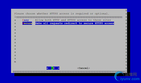

  Choose if you want to redirect non-SSL requests to https:// automatically. I'll select yes here to avoid duplicate content problems when the website is available as http:// and https:// version.

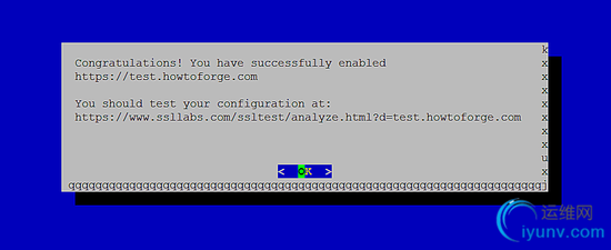

  The SSL certificate has been issued successfully.

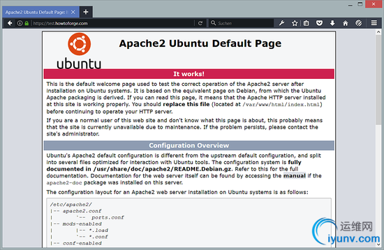

  When you access the website now with a browser, you will get redirected automatically to SSL and the green lock in front of the URL bar in the browser shows that we are using a trusted SSL certificate now.

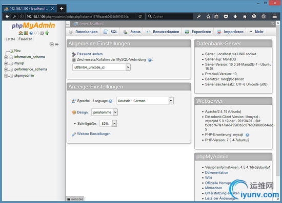

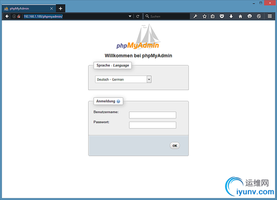

  Afterward, you can access phpMyAdmin under http://192.168.1.100/phpmyadmin/:
