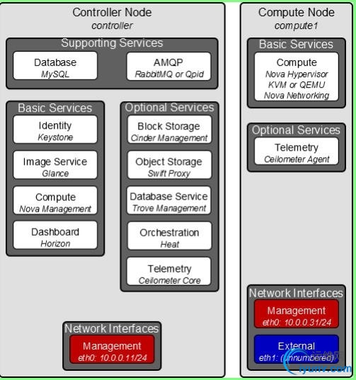

  nova controller node setup
  1. Install and Configure OpenStack Compute Service (Nova)

  nova computer node setup
  1. eth0 for management/public/floating (192.168.1.0/24), eth1 for internal/flat (192.168.20.0/24), it's recommended to use seperated nic for management network

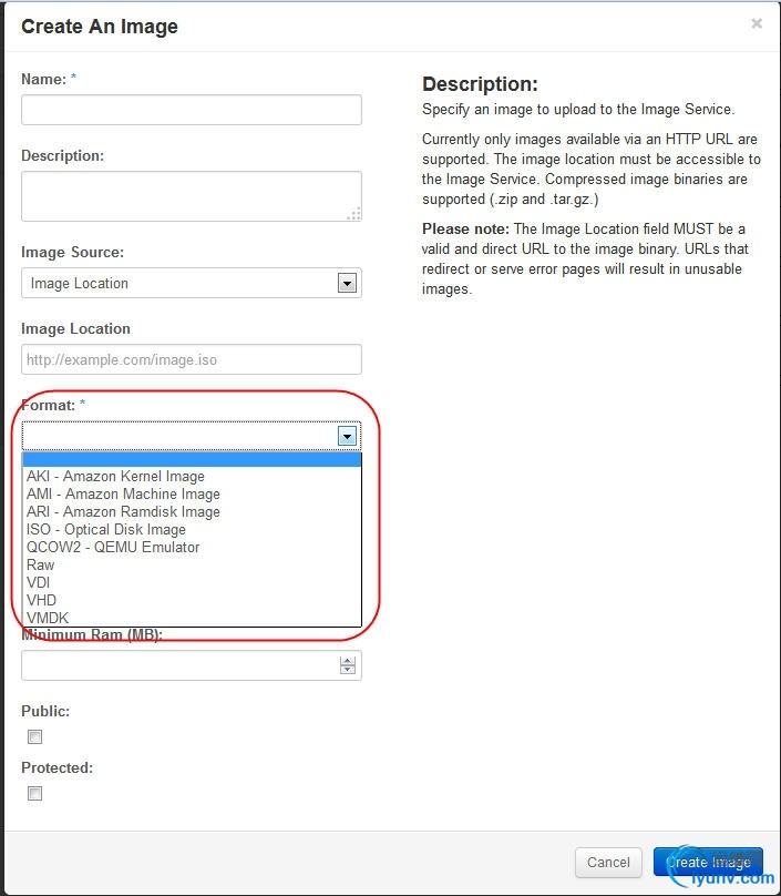

  1. you can use vmware workstation to build images, then upload to glance using dashboard
  ubuntu
1). vi /etc/hosts to remove 127.0.1.1. item
2). enable ssh login
3). enable dhcp client on interface
4). enable normal username/password
5). set root password
centos/redhat
1). rm -rf /etc/ssh/ssh_host_*
2). vi /etc/sysconfig/network-scripts/ifcfg-ethX to remove HWADDR and UUID items
3). rm -rf /etc/udev/rules.d/70-persistent-net.rules
4). enable ssh login
5). enable dhcp client on interface (also vi /etc/sysconfig/network, /etc/resolv.conf)
  6). enable normal username/password
7). set root password

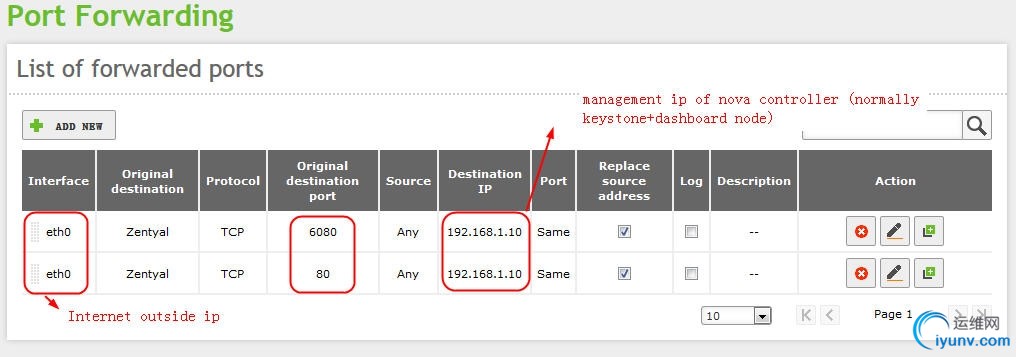

  Access novnc console from Internetmethod1
1. add another interface face to Internet on nova controller (normally keystone+dashboard node)
2. assign a public ip address
3. on computer node, vi /etc/nova/nova.conf
novncproxy_base_url=http://public_ip_address_of_nova_controller:6080/vnc_auto.html
service nova-compute restart
  4. nova get-vnc-console CirrOS novnc
  http://public_ip_address_of_nova_controller:6080/vnc_auto.html?token=4f9c1f7e-4288-4fda-80ad-c1154a954673
  Access novnc console from Internetmethod2
  1. you can publish dashboard web site to Internet (normally keystone+dashboard node)
  2. on computer node, vi /etc/nova/nova.conf
novncproxy_base_url=http://public_ip_address_of_firewall:6080/vnc_auto.html
  3. nova get-vnc-console CirrOS novnc
  http://public_ip_address_of_firewall:6080/vnc_auto.html?token=4f9c1f7e-4288-4fda-80ad-c1154a954673
