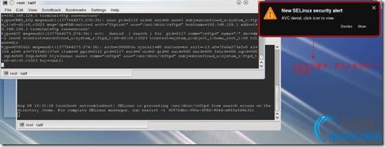

  大家可以看到,根据信息,明确能够了解出现问题的原因,正常情况下,会桌面上出现一个五角星标志
  下面大家来看看上面两个日志是否有区别:
  audit.log
  type=AVC msg=audit(1377664273.274:36): avc: denied { search } for pid=2117 comm=&quot;vsftpd&quot; name=&quot;/&quot; dev=dm-2 ino=2 scontext=unconfined_u:system_r:ftpd_t:s0-s0:c0.c1023 tcontext=system_u:object_r:home_root_t:s0 tclass=dir
  type=SYSCALL msg=audit(1377664273.274:36): arch=c000003e syscall=80 success=no exit=-13 a0=7fe0a273afe0 a1=1f4 a2=0 a3=7fffa8c137e0 items=0 ppid=2112 pid=2117 auid=0 uid=0 gid=0 euid=500 suid=500 fsuid=500 egid=500 sgid=500 fsgid=500 tty=(none) ses=1 comm=&quot;vsftpd&quot; exe=&quot;/usr/sbin/vsftpd&quot; subj=unconfined_u:system_r:ftpd_t:s0-s0:c0.c1023 key=(null)
  可以看到 type=AVC标志。而再来看setroubleshoot

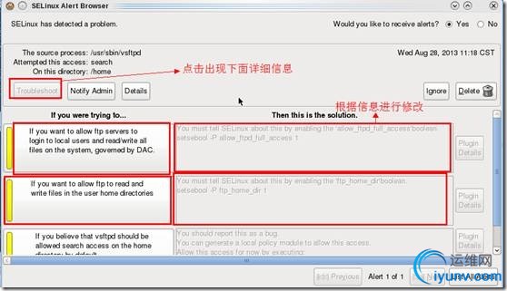

  Aug 28 12:39:26 localhost setroubleshoot: SELinux is preventing /usr/sbin/vsftpd from search access on the directory /home. For complete SELinux messages. run sealert -l 30972dbc-350e-4f82-9044-a8ffafd9e31c
  在setroubleshoot中,能够看到前面localhost主机名之后的setroubleshoot,证明是由setroubleshoot来整理写入。根据上面红色字体部分,我们执行一下看看结果
  ***** Plugin catchall_boolean (47.5 confidence) suggests *******************
  If you want to allow ftp servers to login to local users and read/write all files on the system, governed by DAC.
  Then you must tell SELinux about this by enabling the 'allow_ftpd_full_access'boolean.
  Do
  setsebool -P allow_ftpd_full_access 1
  If you want to allow ftp to read and write files in the user home directories
  Then you must tell SELinux about this by enabling the 'ftp_home_dir'boolean.
  Do
  setsebool -P ftp_home_dir 1
  ***** Plugin catchall (6.38 confidence) suggests ***************************
  If you believe that vsftpd should be allowed search access on the home directory by default.
  Then you should report this as a bug.
  You can generate a local policy module to allow this access.
  Do
  allow this access for now by executing:
  # grep vsftpd /var/log/audit/audit.log | audit2allow -M mypol
  # semodule -i mypol.pp
  相信根据上面的英文说明就应该能够知道该如何做,也会知道出现错误的原因。

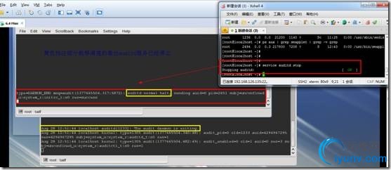

  下面继续进行下一个实验,关闭auditd服务
[root@localhost ~]# service auditd stop
  Stopping auditd: [ OK ]
  接下来我们看看开始提到的setroubleshoot两个进程情况
[root@localhost ~]# ps aux |grep sedispatch | grep -v grep
[root@localhost ~]# ps aux |grep seapplet | grep -v grep
  root 2494 0.0 0.3 217800 7208 ? S 12:43 0:00 /usr/bin/seapplet

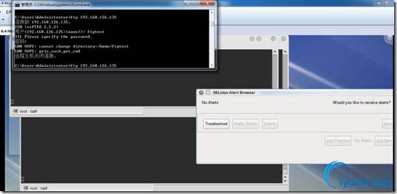

  从上面可以看出,随着auditd的停止,sedispatch也停掉。现在有seapplet继续监管。此时在客户端登录ftp查看情况
  上方日志输出中,可以看出,当auditd停掉,那么审计任务结束,而此时selinux已经开始接管。因为日志后面能够看到另外一个信息标志avc,只是现在无法定论此时日志究竟由何种工具进行监控
