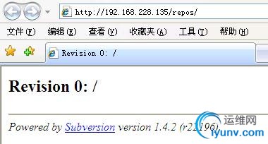

1<Location /repos>2   DAV svn3   SVNPath /var/www/svn/stuff4</Location>重新启动httpd服务后,通过浏览器访问http://ip/repos,即可看到如下界面:
