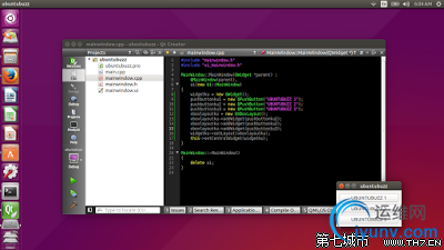

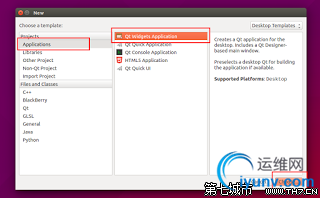

For first usage, you can create a C++ GUI program by using Qt Widget Project option in Qt Creator. Actually, you have so many other project templates, but for the first time you should try this first. Create it by menu New File or Project (Ctrl+N) > select Project > select Qt Widget Application > press Choose button > type your project name > next, next, and finish. To compile your C++/Qt project, press Run button (green triangle icon on the left panel) or just Ctrl+R. See picture below.
Selecting Project
Running Program

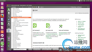

You get also complete Qt API References for whole Qt Framework. To see them, open Qt Creator > click Help icon on the left panel > select Qt 5.x.x Reference from left entry > see documentation on the right panel. You also have all the rest of another Qt related documentation (such as Qt Dbus, Qt Designer, Qt Quick, and many more manuals) on the same left panel. See picture below.
Complete Qt Framework Documentation
