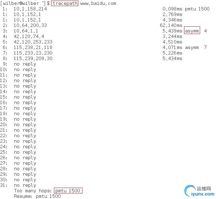

五. tracepath
    该命令同 traceroute 的区别在于,能显示完整的路径 MTU 及对称/非对称信息。

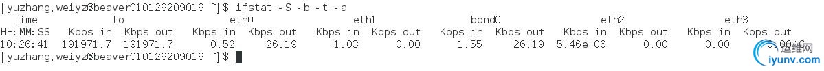

四. ifstat
    interface statistics
    查看网卡流量,相对于 iptraf 等,还是方便很多的,一是支持同时显示多张网卡的流量,二是延时低。
      -l  Enables monitoring of loopback interfaces for which statistics are available. By default, ifstat monitors all non-loopback interfaces that are up.
      -a  Enables monitoring of all interfaces found for which statistics are available.
      -t  Adds a timestamp at the beginning of each line.
      -S  Keep stats updated on the same line if possible (no scrolling nor wrapping).
      -b  Reports bandwith in kbits/sec instead of kbytes/sec.
