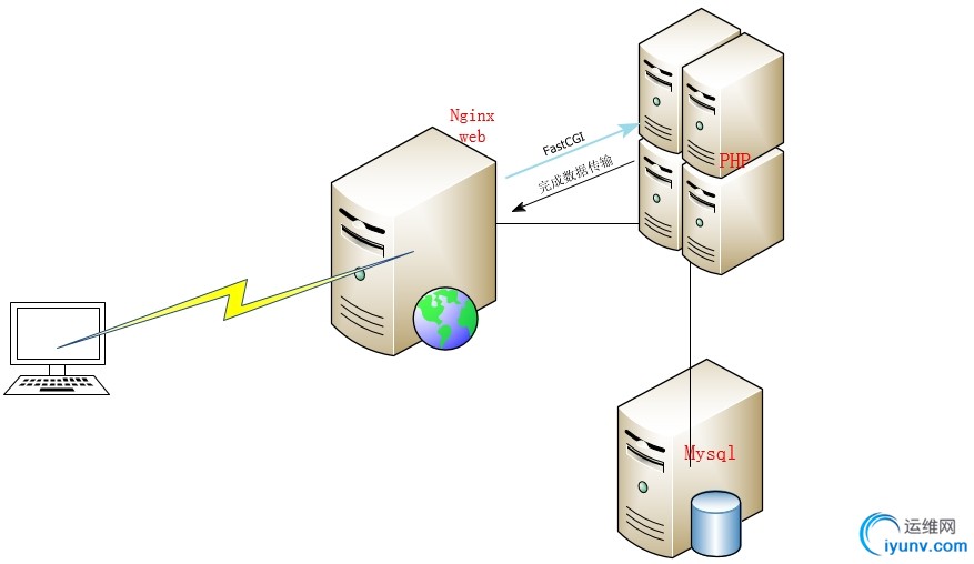

  四、整合nginx和php5
1、编辑/etc/nginx/nginx.conf,启用如下选项:
location ~ \.php$ {
root           html;
fastcgi_pass   127.0.0.1:9000;
fastcgi_index  index.php;
fastcgi_param  SCRIPT_FILENAME  /scripts$fastcgi_script_name;
include        fastcgi_params;
}  2、编辑/etc/nginx/fastcgi_params,将其内容更改为如下内容:
