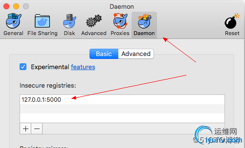

  本地仓库非安全配置
cat .docker/daemon.json
"insecure-registries" : [
"127.0.0.1:5000"
"debug" : true,
"experimental" : true,
"registry-mirrors" : [
"https://8q2dp9p9.mirror.aliyuncs.com"
