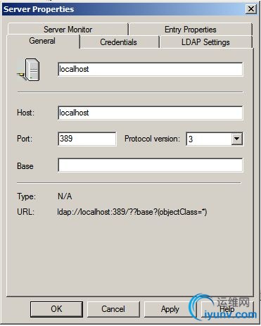

  In order to ease server administration, you can switch to a graphical LDAP client, such as the LDAP Browser/Editor developed , available at: http://www.ldapbrowser.com/

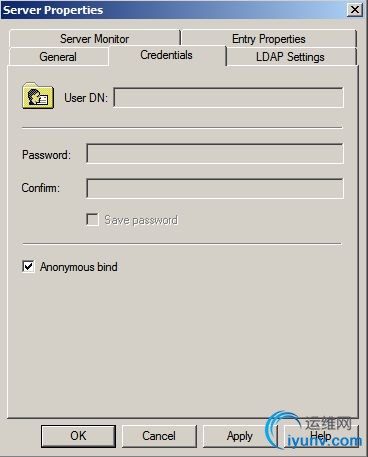

  Start the client and provide connection information:
  The connection must succeed, but an error message is displayed in the status bar: List Failed . This error is expected as there is no entry in the database, double click on the message to get more details.

  Try a new connection with Ldap Browser to check the new entries. A named (i.e. not Anonymous) connection is necessary to add or change entries: uncheck Anonymous Bind and provide User Info.
  According to example configuration, User DN is cn=Manager , check append base DN and use password secret . 不用设置.默认也可以
