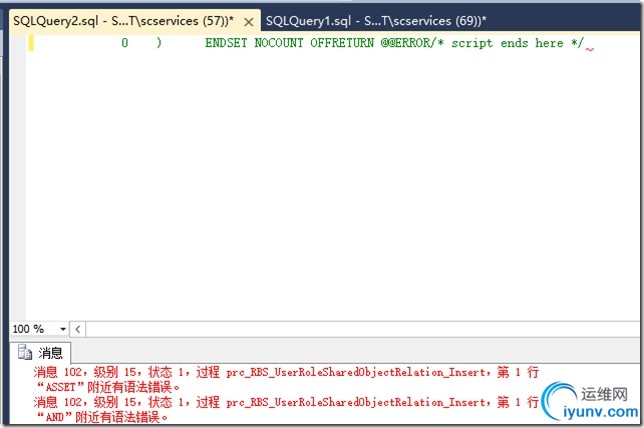

  VMM server和控制台安装都正常。但是在执行文章中提供的SQL脚本:
  /* script starts here */ALTER Procedure [dbo].[prc_RBS_UserRoleSharedObjectRelation_Insert]( @ID uniqueidentifier, @ObjectID uniqueidentifier, @ObjectType int, @RoleID uniqueidentifier, @UserOrGroup varbinary (85), @ForeignAccount nvarchar (256), @IsADGroup bit, @ExistingID uniqueidentifier = NULL OUTPUT)ASSET NOCOUNT ON SELECT @ExistingID = [ID] FROM [dbo].[tbl_RBS_UserRoleSharedObjectRelation] WHERE [ObjectID] = @ObjectID AND [RoleID] = @RoleID AND -- Select owner OR Select all which matches ForeignAccount or UserOrGroup OR -- both ForeignAccount and UserOrGroup is NULL (([UserOrGroup] = @UserOrGroup OR [ForeignAccount] = @ForeignAccount) OR ([UserOrGroup] IS NULL AND @UserOrGroup IS NULL AND [ForeignAccount] IS NULL AND @ForeignAccount IS NULL)) /* Ignore duplicate entries */ IF (@ExistingID IS NULL) BEGIN INSERT [dbo].[tbl_RBS_UserRoleSharedObjectRelation] ([ID] ,[ObjectID] ,[ObjectType] ,[RoleID] ,[UserOrGroup] ,[ForeignAccount] ,[IsADGroup] ,[IsOwner] ) VALUES ( @ID, @ObjectID, @ObjectType, @RoleID, @UserOrGroup, @ForeignAccount, @IsADGroup, 0 ) ENDSET NOCOUNT OFFRETURN @@ERROR/* script ends here */
  时遇到如下错误
  经检查发现是SQL语句有误,该空格没空格,该换行没换行。
  我修改成下面这样后就可以正常执行了
