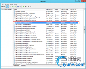

Diagnostic Logs
  HealthManager runs and collects information about the health of the system. If youhave ample space this is fine but if you have an 80GB C:\ drive your drive isgoing to fill up in less than a few days. If you need to disable this featureyou can do so as follows:
  Openup Services.msc,
  •   Locate     the Microsoft Exchange Health Manager Service.
  •   Double     click the service and change the startup to disabled.
  •   Stop     the service if it is running.
  •   The     next service to locate is the Microsoft Exchange Diagnostics Service.
  •   Follow     the same steps as above to stop and disable the service.

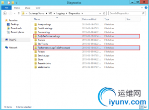

  The next step is toclear out the logs created by Diagnostics. Open up Explorer.
  Navigate toC:\Program Files\Microsoft\Exchange Server\V15\Logging\Diagnostic.
  ·   In there youwill have two folders, one called DailyPerformanceLogs and theother PerformanceLogsToBeProcessed.
  ·   You candelete all the log files located in these two. The logs to beprocessed will contain 20MB files while the daily logs will be +/- 1GB.

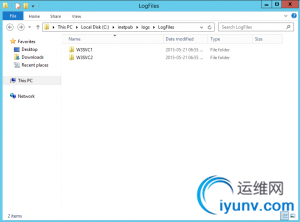

IIS Log Files
  IISLog files write to the C:\inetpub directory by default. You can changethis to another drive, etc. These files can be 200MB+ and overtime will use upspace on the drive. To delete them, open up the following location:
  •   C:\inetpub\logs\LogFiles
  ·   Inside thisfolder you will have two other folders namely W3SVC1 and W3SVC2.Inside these are log files you can delete as well.
  You can also lookin the following folder for the same set of folders: C:\ProgramFiles\Microsoft\Exchange Server\V15\Logging\RpcHttp
  Here you canalso delete these files.
