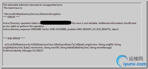

  在安装Exchange的时候遇到一个问题(由于我所安装的环境中是一个较大的AD林域架构,出现问题的是一个子域),通过Exchange安装日志查看报错信息如下:
  [08/17/2016 02:30:55.0619] [2] Active Directory session settings for 'Update-LegacyGwart' are: View Entire Forest: 'True', Configuration Domain Controller: ‘ad01.contoso.com', Preferred Global Catalog: ‘ad01.contoso.com', Preferred Domain Controllers: '{ ad01.contoso.com'}'
  [08/17/2016 02:30:55.0619] [2] Beginning processing Update-LegacyGwart
  [08/17/2016 02:30:55.0868] [2] Used domain controller contoso.com to read object DC=contoso.
  [08/17/2016 02:30:55.0977] [2] [ERROR] Active Directory operation failed on contoso.com. This error is not retriable. Additional information: Insufficient access rights to perform the operation.Active directory response: 00002098: SecErr: DSID-03150BB9, problem 4003 (INSUFF_ACCESS_RIGHTS), data 0
  [08/17/2016 02:30:55.0977] [2] [ERROR] The user has insufficient access rights.
  [08/17/2016 02:30:55.0993] [2] Ending processing Update-LegacyGwart

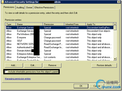

  2、通过查找相关KB,其中有人遇到类似是问题,解决方法是当前安装账户为继续权限。经过我的检查,我遇到问题时,安装账户已经继承了权限。(此方法可以作为一种解决此类问题的一个方法。),具体可以参考:http://www.petenetlive.com/KB/Article/0000719
