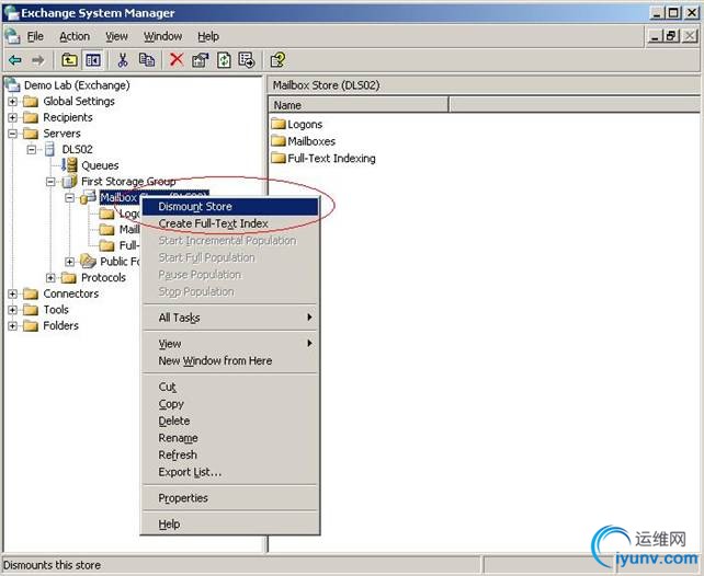

  Alright we’re ready to have the dial-tone database created, so if it’s not already the case you first need to dismount the Mailbox Store that are to be restored from backup. In order to do so open the Exchange System Manager and drill down to the Mailbox Store under the respective Storage Group. Now right-click the Mailbox Store and select Dismount Store as shown in Figure 1 below.
  Figure 1: Dismounting the corrupt Mailbox Store

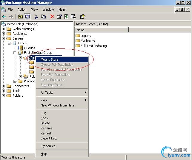

  We’re now ready to create the dial-tone database; this is done by right-clicking the Mailbox Store we dismounted earlier, then selecting Mount Database as seen in Figure 3.
  Figure 3: Creating the Dial-tone Database by mounting the Mailbox Store in Exchange System Manager

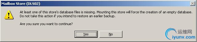

  After a couple of seconds you will be prompted with the dialog box in Figure 4 below.
  Figure 4: Creating the Dial-tone database
  Click Yes and again wait a couple of seconds for the next dialog box to appear then click OK (see Figure 5).

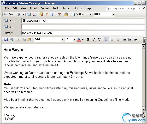

  Now that the users can connect to the Exchange Server again it’s very important you send out an email message informing them what’s going on. Such a message could look something like the one shown in Figure 6 below.
  Figure 6: Status Message to users affected by the Mailbox Store crash

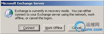

  Now that the dial-tone database has been created, the next time any user with an Outlook 2003 client configured with cached mode logs on, she will be>
  Figure 1: Outlook 2003 Exchange Recovery Mode

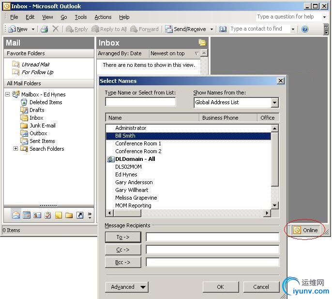

  Outlook 2003 Exchange Recovery Mode lets you choose between Connect and Work Offline, if you click Connect you’re connected with an empty Exchange Mailbox similar to the one shown in Figure 2, that means email messages, rules, signatures, etc are gone, but you’re able to search the Global Address List (GAL) as well as send and receive email messages just like was the case before.
  Note:
  Be aware previous Outlook versions don’t receive the dialog box shown in Figure 1. Instead a user who chooses to work online will, in most cases, end up with an unreadable OST file, because the encryption data associated with the previous mailbox would be overwritten with a new key from the new empty mailbox. It’s therefore recommended to inform any user that accesses his/her mailbox with an earlier version of Outlook to open Outlook in offline mode then export the data to a PST file, which then can be opened or imported when opening Outlook in online mode. For more information I also suggest you read MS KB article: 282496 - Considerations and best practices when resetting an Exchange mailbox database.
  Figure 2: Outlook 2003 in Online Mode accessing a Dial-tone database

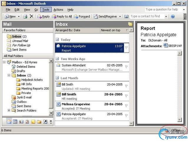

  If you click Work Offline the OST file (which is stored locally on the client) is opened, from here you can access any email message which was synchronized between the Exchange mailbox and the OST file prior to the Mailbox Store crash as shown in Figure 3 below.

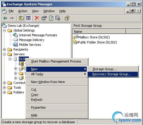

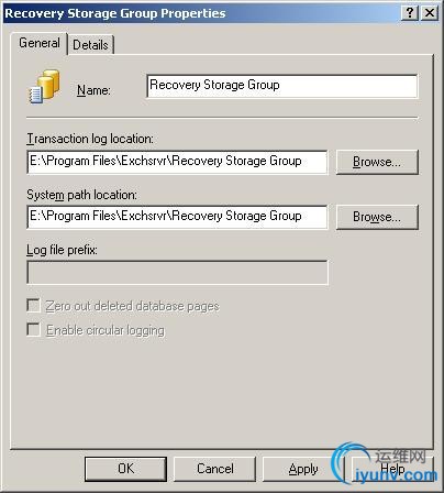

  Figure 4: Creating the Recovery Storage Group
  Specify the drive you want to restore the Mailbox Store to (see Figure 5). If disk space allows it, it’s a good>
  Figure 5: Specifying Log and System Path location
  Click OK.

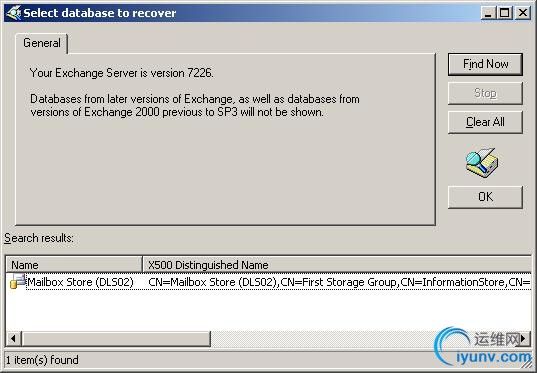

  Now that we have the Recovery Storage Group in place, we need to add the database (the one we want to restore from backup) to this Recovery Storage Group. This is done by right-clicking the Recovery Storage Group, then select Add database to recover, which brings us to the screen shown in Figure 6. Here you should highlight the Mailbox Store you want to restore, then click OK.
  Figure 6: Adding the database to the Recovery Storage Group

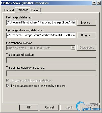

  Here you should just accept the defaults, but make sure This database can be overwritten by a restore is check marked as shown in Figure 8 below, then click OK.
  Figure 8: Specifying the Recovery Storage Group Database location

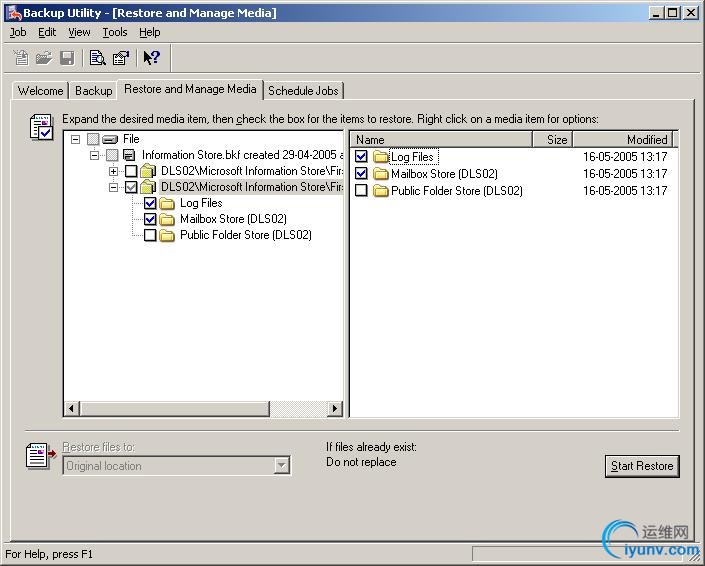

  We’re now ready to restore the Mailbox Store from backup, in this article we’re using NTBackup but if you have implemented a third party product such as Veritas Backup Exec that’s the one to use.

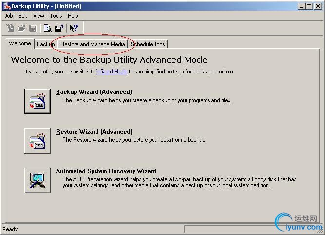

  Start NTBackup by clicking Start > Run and type NTBackup, then select the Restore and Manage Media tab as shown in Figure 9.
  Figure 9: Restore and Manage Media tab in NTBackup
  Note:
  If you don’t get the screen shown in Figure 9 when opening NTBackup, it’s because it starts in Wizard mode. If this is the case remove the checkmark in Always start in wizard mode, exit NTBackup and open it again.
  Now expand File > Information Store.bkf > Server\Microsoft Information Store\First Storage Group and select the respective Mailbox Store as well as Log Files (see Figure 10).
  Figure 10: Expanding and selecting the respective Media item
  Notice the Restore files to: text box has Original location.

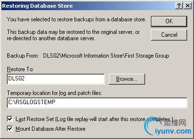

  Click Start Restore then specify the server to restore to and a temporary location for the log and patch files. Also remember to check mark Last Restore Set (Log file replay will start after this restore completes.) and Mount Database After Restore (see Figure 11), then click Next.
  Figure 11: Specifying the server, temporary location for log and patch files

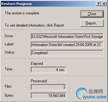

  The restore will now begin and depending on how large the Mailbox Store is this can take several minutes/hours. When the restore is complete simply click Close (see Figure 12) and exit NTBackup.
  Figure 12: Mailbox Store restore complete

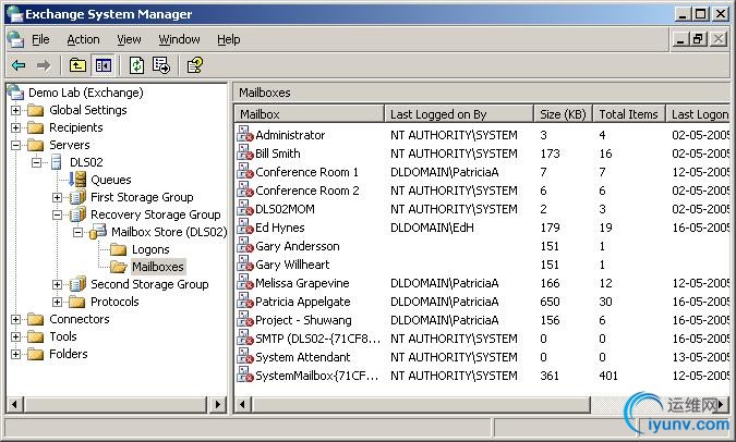

  It’s time to verify the restored Mailbox Store is visible under the Recovery Storage Group in the System Manager as well as check that the respective mailboxes are listed under the Mailboxes container object (see Figure 1).
  Figure 1: Restored Mailbox Store under the Recovery Storage Group as seen in System Manager

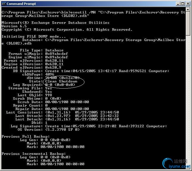

  After restoring a Mailbox Store to the Recovery Storage Group it’s recommended to dismount/mount it once, in order to ensure any required transaction logs have been purged to the database, as well as to make sure the database is in a consistent state. If you belong to the paranoid Exchange Admin’s you can double check the state of the database by running an ESEUTIL /MH C:\Program Files\Exchsrvr\Recovery Storage Group\database.edb against it (remember to do this while it’s dismounted). The line State: should be in a Clean Shutdown state, as is the case in Figure 2.
  Alright now that we have a consistent restore of the original Mailbox store, we’re ready to have it swapped with the dial-tone database currently in production. Actually you could go right away and start to merge the restored Mailbox Store to the dial-tone database, but there are several disadvantages in doing so. The most noteworthy are listed below:

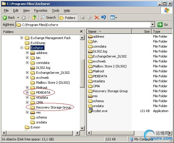

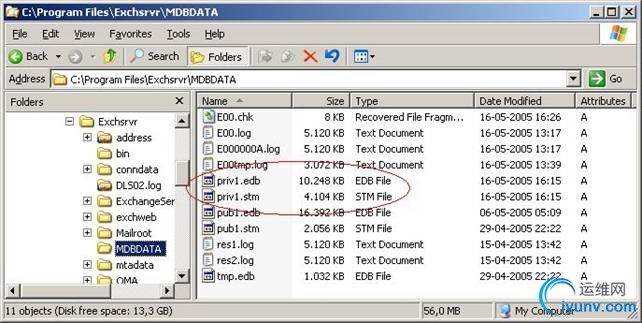

  It’s time to create a folder named NEW (or something else if you prefer) in the folder holding the .EDB and .STM files for the Restored Mailbox Store as well as in the Mailbox Store (Dial-tone database) currently in production, by default the path to each are C:\Program Files\Exchsrvr\Recovery Storage Group and C:\Program Files\Exchsrvr\MDBDATA (shown in Figure 3 below).
  Figure 3: Path to the .EDB and .STM file of each Mailbox Store
  Now move the .EDB and .STM files from the Recovery Storage Group folder to the NEW folder created under the MDBDATA folder. Do the same for the .EDB and .STM files held in the MDBDATA folder; just move them to the NEW folder in the Recovery Storage Group folder instead. When the files have been moved you should move them once again, this time from the NEW folder to the folder above it (that is the Recovery Storage Group and MDBDATA folder). If you get a dialog box asking whether you want to overwrite existing files, it’s because you did a copy and not a move in the previous step. If this is the case just select Yes.

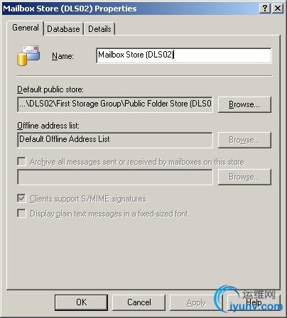

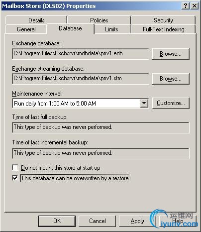

  Back in the System Manager you should open the Properties of each Mailbox Store, select the Database tab and check mark This database can be overwritten by a restore (shown in Figure 4 below).
  Figure 4: Database tab in the Properties of the Mailbox Store

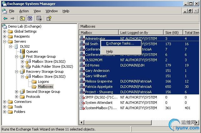

  To merge the Mailboxes from the dial-tone database to the original database restored from backup, drill down to the Recovery Storage Group > Mailbox Store > Mailboxes in the System Manager console. Here you should select the mailboxes that need to be merged, then right-click and select Exchange Tasks in the context menu as shown in Figure 5 below.
  Figure 5: Selecting the Mailboxes that need to be merged

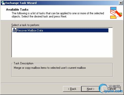

  Now click Next twice (see Figure 6).
  Figure 6: Merge or copy mailbox items to selected user’s current mailbox

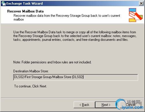

  Make notice of the Destination Mailbox Store and click Next again (see Figure 7).
  Figure 7: Destination Mailbox Store

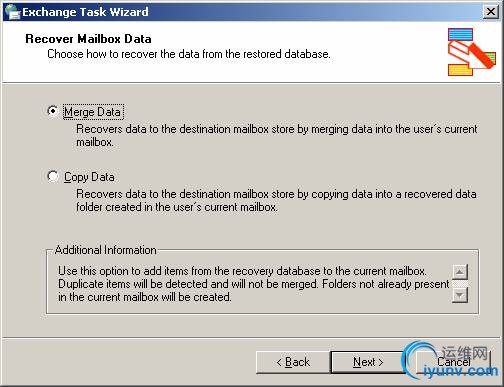

  Select Merge Data then click Next as shown in Figure 8.
  Figure 8: Selecting Merge Data

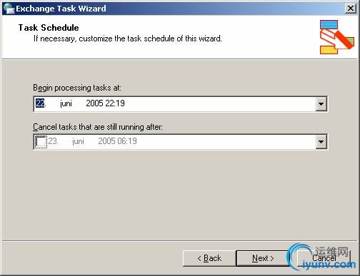

  Schedule the processing task or begin the merging immediately, then click Next (see Figure 9).
  Figure 9: Schedule the processing task

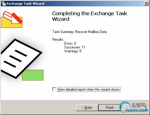

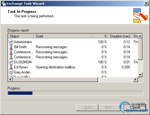

  Let the task finish then click Finish (Figure 10 and 11).
  Figure 10: Task In Progress
  Figure 11: Completing the Exchange Task Wizard

  Figure 3: Outlook 2003 in Offline Mode accessing the local OST file
