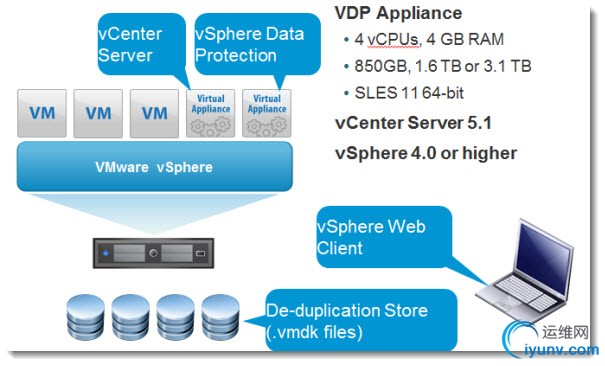

  The VDP is a virtual appliance which is available in 3 sizes for the destination datastores, which will be as in the case of VDR, be used as a deduplication store, to store the backups. So the destination datastore can be configured in 3 sizes:
  - 500Gigs, 1Tb, 2Tb
  The actual virtual appliance which runs the Suse Linux Enterprise Server 11 (SLES)  runs with 4 vCPU and 4 Gigs of RAM. During the deployment process, the thick disks are used, and those disks consume 850 GB (3 .vmdk files), 1600 GB (7 .vmdk files), and 3100 GB (13 .vmdk files) respectively. To create the necessary deduplication destination datastore, which will be used later for the target of the backup jobs.
  The VDP appliance can be managed only by vCenter Server 5.1 through web client. VMware is shifting away of the “thick” client so the management of backups through the vSphere Client is possible only through the new vSphere Web Client. And there is no plugin for the “thick” client anymore…. Curiously, the plugin for vSphere Update manager (VUM) hasn’t been released at the same time, but AFAIK the integration of VUM will follow in the days to come.

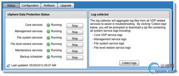

  Here is a screenshot what it looks like just after the deployment of the appliance. The “maintenance mode”.

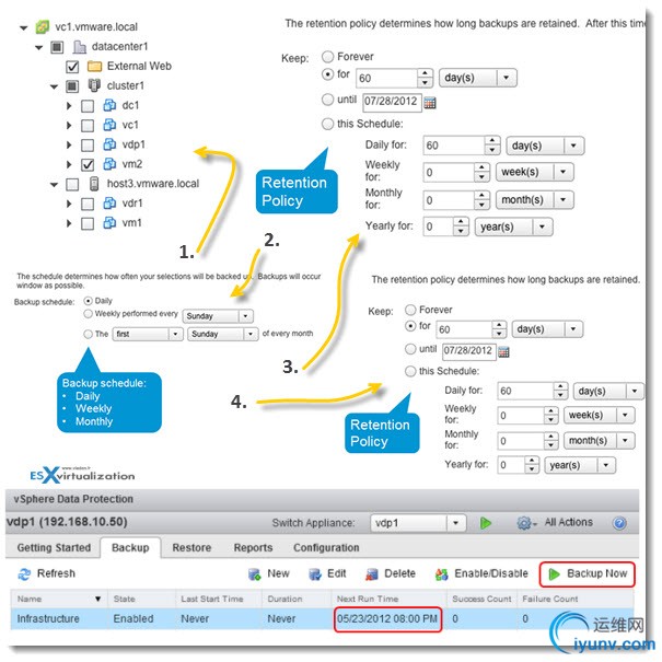

  Backup/restoration jobs and scheduling - those tasks are Wizard driven and permits the configuration of backup job. In the UI There are containers such as data centers, clusters, hosts, folders, etc. An individual VMs can be selected for backup. If new VMs are added to a container that is currently backed up (backup job has already been configured), these new VMs will automatically get backed up on the next run of the backup job.

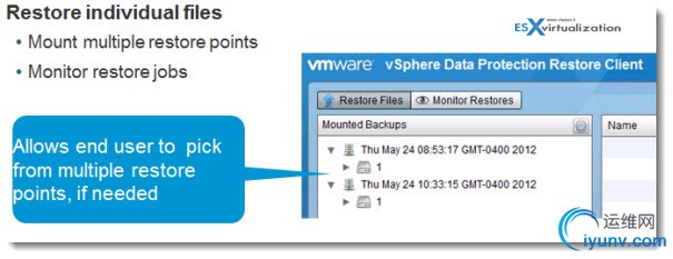

  There are some requirements for the FLR though, like the VMware Tools installed inside of the VMs and the file Systems supported (currently Windows NTFS and Linux LVM, Ext 2, Ext 3 and basic disks – non-extended).
  Monitoring restore jobs – there is a possibility to monitor restore jobs, by clicking the Monitor Resources button, and see the progress of the restore operations.

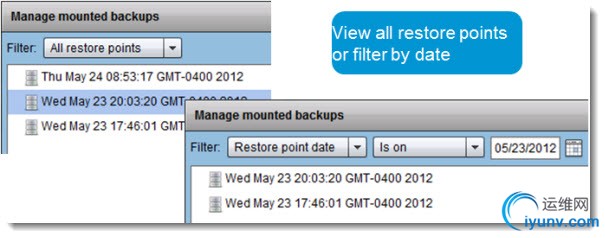

  8 mount points mounted simultaneously – another thing is that you can mount more than one restore point simultaneously (eight maximum), which can helpful if you are not sure of the exact version/date of the file you need to restore.

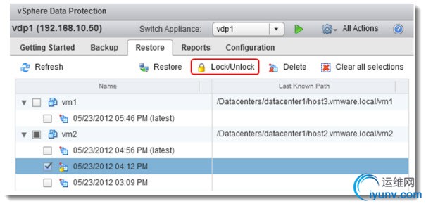

  Locking and unlocking backup images – this might be useful for keeping restore points for archiving purposes.  The restore point is kept even the retention policy says that the restore point should be deleted.

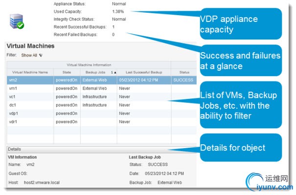

  Reporting capabilities – The VDP has a reporting TAB which provides several pans, which shows each detailed information about the appliance’s status, the status of the backup jobs, the storage capacity, the success (and failures) of backup/restoration jobs.
  There are possibility to create filters on specific criterias like VM, last backup date, last backup job occurred within x number of days, etc.

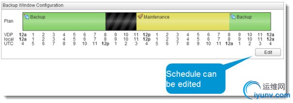

  Backup and Maintenance window – the backup window (Green) runs by default from 8:00 PM to 8:00 AM, the blackout window (Black) blackout window runs from 8:00 AM to 11:00 AM, and the maintenance window (yellow). During backup window the backup jobs can run only. The jobs starts at the beginning of backup window automatically (up to 8 jobs simultaneously – per appliance). If the job overlap the backup window, the job fails.
  When the VDP appliance is first deployed and configured, the maintenance services are disabled for the 24-48 hours.  This allows for a longer backup window to support the initial backups, which are full backups.
      –     What is the Blackout Window? – During the blackout window the Garbage collection deletes orphaned chunks of data that are no longer references within any backups on the system. Only restores can be executed, but no other (including administrative) activity can be performed.
  –     Maintenance window – there are integrity checks, which progress is stored in VDP appliance itself. If the process has not finished at the end of maintenance window, it will be picked up the next day, where it left off. You can also force the Integrity checks manually, but obviously the tasks are Full Integrity Checks.

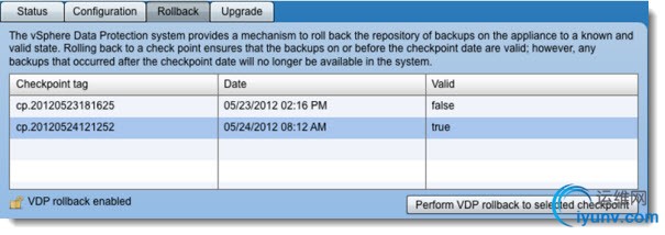

  VDP Rollback and Checkpoints – this feature that I mentioned at the beginning, helps you (if needed) to restore the appliance to the previous point in time (like in windows, the system restore application).
