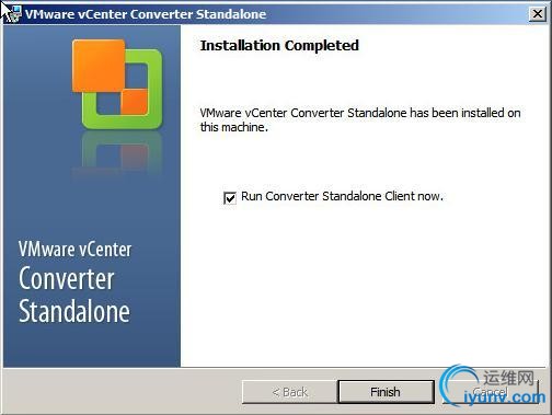

  Click Next, and follow the installation wizard to the end, and Click Finish.
  • VMware vCenter Converter Standalone 5.1 - Finish
  If you left the Tick in the Box for Run Converter Standalone Client now. VMware vCenter Converter Standalone will start, otherwise you will need to click the icon on your desktop.  2   Creating a P2V (V2V in this example) for synchronization

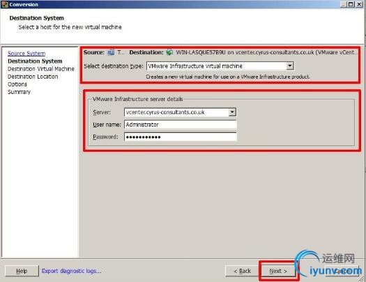

  • VMware vCenter Converter Standalone 5.1 - Specify vCenter Server
  Select destination type: VMware Infrastructure machine
Enter the destination server, username and password, in this example, I'm using our VMware vSphere vCenter server details, but if you wanted to synchronize/replicate to a standalone VMware vSphere Hypervisor (ESXi) host, you would enter the VMware vSphere Hypervisor (ESXi)  host details here, e.g. root username and password.

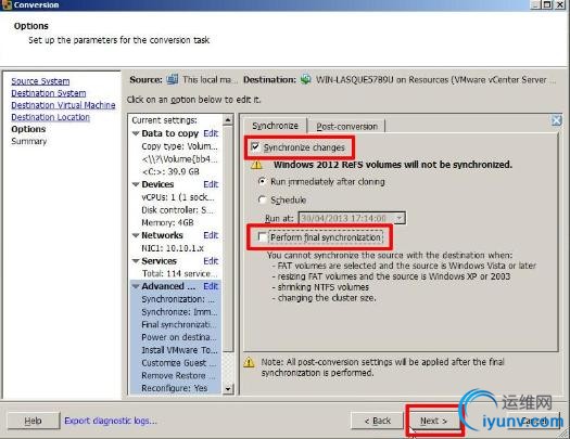

To enable the Synchronize function, you MUST select Edit
  • VMware vCenter Converter Standalone 5.1 - Enable Synchronise
  Ensure Synchronize changes is selected and ticked.
Ensure Perform final synchronization is Un-ticked.
If you wanted to perform, a Scheduled Synchronize, select and set the Schedule Option. Select Next to continue, review the Summary screen, and select Finish.

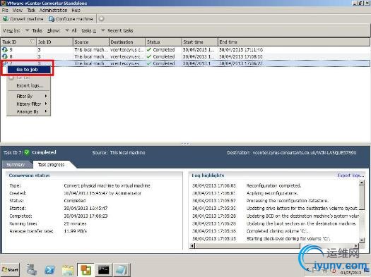

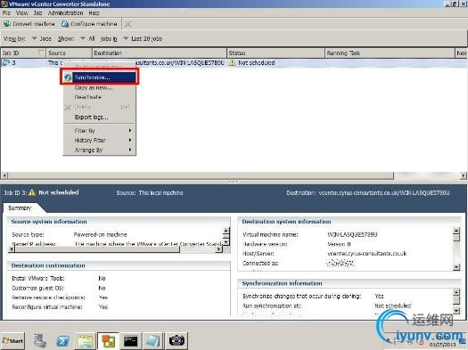

  Once the initial P2V (V2V) conversion has completed, or "seeded" a new virtual machine, you can use the Synchronize function to replicate any changes that occur on the source machine to the virtual machine, the source machine could be a physical or virtual machine. (You can check the virtual machine by disconnecting networking, and powering up the virtual machine).
  • VMware vCenter Converter Standalone 5.1 - Job Status
  The Job Status should state Completed. Right Click the Task Id and select Go to job
  • VMware vCenter Converter Standalone 5.1 - Go to Job

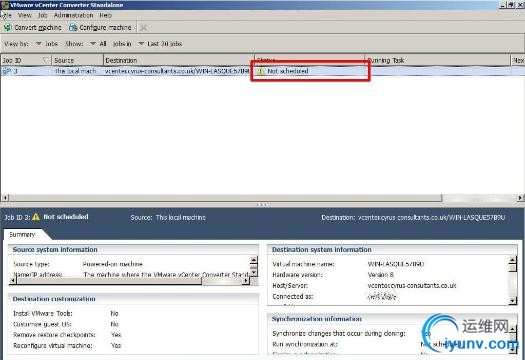

  You will notice that the Status states Not Scheduled, this is because we did not set a schedule.
  • VMware vCenter Converter Standalone 5.1 - Not Scheduled
  Right Click the Job Id, and select Synchronize.
  • VMware vCenter Converter Standalone 5.1 - Synchronize

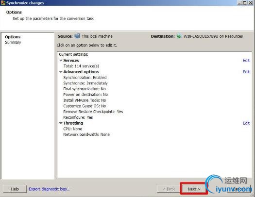

  Click Next

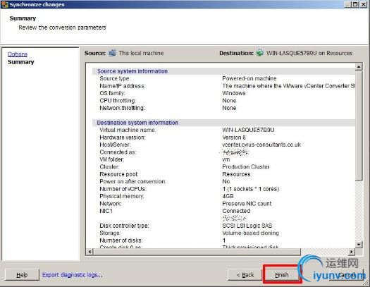

  • VMware vCenter Converter Standalone 5.1 - Synchronize changes
  Check the Summary page and Click Finish
