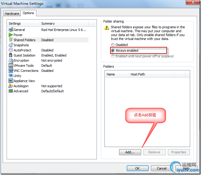

  2:通过共享文件夹功能
  虚拟机VMware提供了在宿主机与虚拟机系统之间交换文件的共享文件夹(Shared Folder)功能。不管虚拟机操作系统是Linux还是Windows都可用。你可以通过设置( Settings)>共享文件夹(Shared Folder)来设置。但是此功能选项必须要安装虚拟机工具(VMware Tools),否则如下所示,否则该功能选项不可用。
  安装虚拟机工具步骤如下所示:
  1:在对应虚拟机的设置选项(Settings)下,为虚拟机光驱指定虚拟机系统的镜像文件。 注意:在执行下面步骤前,必须确保虚拟机的电源开启、虚拟机系统正在运行。
  2:在VM下选择"Install VMware Tools".
   DSC0003.png   然后安装虚拟机组件工具,详细步骤如下所示:
[iyunv@DB-Server ~]# cd /mnt[iyunv@DB-Server mnt]# mkdir cdrom[iyunv@DB-Server mnt]# mount /dev/cdrom  /mnt/cdrom[iyunv@DB-Server mnt]# cd /mnt/cdrom[iyunv@DB-Server cdrom]# cp  VMwareTools-8.8.2-590212.tar.gz /tmp[iyunv@DB-Server cdrom]#tar xz[iyunv@DB-Server tmp]# lsgconfd-root     orbit-root           VMwareTools-8.8.2-590212.tar.gzkeyring-qO15Cg  ssh-EWUeHQ4064       vmware-tools-distribmapping-root    virtual-root.9mZzaq[iyunv@DB-Server tmp]# cd vmware-tools-distrib/[iyunv@DB-Server vmware-tools-distrib]# lsbin  doc  etc  FILES  INSTALL  installer  lib  vmware-install.pl  [iyunv@DB-Server vmware-tools-distrib]# ./vmware-install.pl A previous installation of VMware Tools has been detected. The previous installation was made by the tar installer (version 4). Keeping the tar4 installer database format. You have a version of VMware Tools installed.  Continuing this install will first uninstall the currently installed version.  Do you wish to continue? (yes/no) [yes]  Uninstalling the tar installation of VMware Tools. Stopping services for VMware Tools Stopping VMware Tools services in the virtual machine:   Guest operating system daemon:[  OK  ]   Virtual Printing daemon:[  OK  ]   VMware User Agent (vmware-user):[  OK  ]   Blocking file system:[  OK  ]   Unmounting HGFS shares:[  OK  ]   Guest filesystem driver:[  OK  ]   VM communication interface socket family:[  OK  ]   VM communication interface:[  OK  ] This program previously created the file /usr/lib/vmware-tools/lib64/libconf/etc/pango/pango.modules, and was about to remove it.  Somebody else apparently did it already. File /etc/vmware-tools/vmware-user.desktop is backed up to /etc/vmware-tools/vmware-user.desktop.old.2. File /usr/lib/vmware-tools/lib64/libconf/etc/gtk-2.0/gtk.immodules is backed upto /usr/lib/vmware-tools/lib64/libconf/etc/gtk-2.0/gtk.immodules.old.2. File /usr/lib/vmware-tools/lib64/libconf/etc/gtk-2.0/gdk-pixbuf.loaders is backed up to /usr/lib/vmware-tools/lib64/libconf/etc/gtk-2.0/gdk-pixbuf.loaders.old.2. This program previously created the file /usr/lib/vmware-tools/libconf/etc/gtk-2.0/gdk-pixbuf.loaders, and was about to remove it.  Somebody else apparently did it already. This program previously created the file /usr/lib/vmware-tools/lib64/libconf/etc/pango/pangorc, and was about to remove it.  Somebody else apparently did it already. This program previously created the file /usr/lib/vmware-tools/libconf/etc/gtk-2.0/gtk.immodules, and was about to remove it.  Somebody else apparently did it already. This program previously created the file /usr/lib/vmware-tools/lib64/libconf/etc/pango/pangox.aliases, and was about to remove it.  Somebody else apparently did it already. This program previously created the directory /etc/vmware-tools, and was about to remove it. Since there are files in that directory that this program did notcreate, it will not be removed. File /etc/X11/xorg.conf is backed up to /etc/X11/xorg.conf.old.2. The removal of VMware Tools 8.8.2 build-590212 for Linux completed successfully. Installing VMware Tools. In which directory do you want to install the binary files? [/usr/bin]  What is the directory that contains the init directories (rc0.d/ to rc6.d/)? [/etc/rc.d]  What is the directory that contains the init scripts? [/etc/rc.d/init.d]  In which directory do you want to install the daemon files? [/usr/sbin]  In which directory do you want to install the library files? [/usr/lib/vmware-tools]  In which directory do you want to install the documentation files? [/usr/share/doc/vmware-tools]  The path "/usr/share/doc/vmware-tools" does not exist currently. This program is going to create it, including needed parent directories. Is this what you want? [yes]  The installation of VMware Tools 8.8.2 build-590212 for Linux completed successfully. You can decide to remove this software from your system at any time by invoking the following command: "/usr/bin/vmware-uninstall-tools.pl". Before running VMware Tools for the first time, you need to configure it by invoking the following command: "/usr/bin/vmware-config-tools.pl". Do you want this program to invoke the command for you now? [yes]  Initializing...  Making sure services for VMware Tools are stopped. Stopping VMware Tools services in the virtual machine:   Guest operating system daemon:[  OK  ]   Virtual Printing daemon:[  OK  ]   VMware User Agent (vmware-user):[  OK  ]   Blocking file system:[  OK  ]   Unmounting HGFS shares:[  OK  ]   Guest filesystem driver:[  OK  ]   VM communication interface socket family:[  OK  ]   VM communication interface:[  OK  ]  [EXPERIMENTAL] The VMware FileSystem Sync Driver (vmsync) is a new feature thatcreates backups of virtual machines. Please refer to the VMware Knowledge Base for more details on this capability. Do you wish to enable this feature? [no] no  Before you can compile modules, you need to have the following installed...  makegcckernel headers of the running kernel  Searching for GCC...Detected GCC binary at "/usr/bin/gcc".The path "/usr/bin/gcc" appears to be a valid path to the gcc binary.Would you like to change it? [no] no Searching for a valid kernel header path...Detected the kernel headers at "/lib/modules/2.6.32-200.13.1.el5uek/build/include".The path "/lib/modules/2.6.32-200.13.1.el5uek/build/include" appears to be a valid path to the 2.6.32-200.13.1.el5uek kernel headers.Would you like to change it? [no]  Using 2.6.x kernel build system.make: Entering directory `/tmp/vmware-root/modules/vmci-only'make -C /lib/modules/2.6.32-200.13.1.el5uek/build/include/.. SUBDIRS=$PWD SRCROOT=$PWD/. \          MODULEBUILDDIR= modulesmake[1]: Entering directory `/usr/src/kernels/2.6.32-200.13.1.el5uek'  CC [M]  /tmp/vmware-root/modules/vmci-only/linux/driver.o  CC [M]  /tmp/vmware-root/modules/vmci-only/linux/vmciKernelIf.o  CC [M]  /tmp/vmware-root/modules/vmci-only/common/vmciContext.o  CC [M]  /tmp/vmware-root/modules/vmci-only/common/vmciDatagram.o  CC [M]  /tmp/vmware-root/modules/vmci-only/common/vmciDoorbell.o  CC [M]  /tmp/vmware-root/modules/vmci-only/common/vmciDriver.o  CC [M]  /tmp/vmware-root/modules/vmci-only/common/vmciEvent.o  CC [M]  /tmp/vmware-root/modules/vmci-only/common/vmciHashtable.o  CC [M]  /tmp/vmware-root/modules/vmci-only/common/vmciQPair.o  CC [M]  /tmp/vmware-root/modules/vmci-only/common/vmciQueuePair.o  CC [M]  /tmp/vmware-root/modules/vmci-only/common/vmciResource.o  CC [M]  /tmp/vmware-root/modules/vmci-only/common/vmciRoute.o  CC [M]  /tmp/vmware-root/modules/vmci-only/driverLog.o  LD [M]  /tmp/vmware-root/modules/vmci-only/vmci.o  Building modules, stage 2.  MODPOST 1 modules  CC      /tmp/vmware-root/modules/vmci-only/vmci.mod.o  LD [M]  /tmp/vmware-root/modules/vmci-only/vmci.ko.unsigned  NO SIGN [M] /tmp/vmware-root/modules/vmci-only/vmci.komake[1]: Leaving directory `/usr/src/kernels/2.6.32-200.13.1.el5uek'make -C $PWD SRCROOT=$PWD/. \          MODULEBUILDDIR= postbuildmake[1]: Entering directory `/tmp/vmware-root/modules/vmci-only'make[1]: `postbuild' is up to date.make[1]: Leaving directory `/tmp/vmware-root/modules/vmci-only'cp -f vmci.ko ./../vmci.omake: Leaving directory `/tmp/vmware-root/modules/vmci-only' Using 2.6.x kernel build system.make: Entering directory `/tmp/vmware-root/modules/vmci-only'make -C /lib/modules/2.6.32-200.13.1.el5uek/build/include/.. SUBDIRS=$PWD SRCROOT=$PWD/. \          MODULEBUILDDIR= modulesmake[1]: Entering directory `/usr/src/kernels/2.6.32-200.13.1.el5uek'  CC [M]  /tmp/vmware-root/modules/vmci-only/linux/driver.o  CC [M]  /tmp/vmware-root/modules/vmci-only/linux/vmciKernelIf.o  CC [M]  /tmp/vmware-root/modules/vmci-only/common/vmciContext.o  CC [M]  /tmp/vmware-root/modules/vmci-only/common/vmciDatagram.o  CC [M]  /tmp/vmware-root/modules/vmci-only/common/vmciDoorbell.o  CC [M]  /tmp/vmware-root/modules/vmci-only/common/vmciDriver.o  CC [M]  /tmp/vmware-root/modules/vmci-only/common/vmciEvent.o  CC [M]  /tmp/vmware-root/modules/vmci-only/common/vmciHashtable.o  CC [M]  /tmp/vmware-root/modules/vmci-only/common/vmciQPair.o  CC [M]  /tmp/vmware-root/modules/vmci-only/common/vmciQueuePair.o  CC [M]  /tmp/vmware-root/modules/vmci-only/common/vmciResource.o  CC [M]  /tmp/vmware-root/modules/vmci-only/common/vmciRoute.o  CC [M]  /tmp/vmware-root/modules/vmci-only/driverLog.o  LD [M]  /tmp/vmware-root/modules/vmci-only/vmci.o  Building modules, stage 2.  MODPOST 1 modules  CC      /tmp/vmware-root/modules/vmci-only/vmci.mod.o  LD [M]  /tmp/vmware-root/modules/vmci-only/vmci.ko.unsigned  NO SIGN [M] /tmp/vmware-root/modules/vmci-only/vmci.komake[1]: Leaving directory `/usr/src/kernels/2.6.32-200.13.1.el5uek'make -C $PWD SRCROOT=$PWD/. \          MODULEBUILDDIR= postbuildmake[1]: Entering directory `/tmp/vmware-root/modules/vmci-only'make[1]: `postbuild' is up to date.make[1]: Leaving directory `/tmp/vmware-root/modules/vmci-only'cp -f vmci.ko ./../vmci.omake: Leaving directory `/tmp/vmware-root/modules/vmci-only'Using 2.6.x kernel build system.make: Entering directory `/tmp/vmware-root/modules/vsock-only'make -C /lib/modules/2.6.32-200.13.1.el5uek/build/include/.. SUBDIRS=$PWD SRCROOT=$PWD/. \          MODULEBUILDDIR= modulesmake[1]: Entering directory `/usr/src/kernels/2.6.32-200.13.1.el5uek'  CC [M]  /tmp/vmware-root/modules/vsock-only/linux/af_vsock.o  CC [M]  /tmp/vmware-root/modules/vsock-only/linux/notify.o  CC [M]  /tmp/vmware-root/modules/vsock-only/linux/notifyQState.o  CC [M]  /tmp/vmware-root/modules/vsock-only/linux/stats.o  CC [M]  /tmp/vmware-root/modules/vsock-only/linux/util.o  CC [M]  /tmp/vmware-root/modules/vsock-only/linux/vsockAddr.o  CC [M]  /tmp/vmware-root/modules/vsock-only/driverLog.o  LD [M]  /tmp/vmware-root/modules/vsock-only/vsock.o  Building modules, stage 2.  MODPOST 1 modules  CC      /tmp/vmware-root/modules/vsock-only/vsock.mod.o  LD [M]  /tmp/vmware-root/modules/vsock-only/vsock.ko.unsigned  NO SIGN [M] /tmp/vmware-root/modules/vsock-only/vsock.komake[1]: Leaving directory `/usr/src/kernels/2.6.32-200.13.1.el5uek'make -C $PWD SRCROOT=$PWD/. \          MODULEBUILDDIR= postbuildmake[1]: Entering directory `/tmp/vmware-root/modules/vsock-only'make[1]: `postbuild' is up to date.make[1]: Leaving directory `/tmp/vmware-root/modules/vsock-only'cp -f vsock.ko ./../vsock.omake: Leaving directory `/tmp/vmware-root/modules/vsock-only' Using 2.6.x kernel build system.make: Entering directory `/tmp/vmware-root/modules/vmxnet3-only'make -C /lib/modules/2.6.32-200.13.1.el5uek/build/include/.. SUBDIRS=$PWD SRCROOT=$PWD/. \          MODULEBUILDDIR= modulesmake[1]: Entering directory `/usr/src/kernels/2.6.32-200.13.1.el5uek'  CC [M]  /tmp/vmware-root/modules/vmxnet3-only/vmxnet3_drv.o  CC [M]  /tmp/vmware-root/modules/vmxnet3-only/vmxnet3_ethtool.o  CC [M]  /tmp/vmware-root/modules/vmxnet3-only/vmxnet3_shm.o  LD [M]  /tmp/vmware-root/modules/vmxnet3-only/vmxnet3.o  Building modules, stage 2.  MODPOST 1 modules  CC      /tmp/vmware-root/modules/vmxnet3-only/vmxnet3.mod.o  LD [M]  /tmp/vmware-root/modules/vmxnet3-only/vmxnet3.ko.unsigned  NO SIGN [M] /tmp/vmware-root/modules/vmxnet3-only/vmxnet3.komake[1]: Leaving directory `/usr/src/kernels/2.6.32-200.13.1.el5uek'make -C $PWD SRCROOT=$PWD/. \          MODULEBUILDDIR= postbuildmake[1]: Entering directory `/tmp/vmware-root/modules/vmxnet3-only'make[1]: `postbuild' is up to date.make[1]: Leaving directory `/tmp/vmware-root/modules/vmxnet3-only'cp -f vmxnet3.ko ./../vmxnet3.omake: Leaving directory `/tmp/vmware-root/modules/vmxnet3-only' The module pvscsi has already been installed on this system by another installer or package and will not be modified by this installer.  Use the flag --clobber-kernel-modules=pvscsi to override. The module vmmemctl has already been installed on this system by another installer or package and will not be modified by this installer.  Use the flag --clobber-kernel-modules=vmmemctl to override. The VMware Host-Guest Filesystem allows for shared folders between the host OS and the guest OS in a Fusion or Workstation virtual environment.  Do you wish to enable this feature? [yes]  Using 2.6.x kernel build system.make: Entering directory `/tmp/vmware-root/modules/vmci-only'make -C /lib/modules/2.6.32-200.13.1.el5uek/build/include/.. SUBDIRS=$PWD SRCROOT=$PWD/. \          MODULEBUILDDIR= modulesmake[1]: Entering directory `/usr/src/kernels/2.6.32-200.13.1.el5uek'  CC [M]  /tmp/vmware-root/modules/vmci-only/linux/driver.o  CC [M]  /tmp/vmware-root/modules/vmci-only/linux/vmciKernelIf.o  CC [M]  /tmp/vmware-root/modules/vmci-only/common/vmciContext.o  CC [M]  /tmp/vmware-root/modules/vmci-only/common/vmciDatagram.o  CC [M]  /tmp/vmware-root/modules/vmci-only/common/vmciDoorbell.o  CC [M]  /tmp/vmware-root/modules/vmci-only/common/vmciDriver.o  CC [M]  /tmp/vmware-root/modules/vmci-only/common/vmciEvent.o  CC [M]  /tmp/vmware-root/modules/vmci-only/common/vmciHashtable.o  CC [M]  /tmp/vmware-root/modules/vmci-only/common/vmciQPair.o  CC [M]  /tmp/vmware-root/modules/vmci-only/common/vmciQueuePair.o  CC [M]  /tmp/vmware-root/modules/vmci-only/common/vmciResource.o  CC [M]  /tmp/vmware-root/modules/vmci-only/common/vmciRoute.o  CC [M]  /tmp/vmware-root/modules/vmci-only/driverLog.o  LD [M]  /tmp/vmware-root/modules/vmci-only/vmci.o  Building modules, stage 2.  MODPOST 1 modules  CC      /tmp/vmware-root/modules/vmci-only/vmci.mod.o  LD [M]  /tmp/vmware-root/modules/vmci-only/vmci.ko.unsigned  NO SIGN [M] /tmp/vmware-root/modules/vmci-only/vmci.komake[1]: Leaving directory `/usr/src/kernels/2.6.32-200.13.1.el5uek'make -C $PWD SRCROOT=$PWD/. \          MODULEBUILDDIR= postbuildmake[1]: Entering directory `/tmp/vmware-root/modules/vmci-only'make[1]: `postbuild' is up to date.make[1]: Leaving directory `/tmp/vmware-root/modules/vmci-only'cp -f vmci.ko ./../vmci.omake: Leaving directory `/tmp/vmware-root/modules/vmci-only'Using 2.6.x kernel build system.make: Entering directory `/tmp/vmware-root/modules/vmhgfs-only'make -C /lib/modules/2.6.32-200.13.1.el5uek/build/include/.. SUBDIRS=$PWD SRCROOT=$PWD/. \          MODULEBUILDDIR= modulesmake[1]: Entering directory `/usr/src/kernels/2.6.32-200.13.1.el5uek'  CC [M]  /tmp/vmware-root/modules/vmhgfs-only/backdoor.o  CC [M]  /tmp/vmware-root/modules/vmhgfs-only/backdoorGcc64.o  CC [M]  /tmp/vmware-root/modules/vmhgfs-only/bdhandler.o  CC [M]  /tmp/vmware-root/modules/vmhgfs-only/cpName.o  CC [M]  /tmp/vmware-root/modules/vmhgfs-only/cpNameLinux.o  CC [M]  /tmp/vmware-root/modules/vmhgfs-only/cpNameLite.o  CC [M]  /tmp/vmware-root/modules/vmhgfs-only/dentry.o  CC [M]  /tmp/vmware-root/modules/vmhgfs-only/dir.o  CC [M]  /tmp/vmware-root/modules/vmhgfs-only/file.o  CC [M]  /tmp/vmware-root/modules/vmhgfs-only/filesystem.o  CC [M]  /tmp/vmware-root/modules/vmhgfs-only/fsutil.o  CC [M]  /tmp/vmware-root/modules/vmhgfs-only/hgfsBd.o  CC [M]  /tmp/vmware-root/modules/vmhgfs-only/hgfsEscape.o  CC [M]  /tmp/vmware-root/modules/vmhgfs-only/hgfsUtil.o  CC [M]  /tmp/vmware-root/modules/vmhgfs-only/inode.o  CC [M]  /tmp/vmware-root/modules/vmhgfs-only/link.o  CC [M]  /tmp/vmware-root/modules/vmhgfs-only/message.o  CC [M]  /tmp/vmware-root/modules/vmhgfs-only/module.o  CC [M]  /tmp/vmware-root/modules/vmhgfs-only/page.o  CC [M]  /tmp/vmware-root/modules/vmhgfs-only/request.o  CC [M]  /tmp/vmware-root/modules/vmhgfs-only/rpcout.o  CC [M]  /tmp/vmware-root/modules/vmhgfs-only/stubs.o  CC [M]  /tmp/vmware-root/modules/vmhgfs-only/super.o  CC [M]  /tmp/vmware-root/modules/vmhgfs-only/tcp.o  CC [M]  /tmp/vmware-root/modules/vmhgfs-only/transport.o  CC [M]  /tmp/vmware-root/modules/vmhgfs-only/vmci.o  CC [M]  /tmp/vmware-root/modules/vmhgfs-only/kernelStubsLinux.o  LD [M]  /tmp/vmware-root/modules/vmhgfs-only/vmhgfs.o  Building modules, stage 2.  MODPOST 1 modules  CC      /tmp/vmware-root/modules/vmhgfs-only/vmhgfs.mod.o  LD [M]  /tmp/vmware-root/modules/vmhgfs-only/vmhgfs.ko.unsigned  NO SIGN [M] /tmp/vmware-root/modules/vmhgfs-only/vmhgfs.komake[1]: Leaving directory `/usr/src/kernels/2.6.32-200.13.1.el5uek'make -C $PWD SRCROOT=$PWD/. \          MODULEBUILDDIR= postbuildmake[1]: Entering directory `/tmp/vmware-root/modules/vmhgfs-only'make[1]: `postbuild' is up to date.make[1]: Leaving directory `/tmp/vmware-root/modules/vmhgfs-only'cp -f vmhgfs.ko ./../vmhgfs.omake: Leaving directory `/tmp/vmware-root/modules/vmhgfs-only' Using 2.6.x kernel build system.make: Entering directory `/tmp/vmware-root/modules/vmxnet-only'make -C /lib/modules/2.6.32-200.13.1.el5uek/build/include/.. SUBDIRS=$PWD SRCROOT=$PWD/. \          MODULEBUILDDIR= modulesmake[1]: Entering directory `/usr/src/kernels/2.6.32-200.13.1.el5uek'  CC [M]  /tmp/vmware-root/modules/vmxnet-only/vmxnet.o  Building modules, stage 2.  MODPOST 1 modules  CC      /tmp/vmware-root/modules/vmxnet-only/vmxnet.mod.o  LD [M]  /tmp/vmware-root/modules/vmxnet-only/vmxnet.ko.unsigned  NO SIGN [M] /tmp/vmware-root/modules/vmxnet-only/vmxnet.komake[1]: Leaving directory `/usr/src/kernels/2.6.32-200.13.1.el5uek'make -C $PWD SRCROOT=$PWD/. \          MODULEBUILDDIR= postbuildmake[1]: Entering directory `/tmp/vmware-root/modules/vmxnet-only'make[1]: `postbuild' is up to date.make[1]: Leaving directory `/tmp/vmware-root/modules/vmxnet-only'cp -f vmxnet.ko ./../vmxnet.omake: Leaving directory `/tmp/vmware-root/modules/vmxnet-only' Using 2.6.x kernel build system.make: Entering directory `/tmp/vmware-root/modules/vmblock-only'make -C /lib/modules/2.6.32-200.13.1.el5uek/build/include/.. SUBDIRS=$PWD SRCROOT=$PWD/. \          MODULEBUILDDIR= modulesmake[1]: Entering directory `/usr/src/kernels/2.6.32-200.13.1.el5uek'  CC [M]  /tmp/vmware-root/modules/vmblock-only/linux/block.o  CC [M]  /tmp/vmware-root/modules/vmblock-only/linux/control.o  CC [M]  /tmp/vmware-root/modules/vmblock-only/linux/dbllnklst.o  CC [M]  /tmp/vmware-root/modules/vmblock-only/linux/dentry.o  CC [M]  /tmp/vmware-root/modules/vmblock-only/linux/file.o  CC [M]  /tmp/vmware-root/modules/vmblock-only/linux/filesystem.o  CC [M]  /tmp/vmware-root/modules/vmblock-only/linux/inode.o  CC [M]  /tmp/vmware-root/modules/vmblock-only/linux/module.o  CC [M]  /tmp/vmware-root/modules/vmblock-only/linux/stubs.o  CC [M]  /tmp/vmware-root/modules/vmblock-only/linux/super.o  LD [M]  /tmp/vmware-root/modules/vmblock-only/vmblock.o  Building modules, stage 2.  MODPOST 1 modules  CC      /tmp/vmware-root/modules/vmblock-only/vmblock.mod.o  LD [M]  /tmp/vmware-root/modules/vmblock-only/vmblock.ko.unsigned  NO SIGN [M] /tmp/vmware-root/modules/vmblock-only/vmblock.komake[1]: Leaving directory `/usr/src/kernels/2.6.32-200.13.1.el5uek'make -C $PWD SRCROOT=$PWD/. \          MODULEBUILDDIR= postbuildmake[1]: Entering directory `/tmp/vmware-root/modules/vmblock-only'make[1]: `postbuild' is up to date.make[1]: Leaving directory `/tmp/vmware-root/modules/vmblock-only'cp -f vmblock.ko ./../vmblock.omake: Leaving directory `/tmp/vmware-root/modules/vmblock-only' !!! [EXPERIMENTAL] !!!VMware automatic kernel modules enables automatic building and installation ofVMware kernel modules at boot they are not already present.  By selecting yes,you will be enabling this experimental feature.  You can always disable thisfeature by re-running vmware-config-tools.pl. Would you like to enable VMware automatic kernel modules?[no] no   Detected X version 7.1   Do you want to change the starting screen display size? (yes/no) [no]   X is running fine with the new config file. Creating a new initrd boot image for the kernel.   Checking acpi hot plug[  OK  ]Starting VMware Tools services in the virtual machine:   Switching to guest configuration:[  OK  ]   VM communication interface:[  OK  ]   VM communication interface socket family:[  OK  ]   Guest filesystem driver:[  OK  ]   Mounting HGFS shares:[  OK  ]   Blocking file system:[  OK  ]   Guest operating system daemon:[  OK  ]   Virtual Printing daemon:[  OK  ]The configuration of VMware Tools 8.8.2 build-590212 for Linux for this runningkernel completed successfully. You must restart your X session before any mouse or graphics changes take effect. You can now run VMware Tools by invoking "/usr/bin/vmware-toolbox-cmd" from thecommand line or by invoking "/usr/bin/vmware-toolbox" from the command line during an X server session. To enable advanced X features (e.g., guest resolution fit, drag and drop, and file and text copy/paste), you will need to do one (or more) of the following:1. Manually start /usr/bin/vmware-user2. Log out and log back into your desktop session; and,3. Restart your X session. Enjoy, --the VMware team  官网关于手工安装升级虚拟机的文档如下所示:
Manually Install or Upgrade VMware Tools in a Linux Virtual Machine For Linux virtual machines, you manually install or upgrade VMware Tools by using the command line. Install the latest version of VMware Tools to enhance the performance of the virtual machine's guest operating system and improve virtual machine management. When you power on a virtual machine, if a new version of VMware Tools is available, you see a notification in the status bar of the guest operating system. Prerequisites ■ Power on the virtual machine.  ■ Verify that the guest operating system is running.  ■ Because the VMware Tools installer is written in Perl, verify that Perl is installed in the guest operating system.  Procedure 1 On the host, from the Workstation menu bar, select VM > Manage > Install VMware Tools.  If an earlier version of VMware Tools is installed, the menu item is Update VMware Tools. 2 In the virtual machine, log in to the guest operating system as root and open a terminal window.  3 Run the mount command with no arguments to determine whether your Linux distribution automatically mounted the VMware Tools virtual CD-ROM image.  If the CD-ROM device is mounted, the CD-ROM device and its mount point are listed as something like this: /dev/cdrom on /mnt/cdrom type iso9660 (ro,nosuid,nodev)4 If the VMware Tools virtual CD-ROM image is not mounted, mount the CD-ROM drive.  a If a mount point directory does not already exist, create it.  mkdir /mnt/cdromSome Linux distributions use different mount point names. For example, on some distributions the mount point is /media/VMware Tools rather than /mnt/cdrom. Modify the command to reflect the conventions that your distribution uses. b Mount the CD-ROM drive.  mount /dev/cdrom /mnt/cdromSome Linux distributions use different device names or organize the /dev directory differently. If your CD-ROM drive is not /dev/cdrom or if the mount point for a CD-ROM is not /mnt/cdrom, modify the command to reflect the conventions that your distribution uses. 5 Change to a working directory (for example, /tmp).  cd /tmp 6 Delete any previous vmware-tools-distrib directory before you install VMware Tools.  The location of this directory depends on where you placed it during the previous installation. Often this directory is placed in /tmp/vmware-tools-distrib. 7 List the contents of the mount point directory and note the filename of the VMware Tools tar installer.  ls mount-point8 Uncompress the installer.  tar zxpf /mnt/cdrom/VMwareTools-x.x.x-yyyy.tar.gzThe value x.x.x is the product version number, and yyyy is the build number of the product release. If you attempt to install a tar installation over an RPM installation, or the reverse, the installer detects the previous installation and must convert the installer database format before continuing. 9 If necessary, unmount the CD-ROM image.  umount /dev/cdrom If your Linux distribution automatically mounted the CD-ROM, you do not need to unmount the image. 10 Run the installer and configure VMware Tools.  cd vmware-tools-distrib./vmware-install.plUsually, the vmware-config-tools.pl configuration file runs after the installer file finishes running. 11 Respond to the prompts by pressing Enter to accept the default values, if appropriate for your configuration.  12 Follow the instructions at the end of the script.  Depending on the features you use, these instructions can include restarting the X session, restarting networking, logging in again, and starting the VMware User process. You can alternatively reboot the guest operating system to accomplish all these tasks. What to do next If a new virtual hardware version is available for the virtual machine, upgrade the virtual hardware.

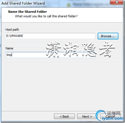

  然后在Options > Shared Folders下选择“Always enabled"选项。当然你也可以选择"Enabled until next power off or suspend"选项
  此时在/mnt/hgfs下就会有一个tmp目录,在主机往E:\VMWARE下拷贝文件就能在Linux系统/mnt/hgfs/tmp目录下访问这些文件了。

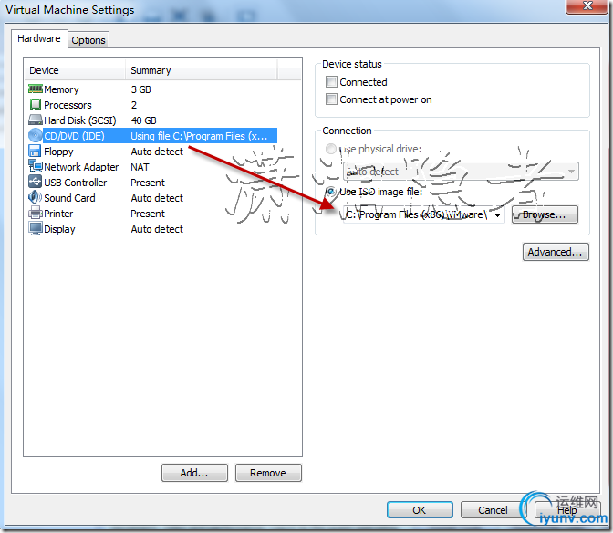

  4:利用虚拟光驱共享文件
  这种方法有点奇葩,第一次见到这种共享文件的方法,我当时的反应就是居然可以这样共享文件。其实就是利用软件将文件打包成镜像文件,然后在虚拟机设置(Settings)——“CD/DVD(IDE)”里面指定ISO镜像文件位置。 这种方法适用于虚拟机系统是Linux、Windows系统。不足之处就是只能从主机拷贝文件到虚拟机,不能从虚拟机拷贝文件到主机,而且折腾起来相当麻烦。
