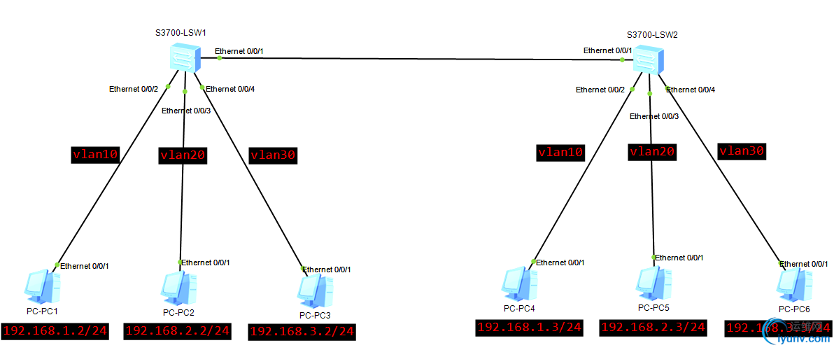

  配置SW1的vlan
  <Huawei>
  <Huawei>language-mode Chinese  //修改提示语言为中文
  Changelanguage mode, confirm? [Y/N] y
  提示:改变语言模式成功。
  <Huawei>undo terminal monitor  //关闭终端显示信息
  Info:Current terminal monitor is off.
  <Huawei>system-view
  Entersystem view, return user view with Ctrl+Z.
  [Huawei]sysname SW1
  [SW1]vlan 10
  [SW1-vlan10]vlan 20
  [SW1-vlan20]vlan 30
  [SW1-vlan30]qu
  [SW1]int e0/0/2
  [SW1-Ethernet0/0/2]port link-type access
  [SW1-Ethernet0/0/2]port default vlan 10
  [SW1-Ethernet0/0/2]int e0/0/3
  [SW1-Ethernet0/0/3]port link-type access
  [SW1-Ethernet0/0/3]port default vlan 20
  [SW1-Ethernet0/0/3]int e0/0/4
  [SW1-Ethernet0/0/4]port link-type access
  [SW1-Ethernet0/0/4]port default vlan 30
  [SW1-Ethernet0/0/4]quit
  [SW1]int e0/0/1
  [SW1-Ethernet0/0/1]port link-type trunk
  [SW1-Ethernet0/0/1]port trunk allow-pass vlan all
  [SW1-Ethernet0/0/1]quit
  [SW1]interface Vlan 10
  [SW1-Vlanif10]ip address 192.168.1.1 24
  [SW1-Vlanif10]undo sh
  [SW1-Vlanif10]int vlan 20
  [SW1-Vlanif20]ip address 192.168.2.1 24
  [SW1-Vlanif20]undo sh
  [SW1-Vlanif20]int vlan 30
  [SW1-Vlanif30]ipadd 192.168.3.1 24
  [SW1-Vlanif30]undo sh
  [SW1]display ip int br
  *down:administratively down
  ^down:standby
  (l):loopback
  (s):spoofing
  The numberof interface that is UP in Physical is 5
  The numberof interface that is DOWN in Physical is 1
  The numberof interface that is UP in Protocol is 4
  The numberof interface that is DOWN in Protocol is 2
  Interface                         IP Address/Mask      Physical  Protocol
  MEth0/0/1                         unassigned           down       down
  NULL0                             unassigned           up         up(s)
  Vlanif1                           unassigned           up         down
  Vlanif10                          192.168.1.1/24       up         up
  Vlanif20                          192.168.2.1/24       up         up
  Vlanif30                          192.168.3.1/24       up         up
  [SW1]display vlan
  The totalnumber of vlans is : 4
  U:Up;         D: Down;         TG: Tagged;         UT: Untagged;
  MP:Vlan-mapping;               ST:Vlan-stacking;
  #:ProtocolTransparent-vlan;    *:Management-vlan;
  VID  Type       Ports
  1    common UT: Eth0/0/1(U)     Eth0/0/5(D)     Eth0/0/6(D)                       Eth0/0/7(D)     Eth0/0/8(D)     Eth0/0/9(D)                       Eth0/0/10(D)    Eth0/0/11(D)    Eth0/0/12(D)                       Eth0/0/13(D)    Eth0/0/14(D)    Eth0/0/15(D)
  Eth0/0/16(D)    Eth0/0/17(D)    Eth0/0/18(D)                       Eth0/0/19(D)    Eth0/0/20(D)    Eth0/0/21(D)                       Eth0/0/22(D)    GE0/0/1(D)      GE0/0/2(D)
  10   common UT: Eth0/0/2(U)
  TG:Eth0/0/1(U)                                         20   common UT:Eth0/0/3(U)
  TG:Eth0/0/1(U)                                         30   common UT:Eth0/0/4(U)
  TG:Eth0/0/1(U)
  VID  Status Property      MAC-LRN StatisticsDescription
  1    enable default       enable  disable   VLAN 0001             10   enable default       enable  disable   VLAN 0010
  20   enable default       enable  disable   VLAN 0020             30   enable default       enable  disable   VLAN 0030
  配置SW2的vlan
  <Huawei>
  提示:改变语言模式成功。
  <Huawei>system-view
  [Huawei]sysname SW2
  [SW2]vlan 10
  [SW2-vlan10]vlan 20
  [SW2-vlan20]vlan 30
  [SW2-vlan30]qu
  [SW2]int e0/0/2
  [SW2-Ethernet0/0/2]port link-type access
  [SW2-Ethernet0/0/2]port default vlan 10
  [SW2-Ethernet0/0/2]int e0/0/3
  [SW2-Ethernet0/0/3]port link-type access
  [SW2-Ethernet0/0/3]port default vlan 20
  [SW2-Ethernet0/0/3]int e0/0/4
  [SW2-Ethernet0/0/4]port link-type access
  [SW2-Ethernet0/0/4]port default vlan 30
  [SW2-Ethernet0/0/4]qu
  [SW2]int e0/0/1
  [SW2-Ethernet0/0/1]port link-type trunk
  [SW2-Ethernet0/0/1]port trunk allow-pass vlan all
  [SW2-Ethernet0/0/1]qu
  [SW2]int vlan 10
  [SW2-Vlanif10]ip address 192.168.1.1 24
  [SW2-Vlanif10]undo sh
  [SW2-Vlanif10]int vlan 20
  [SW2-Vlanif20]ip address 192.168.2.1 24
  [SW2-Vlanif20]undo sh
  [SW2-Vlanif20]int vlan 30
  [SW2-Vlanif30]ip address 192.168.3.1 24
  [SW2-Vlanif30]undo sh
  [SW2-Vlanif30]qu
  [SW2]display ip int br
  ^down:standby
  (l):loopback
  (s):spoofing
  [SW2]display vlan
  MP:Vlan-mapping;               ST: Vlan-stacking;
  VID  Type   Ports
  1    common UT:Eth0/0/1(U)    Eth0/0/5(D)     Eth0/0/6(D)                        Eth0/0/7(D)    Eth0/0/8(D)     Eth0/0/9(D)                        Eth0/0/10(D)   Eth0/0/11(D)    Eth0/0/12(D)                        Eth0/0/13(D)   Eth0/0/14(D)    Eth0/0/15(D)
  Eth0/0/16(D)   Eth0/0/17(D)    Eth0/0/18(D)                        Eth0/0/19(D)   Eth0/0/20(D)    Eth0/0/21(D)                        Eth0/0/22(D)   GE0/0/1(D)      GE0/0/2(D)           10   common UT:Eth0/0/2(U)
  TG:Eth0/0/1(U)
  1    enable default       enable  disable   VLAN 0001             10   enable default       enable  disable   VLAN 0010             20   enable default       enable  disable   VLAN 0020             30   enable default       enable  disable   VLAN 0030             配置完后用PC机开始互相PING
  几台PC机都能互相PING通。
