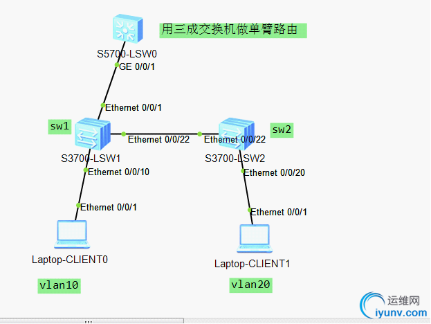

  华为设备上用三成交换机实现vlan间的通信
  1.三成交换机上的所有配置
  r]int e0/1
  [r-Ethernet0/1]port link-type trunk
  [r-Ethernet0/1]port trunk permit vlan all(允许所有的vlan通过,因为华为默认vlan不通过)
  Please wait........................................... Done!
  [r-Ethernet0/1]vlan 10(创建vlan)
  [r-vlan10]vlan 20
  [r]int Vlan-interface 10(进入vlan的子接口设地址)
  [r-Vlan-interface10]ip add 192.168.10.254 255.255.255.0
  [r-Vlan-interface10]int Vlan-interface 20
  [r-Vlan-interface20]ip add 192.168.20.254 255.255.255.0
  [r-Vlan-interface20]dis ip rou
  Routing Table: public net
  Destination/Mask   Protocol Pre  Cost        Nexthop         Interface
  127.0.0.0/8        DIRECT   0    0           127.0.0.1       InLoopBack0
  127.0.0.1/32       DIRECT   0    0           127.0.0.1       InLoopBack0
  192.168.10.0/24    DIRECT   0    0           192.168.10.254  Vlan-interface10
  192.168.10.254/32  DIRECT   0    0           127.0.0.1       InLoopBack0
  192.168.20.0/24    DIRECT   0    0           192.168.20.254  Vlan-interface20
  192.168.20.254/32  DIRECT   0    0           127.0.0.1       InLoopBack0
  2.交换机1上的配置
  SW1]int e1/0/2
  [SW1-Ethernet1/0/2]port link-type trunk
  [SW1-Ethernet1/0/2]port trunk permit vlan all
  Please wait........................................... Done.
  [SW1-Ethernet1/0/2]int e1/0/24
  [SW1-Ethernet1/0/24]port link-type trunk
  [SW1-Ethernet1/0/24]port trunk permit vlan all
  [SW1-Ethernet1/0/10]q
  [SW1]vlan 10(创建vlan)
  [SW1-vlan10]port e1/0/10(把此端口加入vlan)
  [SW1-vlan10]vlan 20
  [SW1-vlan20]port e1/0/20
  3.交换机2上的配置
  [Quidway]int e0/24
  [Quidway-Ethernet0/24]port link-type trunk
  [Quidway-Ethernet0/24]port trunk permit vlan all
  [Quidway-Ethernet0/24]vlan 10
  [Quidway-vlan10]port e0/10
  [Quidway-vlan10]vlan 20
  [Quidway-vlan20]port e0/20

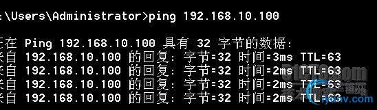

  所有的配置命令已经完成,vlan的pc机用两个真机做实验,一个配置成vlan10网段的,网关必须指向10.254.另一个配置成vlan20网段的,网关指向20.254。两台机器互相ping必须ping通才说明实现不同vlan的通信。
