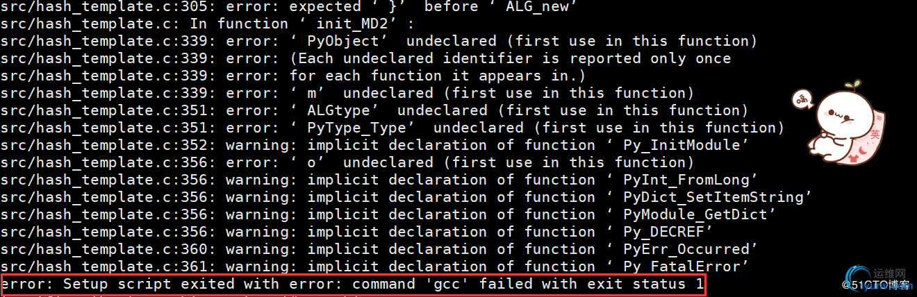

出错2:安装 pycrypto的时候会报错
  安装Python的时候必须要安装python-devel否则在安装 pycrypto的时候会报错,报错如下图所示:
(error: Setup script exited with error: command 'gcc' failed with exit status 1)

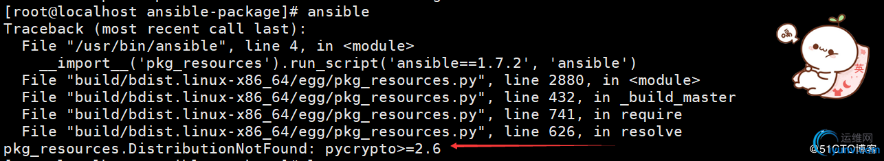

  运行Ansible会报如下错误:
pkg_resources.DistributionNotFound: pycrypto>=2.6
  解决:把Python的依赖包python-devel-2.6.6-66.el6_8.x86_64安装上去即可
# yum install python-devel
