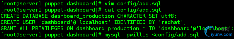

  3)配置 mysql 数据库
  # /etc/init.d/mysqld start
  # mysql_secure_installation设置root密码为willis
  # cd /usr/share/puppet-dashboard/
  # vim config/database.yml//只留下生产环境配置

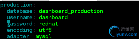

  #vim config/add.sql
  CREATE DATABASE dashboard_production CHARACTER SET utf8;
  CREATE USER 'dashboard'@'localhost'>  GRANT ALL PRIVILEGES ON dashboard_production.* TO 'dashboard'@'localhost';
  # rake RAILS_ENV=production db:migrate
  //建立 dashboard 所需的数据库和表

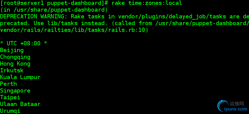

  4)修改puppet-dashboard 默认时区
  #//查看puppet-dashboard 默认支持的时区
  #rake gems:refresh_specs
  #rake time:zones:local
  # vim /usr/share/puppet-dashboard/config/settings.yml
  //puppet-dashboard 默认时区不正确,需要修改
  time_zone: 'Beijing'

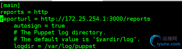

  7)修改服务器的配置文件
  # vim /etc/puppet/puppet.conf
  [main]//添加以下两项
  reports = http
  reporturl = http://172.25.254.1:3000/reports
  #/etc/init.d/puppetmaster restart

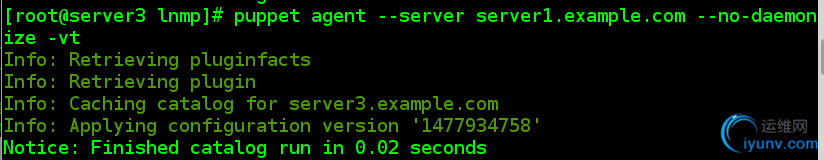

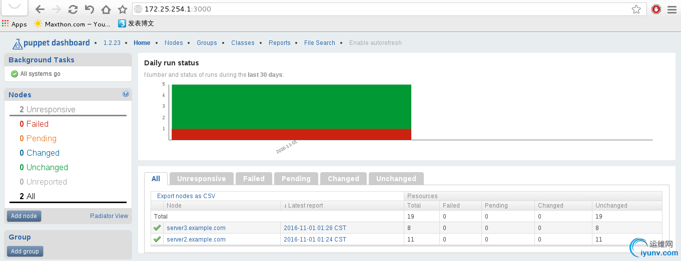

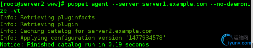

  # puppet agent --server server1.example.com --no-daemonize -vt//同步数据
  9) 浏览器访问 172.25.254.1:3000

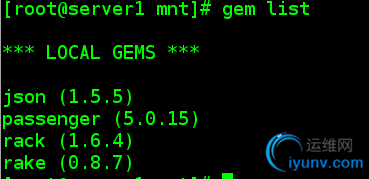

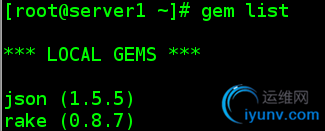

  1)[root@server1 mnt]# gem list
  *** LOCAL GEMS ***
  json (1.5.5)
  rack (1.6.4)

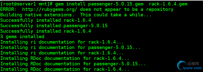

  2)不够就下载
  # gem install passenger-5.0.15.gem rack-1.6.4.gem

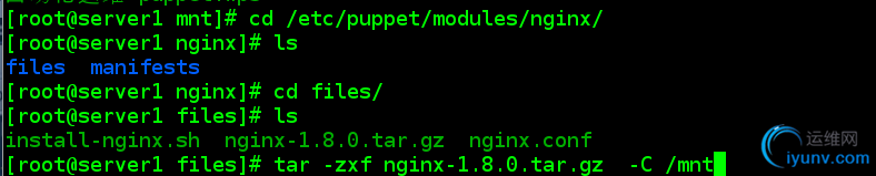

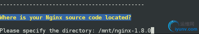

  # tar zxf nginx-1.8.0.tar.gz -C /mnt

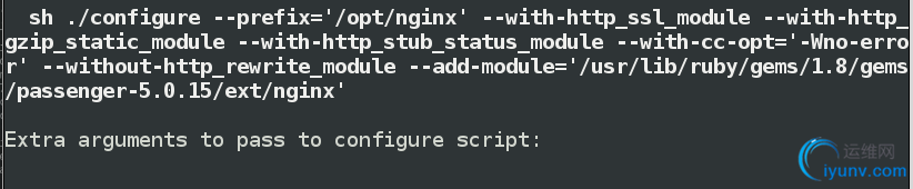

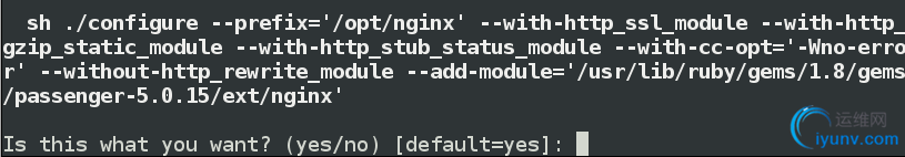

  4) #passenger-install-nginx-module

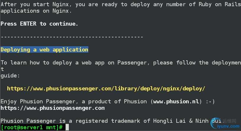

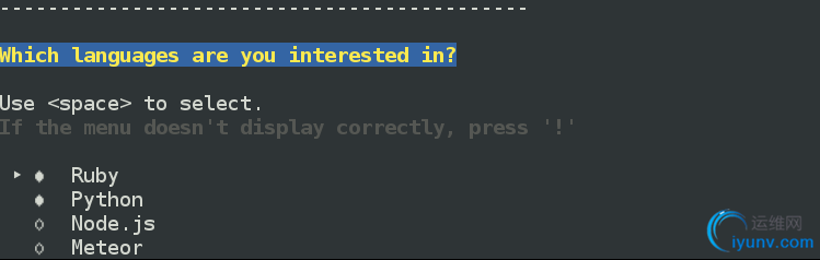

  //脚本会自动安装 nginx 支持,按提示操作,其它按Enter就好,编译过程比较慢

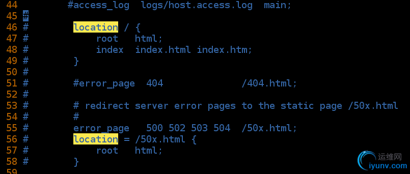

  5) nginx 默认安装在/opt/nginx 目录:
  # cd /opt/nginx/conf/
  # /etc/init.d/puppetmaster stop

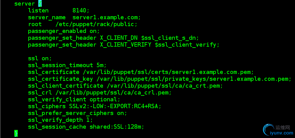

  # vim nginx.conf
  server {
  listen       8140;
  server_name  server1.example.com;
  root    /etc/puppet/rack/public;
  passenger_enabled on;
  passenger_set_header X_CLIENT_DN $ssl_client_s_dn;
  passenger_set_header X_CLIENT_VERIFY $ssl_client_verify;
  ssl on;
  ssl_session_timeout 5m;
  ssl_certificate /var/lib/puppet/ssl/certs/server1.example.com.pem;
  ssl_certificate_key /var/lib/puppet/ssl/private_keys/server1.example.com.pem;
  ssl_client_certificate /var/lib/puppet/ssl/ca/ca_crt.pem;
  ssl_crl /var/lib/puppet/ssl/ca/ca_crl.pem;
  ssl_verify_client optional;
  ssl_ciphers SSLv2:-LOW:-EXPORT:RC4+RSA;
  ssl_prefer_server_ciphers on;
  ssl_verify_depth 1;
  ssl_session_cache shared:SSL:128m;
  # /opt/nginx/sbin/nginx -t //检测 nginx配置文件是否有错

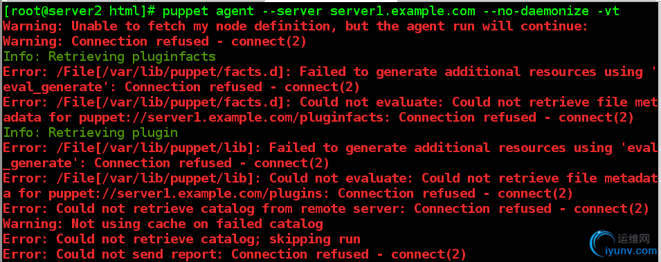

  # /opt/nginx/sbin/nginx stop   #关闭nginx让客户端获取信息,可以看到获取不到信息

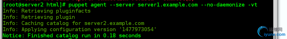

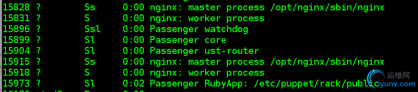

  # /opt/nginx/sbin/nginx   ###开启nginx,可以看到客户端可以获取到信息
  #ps -ax   ###查看进程启动情况
