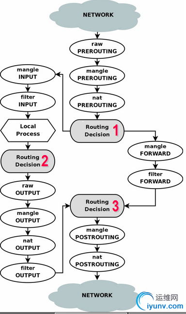

  I was quite confused by how a packet is processed by Table and Chain. The two flows below make me clear:
  A simple flow:
  Note:
  • The chains here mean chains in different tables, for example:
    When the external packets come, firstly they are processed by PREROUTING chain. Multiple tables have PREROUTING chain,
    so PREROUTING in the flow means raw table’s PREROUTING -> mangle table’s PREROUTING -> nat table’s PREROUTING (Refer to the first flow)

  Let’s look into details:
  When ICMP request comes into Computer node through the physical Ethernet interface em1, the host OS decides to go through the FORWARD chain.
  Here are the rules for FORWARD chain:
-A FORWARD -j neutron-filter-top
-A FORWARD -j neutron-openvswi-FORWARD
-A FORWARD -d 192.168.122.0/24 -o virbr0 -m conntrack --ctstate RELATED,ESTABLISHED -j ACCEPT
-A FORWARD -s 192.168.122.0/24 -i virbr0 -j ACCEPT
-A FORWARD -i virbr0 -o virbr0 -j ACCEPT
-A FORWARD -o virbr0 -j REJECT --reject-with icmp-port-unreachable
-A FORWARD -i virbr0 -j REJECT --reject-with icmp-port-unreachable
  Since iptables rules are in order, I will go through one by one.
