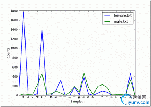

It is well known that names ending in the letter a are almost always female(我不知道…). We can see this and some other patterns in the graph in Figure 2-7, produced by the following code. Remember that name[-1] is the last letter of name.
>>> cfd = nltk.ConditionalFreqDist(
... (fileid, name[-1])
... for fileid in names.fileids()
... for name in names.words(fileid))
>>> cfd.plot()
Figure 2-7. Conditional frequency distribution: This plot shows the number of female and male names ending with each letter of the alphabet; most names ending with a, e, or i are female; names ending in h and l are equally likely to be male or female; names ending in k, o, r, s, and t are likely to be male.
