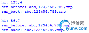

  参考代码3-1
import re
sen = "abc,123,456,789,mnp"
p = re.compile("\d+,\d+?")
for com in p.finditer(sen):
mm = com.group()
print "hi:", mm
print "sen_before:", sen
sen = sen.replace(mm, mm.replace(",", ""))
print "sen_back:", sen, '\n'
  结果
  技巧
  使用函数finditer(string[, pos[, endpos]]) | re.finditer(pattern, string[, flags]):
