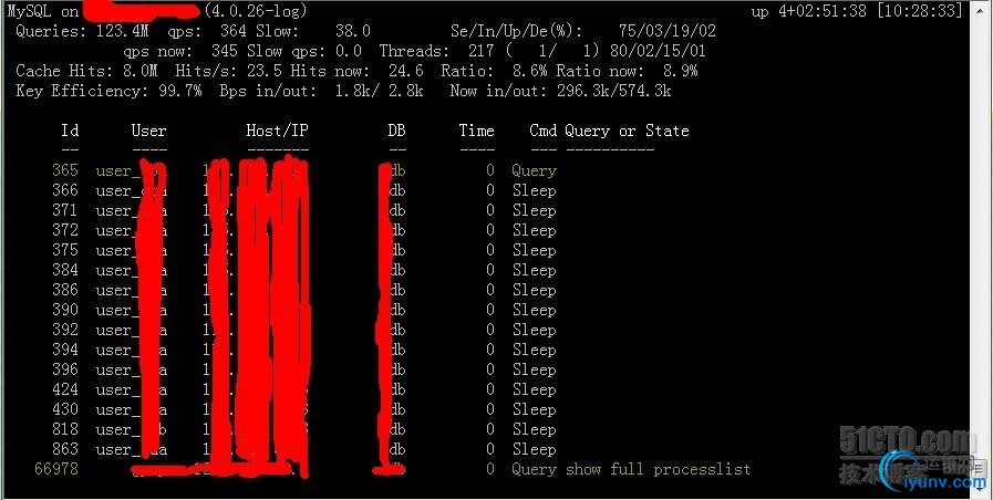

  [root@tech mytop-1.6]# mytop
  MySQL on 127.0.0.1 (4.0.26)                                                                                                                             up 10+22:18:53 [14
  :52:13]
  Queries: 81.6k  qps:    0 Slow:   810.0         Se/In/Up/De(%):    23/36/40/01
  Cache Hits: 6.8k  Hits/s:  0.0 Hits now:   0.0  Ratio: 35.8% Ratio now:  0.0%
  Key Efficiency: 100.0%  Bps in/out:  73.3/ 2.6k
  156      root       localhost        cacti         0  Query show full processlist

  注:2012年06月18号增加安装效果图,如下
