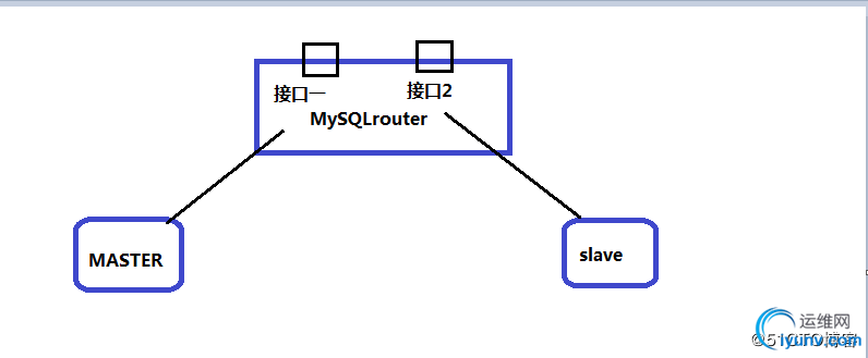

      mysqlrouter
      原理
      通过调用俩个不同的接口,将mysql语句分别调用
      安装:mysqlrouter,配置配置文件/etc/mysqlrouter/mysqlrouter.conf
    [routing:master]   添加俩个配置段//master 接口
    bind_address = 172.16.0.155:40001   //绑定的ip地址和端口号
    destinations = 172.16.0.156:3306   //后端的mysql服务
    mode = read-write            //模式(是否允许写)
    connect_time = 3        //连接时间
    [routing:slave]
    bind_address = 172.16.0.155:40002
    destinations = 172.16.0.155:3306
    mode = read-only
    connect_time = 1
