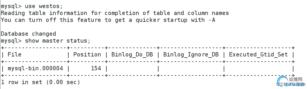

  master上进行授权
  mysql> grant replication slave on *.* to cara@'192.168.122.13'>
  mysql> flush privileges;  刷新
  master授权后,slave可以远程登录
  master端查看
