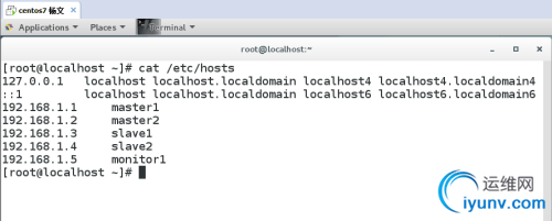

  2、在所有主机上配置/etc/hosts文件,添加如下内容:
  192.168.1.1 master1
  192.168.1.2 master2
  192.168.1.3 slave1
  192.168.1.4 slave2
  192.168.1.5 monitor

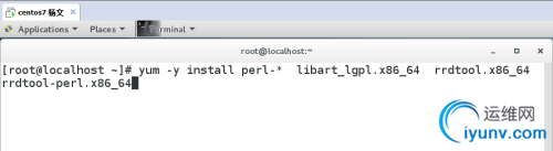

  在所有主机上安装perl、perl-develperl-CPAN libart_lgpl.x86_64 rrdtool.x86_64  rrdtool-perl.x86_64包
  #yum -y install perl-*  libart_lgpl.x86_64 rrdtool.x86_64  rrdtool-perl.x86_64
  注:使用centos7在线yum源安装

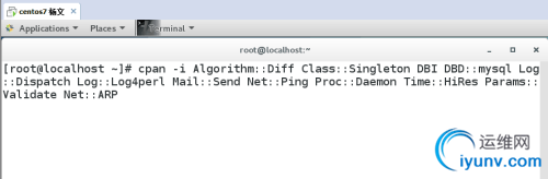

  安装perl的相关库
  #cpan -i Algorithm::Diff>

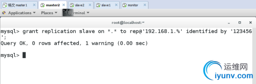

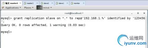

  主从配置(master1和master2配置成主主,slave1和slave2配置成master1的从):
  在master1上授权:
  mysql> grant replication slave on *.* to rep@'192.168.31.%'>
  在master2上授权:

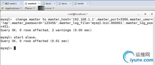

  把master2、slave1和slave2配置成master1的从库:
  在master1上执行show master status; 获取binlog文件和Position点
  mysql> show master status;
  | File             | Position | Binlog_Do_DB | Binlog_Ignore_DB | Executed_Gtid_Set |
  | mysql-bin.000001 |      451 |              |          |                   |
  在master2、slave1和slave2执行
  mysql> change master to master_host='192.168.31.83',master_port=3306,master_user='rep',master_password='123456',master_log_file='mysql-bin.000001',master_log_pos=452;
  mysql>start slave;

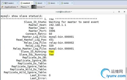

  验证主从复制:
  master2主机:
  mysql> show slave status\G;
  *************************** 1. row ***************************
  Slave_IO_State: Waiting for master to send event
  Master_Host: 192.168.1.1
  Master_User: rep
  Master_Port: 3306
  Connect_Retry: 60
  Master_Log_File: mysql-bin.000001
  Read_Master_Log_Pos: 452
  Relay_Log_File:>  Relay_Log_Pos: 320
  Relay_Master_Log_File: mysql-bin.000001
  Slave_IO_Running: Yes
  Slave_SQL_Running: Yes

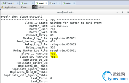

  slave1主机:
  Master_User: rep
  Master_Port: 3306
  Connect_Retry: 60

  如果Slave_IO_Running和Slave_SQL_Running都为yes,那么主从就已经配置OK了

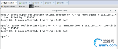

  在4台mysql节点上创建用户
  创建代理账号:
  mysql> grant super,replicationclient,process on *.* to 'mmm_agent'@'192.168.31.%'>  创建监控账号:
  mysql> grant replication client on *.* to 'mmm_monitor'@'192.168.31.%'>

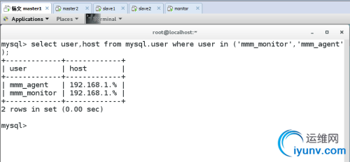

  检查master2和slave1、slave2三台db上是否都存在监控和代理账号
  mysql> select user,host from mysql.user where user in ('mmm_monitor','mmm_agent');
  | user        | host         |
  | mmm_agent   | 192.168.31.% |
  | mmm_monitor | 192.168.31.% |
  或

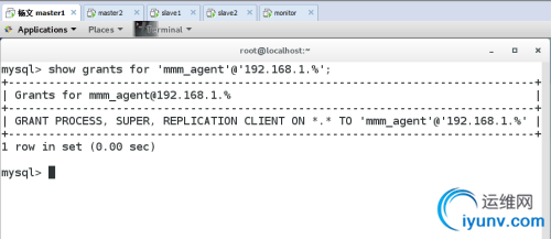

  mysql> show grants for 'mmm_agent'@'192.168.31.%';
  | Grants for mmm_agent@192.168.31.%                                             |
  | GRANT PROCESS, SUPER, REPLICATION CLIENT ON *.* TO 'mmm_agent'@'192.168.31.%' |
  mysql> show grants for 'mmm_monitor'@'192.168.31.%';
  | Grants for mmm_monitor@192.168.31.%                             |
  | GRANT REPLICATION CLIENT ON *.* TO 'mmm_monitor'@'192.168.31.%' |

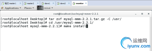

  5、mysql-mmm安装
  在monitor主机(192.168.31.106) 上安装监控程序
  cd /tmp
  wget http://pkgs.fedoraproject.org/repo/pkgs/mysql-mmm/mysql-mmm-2.2.1.tar.gz/f5f8b48bdf89251d3183328f0249461e/mysql-mmm-2.2.1.tar.gz
  在数据库服务器(master1、master2、slave1、slave2)上安装代理

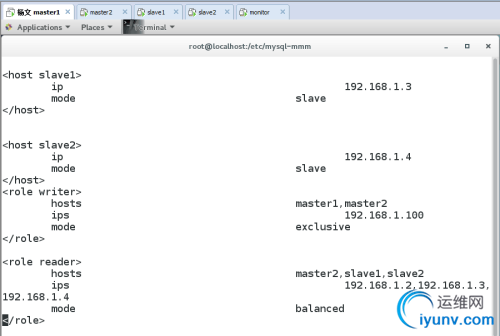

  #writer角色配置
  hosts      master1,master2#能进行写操作的服务器的host名,如果不想切换写操作这里可以只配置master,这样也可以避免因为网络延时而进行write的切换,但是一旦master出现故障那么当前的MMM就没有writer了只有对外的read操作。
  ips    192.168.1.100#对外提供的写操作的虚拟IP
  mode   exclusive#exclusive代表只允许存在一个主,也就是只能提供一个写的IP
  #read角色配置
  hosts   master2,slave1,slave2#对外提供读操作的服务器的host名,当然这里也可以把master加进来192.168.1.2 192.168.1.3 192.168.1.4
  ips      #对外提供读操作的虚拟ip,这三个ip和host不是一一对应的,并且ips也hosts的数目也可以不相同,如果这样配置的话其中一个hosts会分配两个ip
  mode      balanced#balanced代表负载均衡

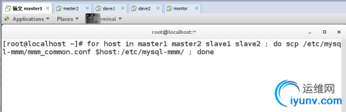

  同时将这个文件拷贝到其它的服务器,配置不变
  #for host in master1 master2 slave1 slave2 ; do scp /etc/mysql-mmm/mmm_common.conf $host:/etc/mysql-mmm/ ; done

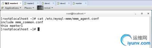

  编辑 4台mysql节点机上的/etc/mysql-mmm/mmm_agent.conf
  在数据库服务器上,还有一个mmm_agent.conf需要修改,其内容是:
  includemmm_common.conf
  this master1
  注意:这个配置只配置db服务器,监控服务器不需要配置,this后面的host名改成当前服务器的主机名。

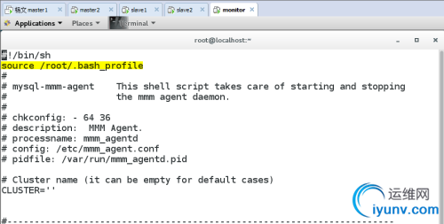

  在 /etc/init.d/mysql-mmm-agent的脚本文件的#!/bin/sh下面,加入如下内容
  source /root/.bash_profile
  添加成系统服务并设置为自启动
  #chkconfig --add mysql-mmm-agent
  #chkconfigmysql-mmm-agent on
  #/etc/init.d/mysql-mmm-agent start
  注:添加source /root/.bash_profile目的是为了mysql-mmm-agent服务能启机自启。

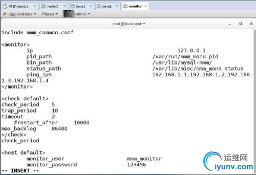

  编辑 monitor主机上的/etc/mysql-mmm/mmm_mon.conf
  ip    127.0.0.1##为了安全性,设置只在本机监听,mmm_mond默认监听9988
  pid_path      /var/run/mmm_mond.pid
  bin_path      /usr/lib/mysql-mmm/
  status_path/var/lib/misc/mmm_mond.status
  ping_ips192.168.31.83,192.168.31.141,192.168.31.250,192.168.31.225#用于测试网络可用性 IP 地址列表,只要其中有一个地址 ping 通,就代表网络正常,这里不要写入本机地址
  auto_set_online  0#设置自动online的时间,默认是超过60s就将它设置为online,默认是60s,这里将其设为0就是立即online
  check_period    5
  trap_period     10
  timeout         2
  #restart_after     10000
  max_backlog     86400
  check_period
  描述:检查周期默认为5s
  默认值:5s
  trap_period
  描述:一个节点被检测不成功的时间持续trap_period秒,就慎重的认为这个节点失败了。
  默认值:10s
  timeout
  描述:检查超时的时间
  默认值:2s
  restart_after
  描述:在完成restart_after次检查后,重启checker进程
  默认值:10000
  max_backlog
  描述:记录检查rep_backlog日志的最大次数
  默认值:60
  monitor_usermmm_monitor#监控db服务器的用户
  monitor_password  123456#监控db服务器的密码
  debug 0#debug 0正常模式,1为debug模式

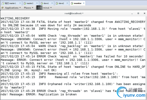

  启动监控进程:
  添加成系统服务并设置为自启动
  #chkconfig --add mysql-mmm-monitor
  #chkconfigmysql-mmm-monitor on
  #/etc/init.d/mysql-mmm-monitor start
  启动报错:
  Starting MMM Monitor daemon: Can not locate Proc/Daemon.pm in @INC (@INC contains: /usr/local/lib64/perl5 /usr/local/share/perl5 /usr/lib64/perl5/vendor_perl /usr/share/perl5/vendor_perl /usr/lib64/perl5/usr/share/perl5 .) at /usr/sbin/mmm_mond line 11.
  BEGIN failed--compilation aborted at /usr/sbin/mmm_mond line 11.
  failed
  解决方法:安装下列perl的库
  #cpanProc::Daemon
  #cpan Log::Log4perl
  [root@monitor1 ~]# /etc/init.d/mysql-mmm-monitor start

  在master2,slave1,slave2主机上查看主mysql的指向
  Master_User: rep
  Master_Port: 3306
  Connect_Retry: 60

  模拟master1宕机,手动停止mysql服务,观察monitor日志,master1的日志如下:
  [root@monitor1 ~]# tail -f /var/log/mysql-mmm/mmm_mond.log
  2017/02/23 22:02:55  WARN Check 'rep_threads' on 'master1' is in unknown state! Message: UNKNOWN: Connect error (host = 192.168.31.83:3306, user = mmm_monitor)! Can't connect to MySQL server on '192.168.1.1'(111)
  2017/01/09 22:02:55  WARN Check 'rep_backlog' on 'master1' is in unknown state! Message: UNKNOWN: Connect error (host = 192.168.1.1:3306, user = mmm_monitor)! Can't connect to MySQL server on '192.168.1.1'(111)
  2017/01/09 22:03:05 ERROR Check 'mysql' on 'master1' has failed for 10 seconds! Message: ERROR: Connect error (host = 192.168.1.1:3306, user = mmm_monitor)! Can't connect to MySQL server on '192.168.31.83'(111)
  2017/01/09 22:03:07 FATAL State of host 'master1' changed from ONLINE to HARD_OFFLINE (ping: OK, mysql: not OK)
  2017/01/09 22:03:07  INFO Removing all roles from host 'master1':
  2017/01/09 22:03:07  INFO     Removed role 'writer(192.168.1.100)' from host 'master1'
  2017/01/09 22:03:07  INFO Orphaned role 'writer(192.168.1.100)' has been assigned to 'master2'

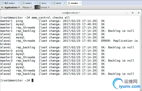

  [root@monitor1 ~]# mmm_control checks all
  master1  ping         [last change: 2017/01/09 21:31:47]  OK
  master1  mysql        [last change: 2017/01/09 22:03:07]  ERROR: Connect error (host = 192.168.31.83:3306, user = mmm_monitor)! Can't connect to MySQL server on '192.168.31.83' (111)
  master1  rep_threads  [last change: 2017/01/09 21:31:47]  OK
  master1  rep_backlog  [last change: 2017/01/09 21:31:47]  OK: Backlog is null
  slave1   ping         [last change: 2017/01/09 21:31:47]  OK
  slave1mysql        [last change: 2017/01/09 21:31:47]  OK
  slave1   rep_threads  [last change: 2017/01/09 21:31:47]  OK
  slave1   rep_backlog  [last change: 2017/01/09 21:31:47]  OK: Backlog is null
  master2  ping         [last change: 2017/01/09 21:31:47]  OK
  master2  mysql        [last change: 2017/01/09 21:57:32]  OK
  master2  rep_threads  [last change: 2017/01/09 21:31:47]  OK
  master2  rep_backlog  [last change: 2017/01/09 21:31:47]  OK: Backlog is null
  slave2   ping         [last change: 2017/01/09 21:31:47]  OK
  slave2mysql        [last change: 2017/01/09 21:31:47]  OK
  slave2   rep_threads  [last change: 2017/01/09 21:31:47]  OK
  slave2   rep_backlog  [last change: 2017/01/09 21:31:47]  OK: Backlog is null

  writer切换,要确保mmm_common.conf文件中的writer属性有配置对应的host,否则无法切换

  4、其它处理问题
  如果不想让writer从master切换到backup(包括主从的延时也会导致写VIP的切换),那么可以在配置/etc/mysql-mmm/mmm_common.conf时,去掉中的backup
  #writer角色配置
  hosts master1 #这里只配置一个Hosts
  mode exclusive #exclusive代表只允许存在一个主,也就是只能提供一个写的IP
  这样的话当master1出现故障了writer写操作不会切换到master2服务器,并且slave也不会指向新的master,此时当前的MMM之前对外提供写服务。
