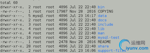

  [root@server1 mysql-5.7.17]# cd /usr/local/lnmp/mysql/
  [root@server1 mysql]# chown mysql.mysql . -R
  [root@server1 mysql]# cd support-files/
  [root@server1 support-files]# ls
  magic  my-default.cnf  mysqld_multi.server  mysql-log-rotate  mysql.server

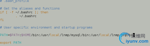

  [root@server1 etc]# vim ~/.bash_profile
  [root@server1 etc]# source ~/.bash_profile

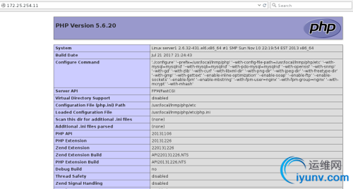

  [root@server1 html]# vim index.php
  [root@server1 html]# /etc/init.d/iptables stop
  测试:

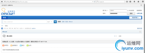

  5..论坛
  [root@server1 ~]# unzip Discuz_X3.2_SC_UTF8.zip
  [root@server1 ~]# mv upload/ /usr/local/lnmp/nginx/html/bbs
  [root@server1 ~]# cd /usr/local/lnmp/nginx/html/bbs
  [root@server1 bbs]# chmod 777 config/ data/ uc_client/ uc_server/ -R
  [root@server1 local]# cd /usr/local/lnmp/php/etc/
  [root@server1 etc]# vim php.ini
  [root@server1 etc]# chmod 755 /usr/local/lnmp/mysql/data/
  [root@server1 etc]# /etc/init.d/php-fpm reload
  测试:

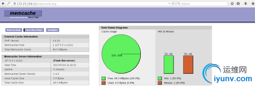

  6.Memcache
  [root@server1 ~]# tar zxf memcache-2.2.5.tgz
  [root@server1 ~]# cd memcache-2.2.5
  [root@server1 memcache-2.2.5]# phpize
  Configuring for:
  PHP Api Version:         20131106
  Zend Module Api No:      20131226
  Zend Extension Api No:   220131226
  [root@server1 memcache-2.2.5]# ./configure
  [root@server1 memcache-2.2.5]# make && make install
  [root@server1 no-debug-non-zts-20131226]# which php
  /usr/local/lnmp/php/bin/php
  [root@server1 etc]# cd /usr/local/lnmp/php/etc/
  [root@server1 etc]# rpm -e `rpm -qa|grep php`
  Reload service php-fpm  done
  [root@server1 etc]# php -m |grep memcache
  memcache
  [root@server1 memcache-2.2.5]# yum install -y memcached
  [root@server1 memcache-2.2.5]# /etc/init.d/memcached start
  Starting memcached:                                        [  OK  ]

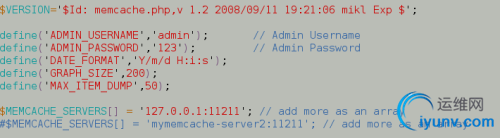

  [root@server1 memcache-2.2.5]# cp example.php memcache.php  /usr/local/lnmp/nginx/html/
  [root@server1 memcache-2.2.5]# cd /usr/local/lnmp/nginx/html/
  [root@server1 html]# ls
  50x.html  bbs  example.php  index.html  index.php  memcache.php
  [root@server1 html]# vim memcache.php
  [root@server1 html]# /etc/init.d/memcached reload
  Stopping memcached:                                        [  OK  ]
  测试:

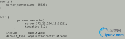

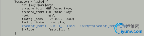

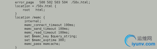

  7.openresty   ##openresty是一个基于nginx的可伸缩web平台,使用lua并编写脚本,然后部署到ngnix web容器中运行,从而能更轻松开发出高性能的web服务
  tar zxf openresty-1.11.2.3.tar.gz
  cd openresty-1.11.2.3
  ./configure
  Gmake && gmake install
  cd /usr/local/openresty/nginx/conf/
  vim nginx.conf

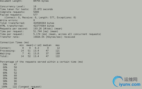

  [root@server1 conf]# netstat -antlp | grep :11211
  nginx -s reload
  测试:
  [kiosk@foundation1 ~]$ ab -c10 -n  5000 http://172.25.254.11/index.php
