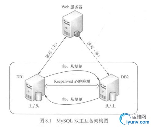

  mysql双主互备架构图
  mysql主主互备模式配置

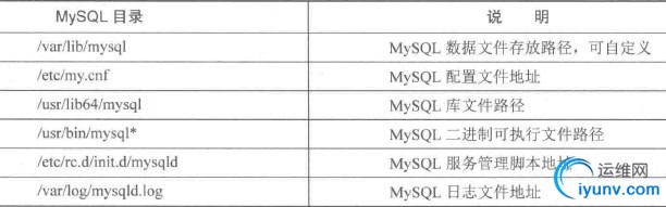

  安装完成后目录结构如下:

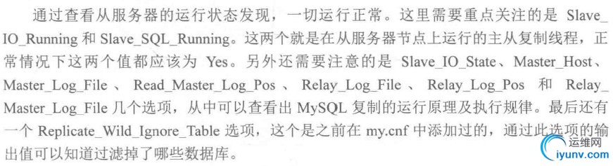

  DB2上启动从服务器,并查看DB2上的从服务器运行状态
  mysql> start slave;
  mysql> show slave status\G;
  *************************** 1. row ***************************
  Slave_IO_State: Waiting for master to send event
  Master_Host: 10.24.24.111
  Master_User: repl_user
  Master_Port: 3306
  Connect_Retry: 60
  Master_Log_File: mysql-bin.000002
  Read_Master_Log_Pos: 271
  Relay_Log_File: mysql-relay-bin.000002
  >  Slave_IO_Running: Yes
  Slave_SQL_Running: Yes
  Replicate_Do_DB:
  Replicate_Ignore_DB:
  Replicate_Do_Table:
  Replicate_Ignore_Table:
  Replicate_Wild_Do_Table:
  Replicate_Wild_Ignore_Table: mysql.%,test.%,information_schema.%
  Last_Errno: 0
  Last_Error:
  Skip_Counter: 0
  Exec_Master_Log_Pos: 271
  >  Until_Condition: None
  Until_Log_File:
  Until_Log_Pos: 0
  Master_SSL_Allowed: No
  Master_SSL_CA_File:
  Master_SSL_CA_Path:
  Master_SSL_Cert:
  Master_SSL_Cipher:
  Master_SSL_Key:
  Seconds_Behind_Master: 0
  Master_SSL_Verify_Server_Cert: No
  Last_IO_Errno: 0
  Last_IO_Error:
  Last_SQL_Errno: 0
  Last_SQL_Error:
  1 row in set (0.00 sec)
  ERROR:
  No query specified
  至此,DB1到DB2的MYSQL主从复制已完成。

  Slave_IO_Running和Slave_SQL_Running都处于YES状态。表明DB1上复制服务运行正常,mysql双主模式主从复制配置完毕。
