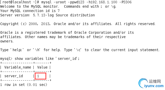

  测试高可用:关掉DB1的mysql时.他的vip会飘到DB2
  测试mysql主从同步功能
  1.在远程客户端通过vip登录测试

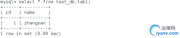

  2.数据复制功能测试
  在DB1中创建了一个数据库。在DB2查看是否有这个数据库

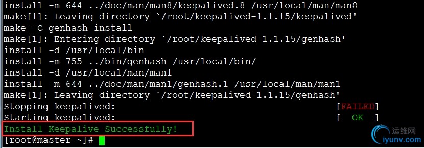

  一、在主mysql上安装配置keepalive
  [root@master ~]# bash keepalive_install.sh
  “脚本”内容如下:
  [root@master ~]# cat keepalive_install.sh
  #!/bin/bash
  yum -y  install kernel-devel openssl-devel  popt-devel &&
  wget http://www.keepalived.org/software/keepalived-1.1.15.tar.gz &&
  tar -zxf keepalived-1.1.15.tar.gz &&
  cd keepalived-1.1.15 &&
  ./configure--with-kernel-dir=/usr/src/kernels/2.6.32-431.el6.x86_64/ &&
  make && make install &&
  DIR=/usr/local/
  cp $DIR/etc/rc.d/init.d/keepalived  /etc/rc.d/init.d/  &&
  cp $DIR/etc/sysconfig/keepalived /etc/sysconfig/&& mkdir -p /etc/keepalived &&
  cp $DIR/sbin/keepalived/usr/sbin/&&
  cp/usr/local/etc/keepalived/keepalived.conf /etc/keepalived/ &&
  /etc/init.d/keepalived restart
  if [ $? -eq 0 ];then
  echo -e '\e[32mInstall Keepalive Successfully!\e[0m'
  else
  echo -e '\e[31mInstall Keepalive Failure!\e[0m'
  fi

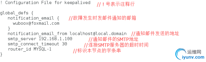

  [root@master ~]# cat/etc/keepalived/keepalived.conf
  ! Configuration File for keepalived
  global_defs {
  notification_email {
  654001593@qq.com
  notification_email_from root@localhost.com
  smtp_server 127.0.0.1
  smtp_connect_timeout 30
  router_id LVS_DEVEL

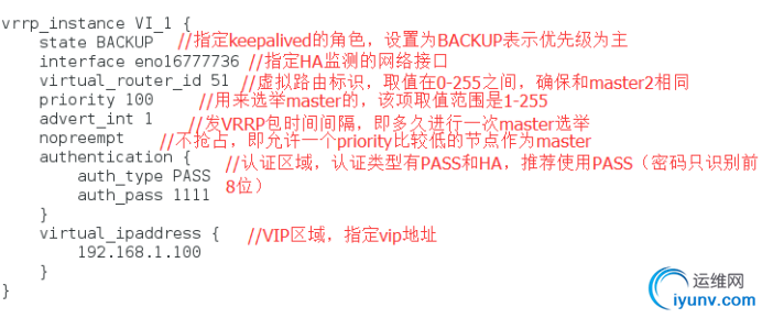

  vrrp_instance VI_1 {
  state MASTER
  interface eth0
  virtual_router_id 51
  priority 100
  advert_int 1
  authentication {
  auth_type PASS
  auth_pass 1111
  virtual_ipaddress {
  192.168.1.77

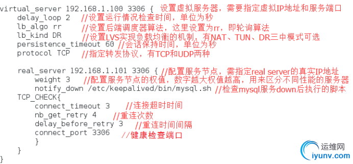

  virtual_server 192.168.1.77 3306 {
  delay_loop 6
  lb_algo wrr
  lb_kind DR
  persistence_timeout 50
  protocol TCP
  real_server 192.168.1.3 3306 {
  weight 1
  notify_down/data/sh/ keepalive_stop.sh
  TCP_CHECK {
  connect_timeout 3
  nb_get_retry 3
  delay_before_retry 3
  connect_port 3306
  [root@master ~]# mkdir -p /data/sh

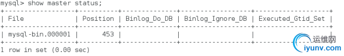

  mysql> grant replication slave on *.* to 'rep'@'192.168.1.102'>
  查看master1的当前binlog状态信息

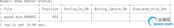

  1、在master2主机上创建授权账号,允许在master1(192.168.1.101)主机上连接
  mysql> grant replication slave on *.* to 'rep'@'192.168.1.101'>
  查看master2的当前binlog状态信息

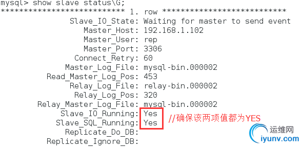

  2、在master1上将master2设为自己的主服务器并开启slave功能。
  mysql> change master to master_host='192.168.1.102',master_user='rep',master_password='123456',master_log_file='mysql-bin.000002',master_log_pos=453;

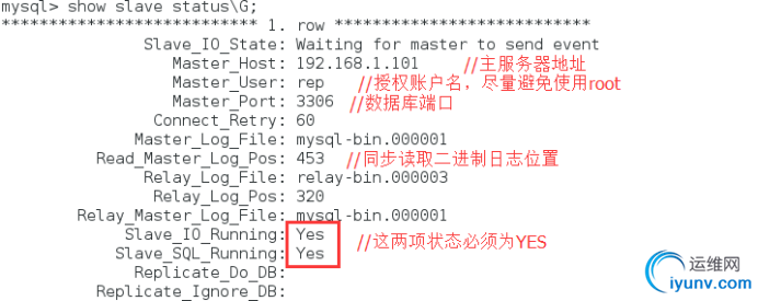

  mysql> start slave;
  查看从(master1)的状态

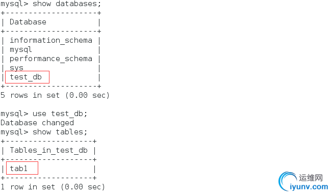

  (5)测试主主同步
  1、在master1上创建要同步的数据库如test_db,并在test_db中创建一张测试表如tab1
  mysql> create database test_db;
  mysql> use test_db;
  mysql> create table tab1(id int,name varchar(30));
  查看master2主机是否同步了master1的数据变化
  2、在master2主机上想tab1表中插入数据
  mysql> insert into test_db.tab1(id,name) values (1,'zhangsan');
  mysql> commit;
  查看master1主机是否同步了master2上的数据变化

  1、在master1主机的keepalived.conf文件的修改:
  [root@master1 ~]# vim /etc/keepalived/keepalived.conf
  global_defs区域
  vrrp_instance区域
  virtua_server区域
  启动keepalived服务

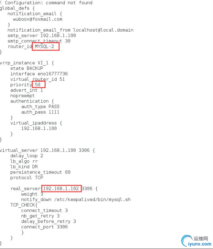

  2、在master2主机上对keepalived.conf文件进行修改
  Master2主机的keepalived.conf配置文件除了router_id、priority和real_server三处不同,其他配置项都相同。
  启动keepalived服务
  [root@master2 ~]# /etc/init.d/keepalived start

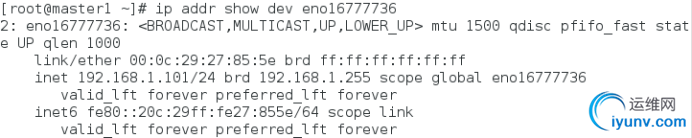

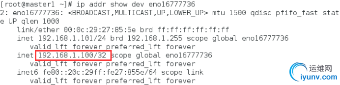

  1、在master1和master2上分别查看master1和master2对VIP(群集虚拟IP)的控制权
  在master1主上查看结结果:
  在master2主上查看结果:
  从上图可以看出master1是主服务器,master2为备用服务器

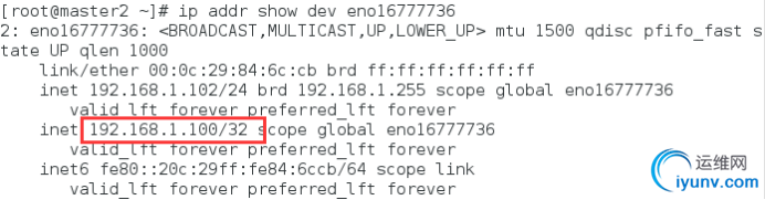

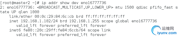

  2、测试停止MySQL服务,keepalived健康检查是否会触发脚本
  停止master1主机的MySQL服务
  [root@master1 ~]# systemctl stop mysqld
  查看master1主结果:
  Master2主的查看结果:
  这说明在主服务上停止MySQL服务,触发了我们编写的脚本,进行自动故障切换。
  3、MySQL远程登入测试
  为MySQL服务器授权允许远程登入(两台主服务器都要授权
  mysql> grant all on *.* to root@'%'>  在客户端上测试登入
  上图说明客户端访问的VIP地址是由master1主机提供响应的,应为master1当前是主服务器,
